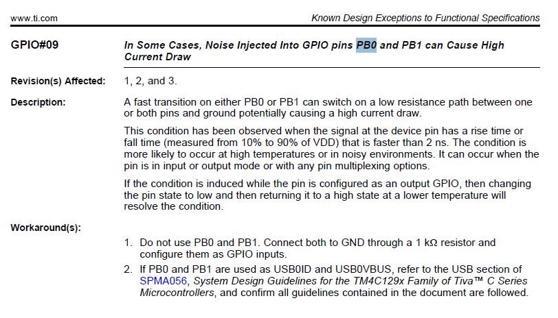

My customer has a major concern regarding the TM4C129.
There were previous issues with the CAN operation, which we concluded  was due to PCB contamination during PCB assembly. We have not seen this failure on a sample of the cleaner PCBs.
However, reading through the TI errata for the uP and found the following;
Our design has the CAN RX and TX on PB0 & PB1
we are now concerned
1/ that the PCBA cleanliness issue masked an underlying problem which could occur again in the future?
2/ The Ti solution implies that the fix is to not use the PB0 or PB1 pins, unless they are for USB and follow the design guides.
Would you be able to comment if PB0 or PB1 can be used for CAN? The errata implies it cannot if the rise times are fast. please help clarify???

  • Hello Linda,
    As Robert mentioned, CAN bus signals won't reach a range where that errata would come into play when operating under normal conditions. To prevent any issues with noise or other possible signals, using an RC filter to keep the slew rate above 2ns would be a safe design choice.

    From the '123 Errata April 2016 said:
    GPIO#10 In Some Cases, Noise Injected Into GPIO Pins can Cause High Current Draw
    Revision(s) Affected: 6 and 7.
    Description: A fast transition on any GPIO pin can switch on a low resistance path between the GPIO
    pin or the adjacent GPIO pins and ground potentially causing a high current draw.
    This condition has been observed when the signal at the device pin has a slew rate such
    that the rise time or fall time (measured from 10% to 90% of VDD) is faster than 2ns.
    The condition is more likely to occur at high temperatures or in noisy environments. It
    can occur when the pin is in input or output mode or with any pin multiplexing options.
    If the condition is induced while the pin is configured as an output GPIO, then changing
    the pin state to low and then returning it to a high state at a lower temperature will
    resolve the condition.
    Workaround(s): Limit the slew rate on the IO so that the fastest rise and fall time is greater than 2 ns.
    Use an RC filter or series ferrite to limit the rise and fall times at the device pin. The filter
    capacitor should be placed as close as possible to the device.
    Looks like the same Errata. We ended up applying a handful of resistors and caps to prevent the possibility of exceeding the rate of change limits.
