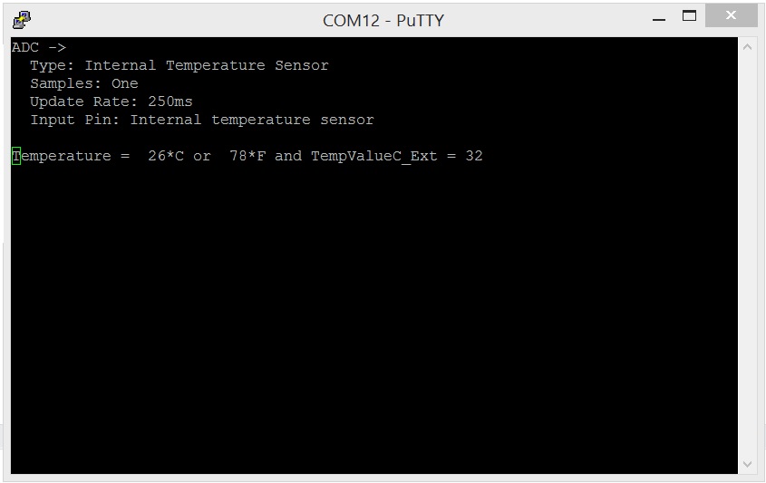

Hi, I want to read internal and external temperature sensors, and display it by using uart. I used the example provided by tivaware, and made some changes. Problem is temperature values is changes continuously. What I mean is temperature value is like 22-24-23-24-22-20-24. I thought maybe the room temperature is on the border between two values but sometimes it jumpes from 20 to 24, also the external temperature behaves same. It is my custom board, and I am using iar. I share code and a screenshot of putty terminal. What might be the problem.
Edit: When I heat the external temperature, temperature value increase simultaneously. It shows 40-42-41-44.

  • Furkan ERMAN said:
    Problem is temperature values change continuously.
    Might the issue be w/your "expectations" - and not w/those (slightly) varying results?     The internal temperature sensor is not famed for highest accuracy (it is "free" after all) - and will vary based upon voltage, device aging, nearby noise sources (especially impressed upon the power rail)  and (likely) current flow during such measurement period.
    You write of a custom board - note that your MCU has a separate VDDA and GNDA connection pair - that's done to gain best (potential) performance from the analog portion of your MCU.    Had you supplied those pins separately (from VDD and GND)  - and via enhanced, extra stable, noise-free voltages?    (that's required to gain the best analog performance from your MCU.)
    When reading a highly stable - properly input voltage via the MCU's ADC - it is "normal" for the "3 least significant ADC bits" to "flutter."   Consider that a 12 bit ADC contains 4096 "counts" - thus the "uncertainty" of 8 counts is 1/5 of 1% (40 ADC counts.)
    This vendor and others produce more accurate (and precise) stand-alone ADCs - some cost "many times more" than your MCU and are chosen when faster and more accurate analog measurements are required...
    Armed w/this knowledge - might your "problem" be "slight" - and your "expectations adjusted" to accept the MCUs "inability" to provide (endlessly) consistent analog readings...
  • Hi cb1_mobile,
    Since many time passed after your reply, I sound that this happens frequently for other vendor's mcus also. Some find software based solutions such as taking 10 samples then remove highest and lowest values and then take avarage of remaning 8 values. Does tm4c123 has in built system to do that?
    TivaWare supports either hardware or software "oversampling" by averaging multiple samples from the same analog input. Search for "oversampling" in the Analog to Digital Converter (ADC) section of the TivaWare™ Peripheral Driver Library users' guide for details.
    I can't see a description of TivaWare support to discard the highest and lowest values before performing the averages, but presumably that could be implemented in your own software.
