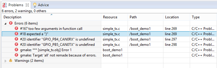

  I am trying to interface CAN in TM4C1294 development board. I have found the CAN example program from the path C:\ti\TivaWare_C_Series-2.1.3.156\examples\peripherals\can. What are the configuration in project or changes to be done in program to build this program. because by copy paste I have tried it a lot and does not get build by going though the procedure in the video Code composer for beginners.
  • Hello Azim,
    In general if you start with a bare CCS project, give it include links to TivaWare DriverLib and then import and add in the example code, you should be most of the way there to getting the project running. I haven't tried to build that particular example yet so there may be another step or two needed, I will try and help you figure that out.
    Edit: I should clarify, when I said 'import' the example code, I had meant using the copy/paste method you have done. You don't need to use an CCS "import" features!
    If are getting build errors, then please post a screen capture of them on E2E. You can do so by clicking "Use rich formatting" and then select the image attachment feature on the toolbar just above the post text box.
    Also please post your main code you are using, as I will want to see what, if any modifications you have done to it. You should do this using "Syntax Highlighter" which can be found under same Rich Formatting toolbar with the symbol "< / >".

  • THe example program code is

    and found the error as  :
  • Hello azim,
    There are two errors I have identified. The first is that a comma is missing from this API:
       ui32SysClock = SysCtlClockFreqSet((SYSCTL_XTAL_25MHZ |
                                          SYSCTL_OSC_MAIN |
                                          SYSCTL_USE_OSC)
                                          25000000);
    The correct usage is to have a comma after SYSCTL_USE_OSC) as seen here:
                                          SYSCTL_OSC_MAIN |
                                          SYSCTL_USE_OSC),
                                          25000000);
    You can find this line easily by double clicking the error for line 269.
    The second issue is what is reported on Lines 297/298 about GPIO_PB4_CAN0RX and GPIO_PB5_CAN0TX. This issue is because the TM4C1294NCPDT which you are using does not have the CAN peripheral on those specific GPIO pins. For CAN0RX and CAN0TX, you will need to use PA0 and PA1 respectively.
  • Thanks amd I could avoid those 2 errors. and still following errors are remaining.  I there any configuration in CCS to be done like adi=ding files, drivers or libraries..?
  • Hello Azim,
    It looks like you have two separate C files with two different main() routines. Please make sure you are excluding files you don't need from your project. My guess is there is a boot_demo1.c file which has a main() routine that isn't related to your attempt to get the CAN example running.
