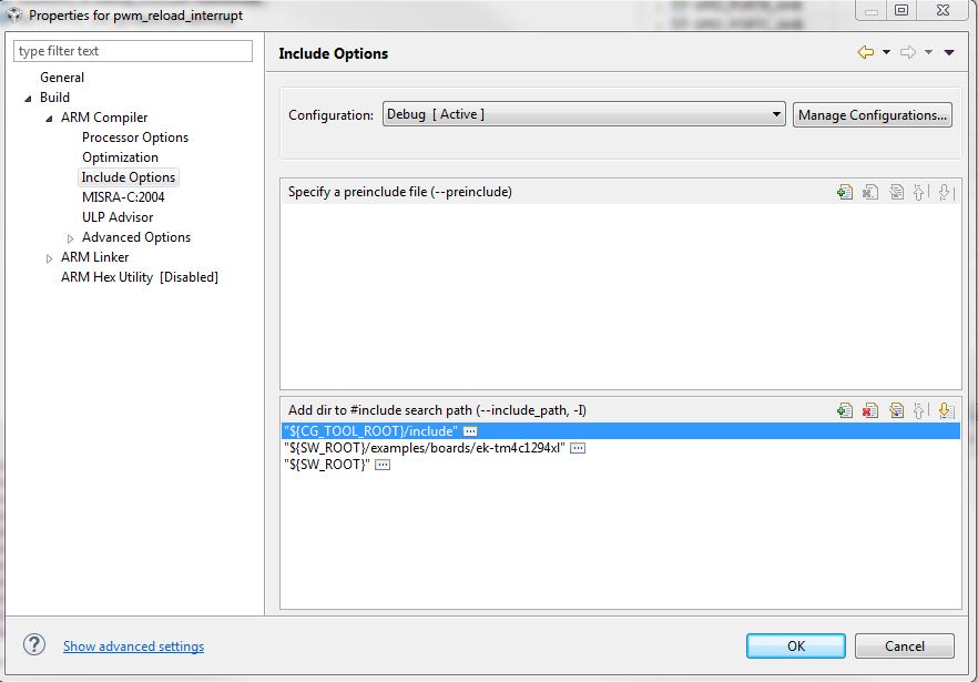

I have found a example program as follows from tivaware of PWM doesnot get build.

The following errors are found when build. What may be the problem.
  • Hi Azim,
     Can you tell me where is this example in Tivaware you found? Have you tried the PWM examples under <TivaWare_Installation>\examples\pwm?
     In order for the example you are showing to compile you need to have the include path to the drivers folder. The drivers folder is normally found as shown below under examples/boards/ek-tm4c1294xl.
  • Azim,
    Did you just copy/paste the program into a blank project?
    You should actually use the CCS Menu option Project, and then Import CCS Project. That is likely to recover all the necessary settings.
