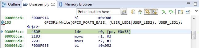

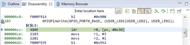

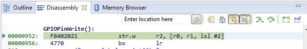

  • Hi Jame,
     I think cb1 explains very well on the different components which contribute to the 32 cycles you observe. Let me breakdown some components further.
     When a rise edge is detected it must be first latched (that is one cycle) and then go through a edge detection logic (this is one more cycle). A edge is detection logic is normally a flop followed by a AND gate with a bubble on one of the input terminal.  Once you enter the interrupt you will execute GPIOPinWrite(GPIO_PORTD_BASE, GPIO_PIN_2, GPIO_PIN_2). Now let's look at how many cycles constitute this C line code by looking the corresponding assembly instructions. Below is taken from project0 example.
    As you can see it can take about 5+ cycles to execute the GPIOPinWrite(). Finally the write has to travel through the internal MCU interconnect before the GPIO data register is actually written. That can take another cycle. So we are talking about 8 cycles on top of what cb1 just mentioned.
