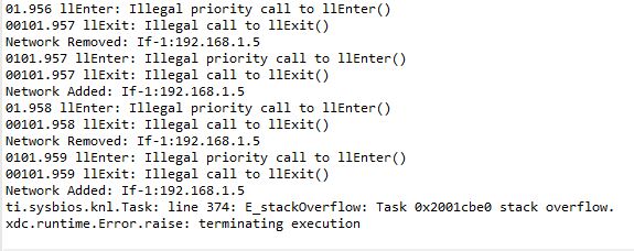

I want to assign network IP address dynamically from user application. for these i have created the code below for updating the IP address. This is working well when this can be done in Network hook function. But its not working when we are updating from user application in middle of execution.

when i am adding it in Hook function, its perfectly working fine. see the snapshot below.
See the below error when i am updating from user application & task is getting terminated from due to stack overflow.
Here i am using GPIO interrupt to update the IP Address. when GPIO is set high, interrupt handler will be invoked and post the event for pending task to perform the IP address update.
Can you anyone help me solve this issue?
