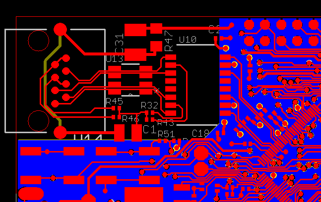

    I also pointed the customer to the eagle files. Thanks for that. This was their feedback from that:
    Here is the LaunchPad area. It's 1.5" from chip to jack.
    If my layout looked like this, I'd be very happy.
    I'm surprised that this fails in the same manner. it has matched lengths, proper termination location. Good grounding.
    Q. for your hardware guy, why does length from magnetics to jack matter, when I could have a 100M cable?
    Thanks for the help. Let me know what else you need.
  • Hello Carolus,
    Regarding the question for magnetics versus cable length...
    PCB traces are exposed to the environment around them and are subject to many possible kinds of interference. Traces also need to be impedance matched. To prevent interference, using the shortest possible traces minimizes the area that needs to be protected from other signals that could inject noise. Also while on the topic, using wider traces helps reduce the inductance of the traces themselves.
    In contrast, a long cable that is properly designed and manufactured has near constant impedance for the length of the cable and, for Ethernet, the cable has shielding as well to prevent outside noise from interfering.
