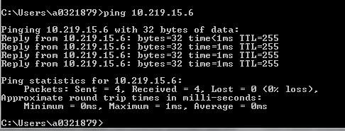

I have programmed a serial to Ethernet converter and have tested it successfully on EK-TM4C1294XL Launchpad. Now I have shifted to a custom board designed fir this facility. When I run the code, Ethernet is detected on my PC and the LED on custom board also glows. I am also able to acquire the static IP for the board, But I am not able to open the configuration webpage from the acquired IP. Also I am not able to get any ping of PC with the device.(I checked using MS-DOS). I visualised the data using wireshark utility.
Also here I am able to detect Ethernet on my laptop . I am sending the ICMP packet from my laptop's ip: 192.168.1.130 to the static IP assigned to the custom made board: 192.168.1.5. For the board, the subnet mask is 255.255.255.0 and the default gateway is 192.168.1.1.
For my laptop, the subnet mask is 255.255.255.0 and the default gateway is 192.168.1.1.
But, when I connect it to the Launchpad, everything works fine with the same code. I am also getting response ICMP packet from the board to the laptop's ip.
What can be the error? IS there some error in configuration or the hardware?

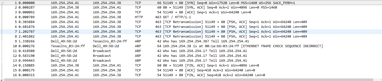

    Thanks for the quick reply. I am able to send and receive UDP packets from the board to my laptop and vice-versa. But still the ping is still not coming. It is an ICMP packet.

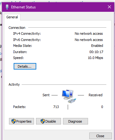

    Also, the speed is supposed to be 100 Mbps, but its coming out to be 10 Mbps only. Also I am using lwip stack, and I am unable to open the configuration webpage.
    Also, in the code, I have set CHECKSUM_GEN_ICMP as 0 in lwipopts.
    #define CHECKSUM_GEN_ICMP               0
    Also. the laptop ip is 169.254.254.41 and the board server ip is 169.254.254.38. The board is replying the tcp packets, but is not responding to the http request sent by the laptop.

  • BTW your PC connection perhaps is half duplex ? no RXD data into PC would inhibit ICMP response from custom board. Check with scope around Pulse XFMR pads for solder splash or cold connections.
    I tried changing my laptop's configuration from automatic to 100 Mbps full duplex, but still its giving 10 Mbps only. Also, I can successfully send and receive UDP packets from laptop to board and vice versa, but along with receiving the UDP packet, my laptop sends an ICMP packet to the board which is "not reachable". I am not able to get response to ICMP packet(ping) and also I am unable to register http GET requests. I can't understand how I am able to send and receive UDP packets but not http requests. Also, the same code works with TM4C1294NCPDT . I am only facing the problem with the custom based TM4C129ENCPDT board.

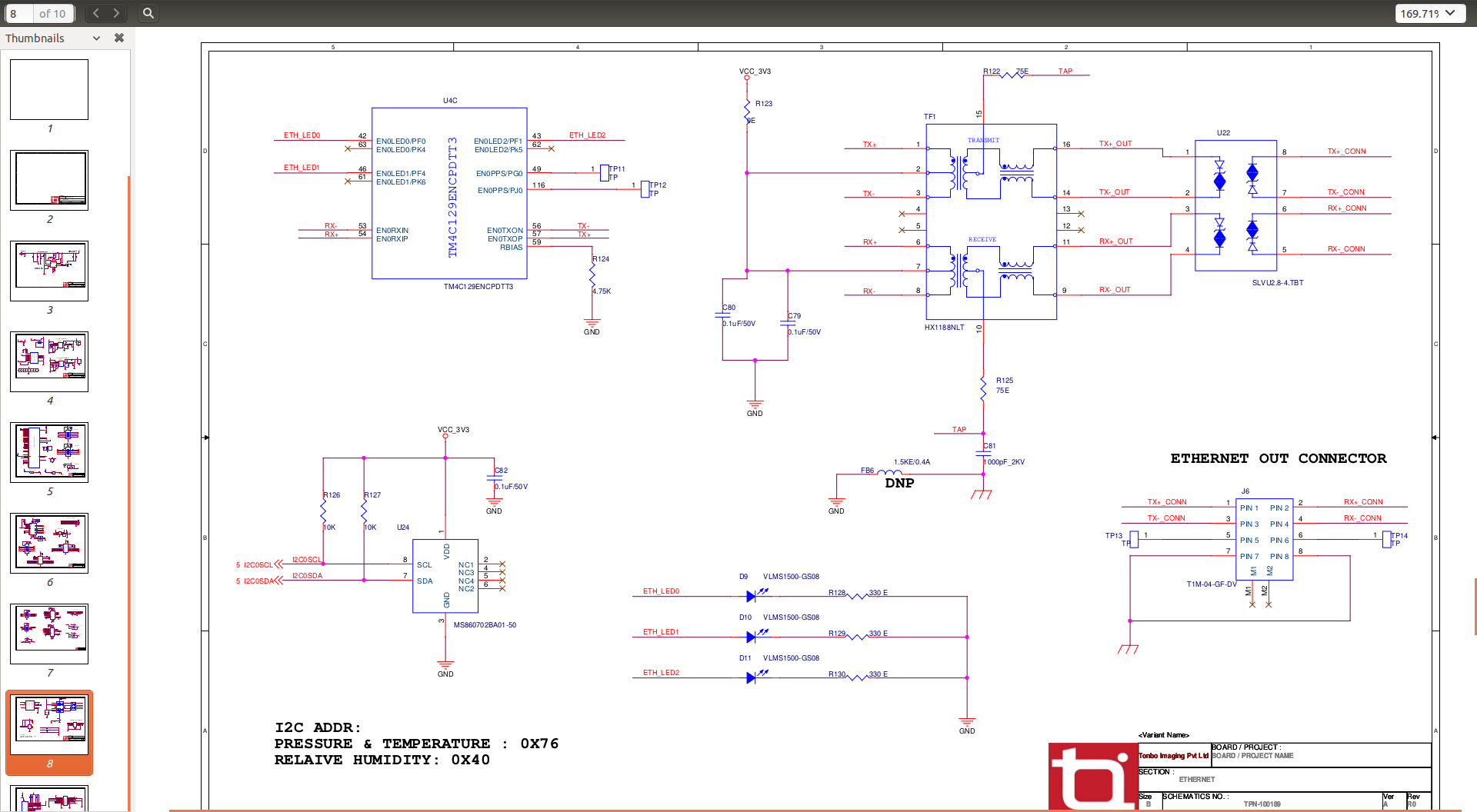

    I have used the following schematic for custom board:

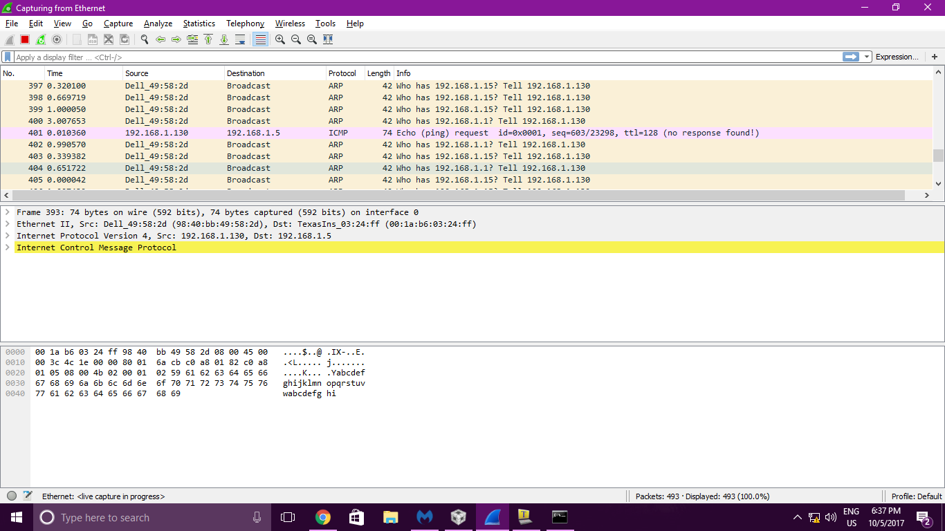

      If the same code works on the LaunchPad but not your custom board then it is most likely not a software issue. I will suggest a few things.
      1. Do you have another board that you can try? Will you get the same problem?
      2. Can you try DHCP instead of static address. Is it possible that your static address is not registered with your gateway/router. By assigning static IP directly to your MCU I wonder if the port forwarding could be removed from the gateway. Try DHCP and see if that helps. Please check with your IT department if any firewall in place and how static IP address is handled.  We are not expert in this field.
      3. I also see "no response found" in one of the ping packets but it looks like more a wireshark issue. When I expand the packet it looks proper. Did you use the window ping command? It should send 4 echo requests by default as shown below. What did you get?
      4. Can you try one of the TivaWare ethernet examples like enet_iot or enet_lwip on both your LaunchPad and custom boards?

    Again the 2 caps C79,C80 you selected as 100nf can be made high as 3300nf if perchance the device layer MLID is not forming a MAC frame with the host. Might explain why UDP packets seem to get out on the wire while TCP can't begin to make a connection and ping multicast packets from host are being dropped like hot potatoes by LWIP lower layers. UDP is connectionless ports and no MAC frame is required if I recall correctly.
    Perhaps you did not remove the copper clad from under the pulse inductor, RJ45 connector? Something along those lines might effect the Bob Smith terminator and overall signal quality. Posting a scope capture of the TX/RX pair signals would have been my first request prior to schematic.
  • BTW schematic check, Ethernet out pins 4-5 are open and 7-8 feed directly to ground, all pins omit required 75 ohm terminators. Your PCB layout deviates far from the recommended but can be fixed with a quick solder bridge pins 4-5 add a 75 ohm to FGND or AGND plane. Perhaps cut trace from pins 7-8 leading direct to FGND, add 75 ohm + capacitor (1000pf/2kv) Bob Smith terminator.

    Thanks for all the suggestions. In the datasheet it was mentioned that the HX1198FNL is the preferred transformer for best Ethernet performance. Apoorv's schematic shows a different part. I think this will be something to be checked as well.
  • Hi Charles,
    Agree the Ethernet connection medium can be very touchy with the differential pairs location routing and overall length as well. Hope the HX1198FLNT works ok on our custom PCB, it too was another choice mentioned of the two recommended transformers.
    I interchanged the HX1188FLNT on the custom board with the HX1198FLNT present in the launchpad. Still, I am not able to get ping and open the webpage in the custom board. And for the Launchpad, the code still works. I also tried a DHCP server but still no luck.
    In reply to BP101's query, "Ethernet out pins 4-5 are open and 7-8 feed directly to ground, all pins omit required 75 ohm terminators. Your PCB layout deviates far from the recommended but can be fixed with a quick solder bridge pins 4-5 add a 75 ohm to FGND or AGND plane", for which component pin nos 4,5,6 and 7 are you talking about? There are no 2 separate ground FGND and AGND in my schematic.
    Also, I don't have Bob Smith terminator in the circuit. Is it the RC circuit and will it make a difference ?

    The Ethernet out RJ45 jack and check again I edit post 75 ohm Bob Smith terminator has 1000pf/2kv cap to some ground point.
    Technically the fork shaped ground symbol is considered frame/chassis ground and the lined ground symbol is analog ground plane back side of 2 sided PCB. Triangle shape is digital ground often tied to analog ground somewhere through VIA on top side PCB. Datasheet NCPDT Figure 20-13 may differ from ENCPDT, from my limited understanding ENCPDT is different in 256kb data encryption support is built into EMAC0.
    Charles might be better to explain any difference that might effect the Bob Smith terminator on the pulse transformer between MCU types. My guess there is very little if any difference (Bob S.) unless ENCPDT adds Gigabit over copper wire.

    Looking again at schematic I noticed there are no pull up resistors or bypass caps on EMAC0 RXD/TXD lines.  Perhaps you could add the required 4 (49R9,1%) and 2 (0.1uf) close to MCU pins RDX/TXD.
  • On U22 protection device you don't have pin 1 connected to 8, 2 to 7 etc, as on reference schematic. This is huge difference...

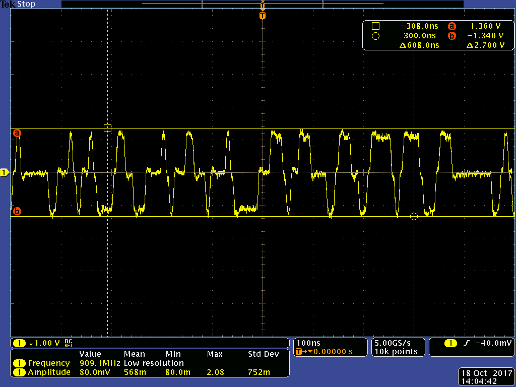

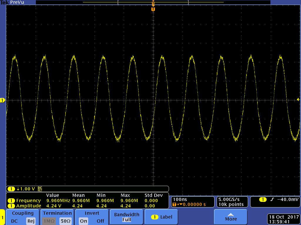

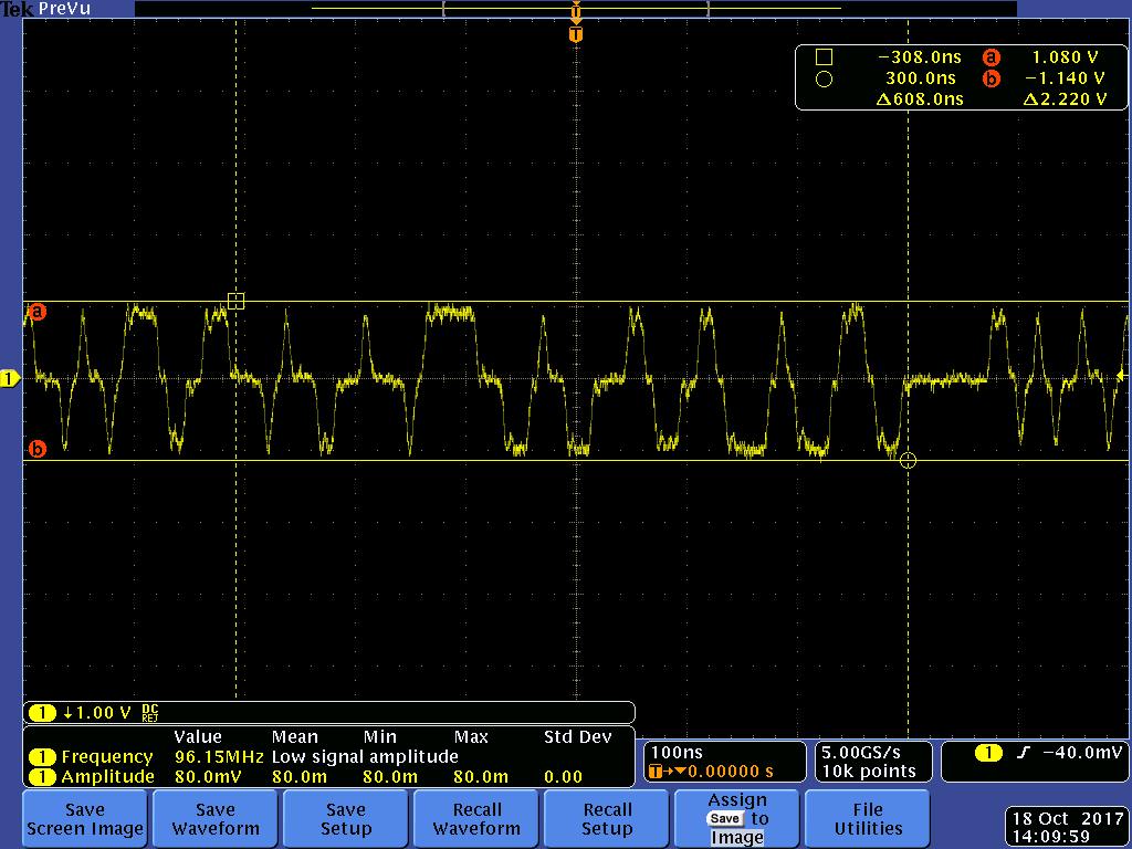

  • Hi all,
    1. Launchpad Tx waveform snapshots.
    Launchpad_TX
    1. Launchpad Rx waveform snapshots.
    3. Tonbo S2E Tx
    4. We have the pull-up resistor connected in our circuit as suggested in the previous post.
    5. The circuit is open between the ethernet differential in the bare PCB.

    Not sure who Nandish is working with and why he posted a capture of launch pad TXD/RXD signals let alone what Tonbo S2E represents or why it was even included.
    Typically a (loop back R45 plug) is made/installed for custom PCB RJ45 jack so a round robin (echo) test can be verified at the MCU pins or primary side of the Pulse transformer. You can program the Ethernet software to send a constant binary pattern (1010.1010) which will appear as a 50% duty cycle signal on both TXD/RXD mixed in with the carrier signal. Another though more tedious production method might TXD send packets on the wire and Print them out via UART serial port if one exists.
    I am Nandish and team member with Apoorva working this project "Tonbo S2E". Since Apoorva is on leave, I have to post the results.

  • Hi Nandish,
    Your Tonbo-s2e in this forum typical name is custom PCB. Tonbo TXD capture is not what we would expect 4.2v Pk is much higher than LP 80mv TX/RX capture, probe same pins as LP?
    Perhaps check datasheet Ethernet section 27.19 figure 27-37 & table 27.39. Another thought is MOSC 25Mhz XTAL must be qualified type shown in datasheet table for EMAC0 PHY to function correctly.
