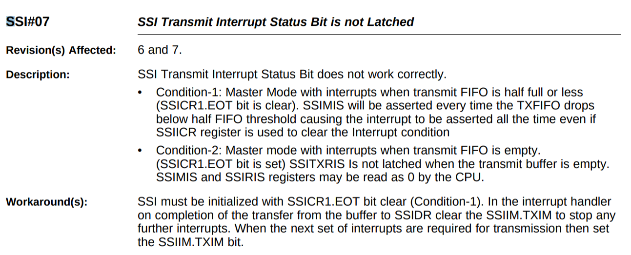

Can someone explain to me the errata SSI#07 of the TM4C123x. It's shown in document SPMZ849F (link).
I'm trying to get an interrupt when the SSI is done transmitting (SSI_TXEOT). Whatever I try, I either get no interrupt, or an infinite amount of them.

When I do get an infinite amount of interrupts; status is set to 8.
Any hints/tips on getting this to work? or am I misinterpreting the errata and is this impossible?

  • Dear Charles,
    Unfortunately it is not that the time spent in the interrupt service routine is too short for the processor to clear the flag. I have extended the code and paste it below in full.

    There is both a SysCtlDelay as well as a UARTprintf now in the ISR. That should be plenty of time for the processor to clear the interrupt flag.
    Output from the console is:
    Enabling SSI0
    SSI0 enabled
    ISR: ui32Status = 8
    Interrupts enabled
    Residual data read
    SSIIM.TXIM set
    ISR: ui32Status = 0
    FIFO loaded
    Done writing
    SSI transaction completed
    End of delay
    What is strange to me is that the interrupt is triggered immediately after enabling interrupts (before UARTprintf can output 'Interrupts enabled'). The first time ui32Status = 8 seems the right one (although there is no EOT here). I cleared SSIIM.TXIM inside the ISR to stop the flood of interrupts. If I set the TXIM bit again, it seems that the interrupt is now indeed triggered at EOT, but somehow ui32Status = 0... (i.e. no interrupt?).

  • Hi Andrew,
    I can replicate your result and spend more time tomorrow.
  • Hi Andrew,
      Again what you have seen where the ui32Status is read zero is the result of Errata SSI#7 for condition-2.
  • Hi Charles,
    I managed to get the EOT interrupt working. See the example code below; might be useful if someone runs into a similar problem. I still have to confirm the timing using an oscilloscope by comparing the SPI CS line (PA3) and PF3, but I do not expect issues there.
    What caught me off guard was that you first need set the EOT bit in SSICR1 before enabling the SSI_TXFF interrupt, or else it will immediately call the ISR. Easy pitfall :-). There is no need for the workaround (to clear SSIIM.TXIM) if you are working in Condition-2; you only need to be aware that SSIIntStatus will return 0. The documentation could be more clear in this.
    Thanks for your support!

        for(ui32Length = 1; ui32Length <= 10; ui32Length++)
            // Reset the interrupt counter.
            g_ui32IntCounter = 0;
            ui32Index = ui32Length;
            while(ui32Index)
                SSIDataPut(SSI0_BASE, ui32Index);
                ui32Index--;
            while(SSIBusy(SSI0_BASE));  // Interrupt should occur here
            // Verify that the interrupt was only fired once.
            if(g_ui32IntCounter != 1)
                UARTprintf("ui32Length = %d, g_ui32IntCounter = %d\n",
                           ui32Length, g_ui32IntCounter);
        UARTprintf("done.\n");
        // Disable interrupts to the processor; loop forever
        ROM_IntMasterDisable();
        while(1)
  • Hi Andrew,
    Glad you problem is solved and thanks for sharing the tip to first set EOT bit before enabling TXFF interrupt for condition-2 usage.
