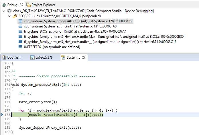

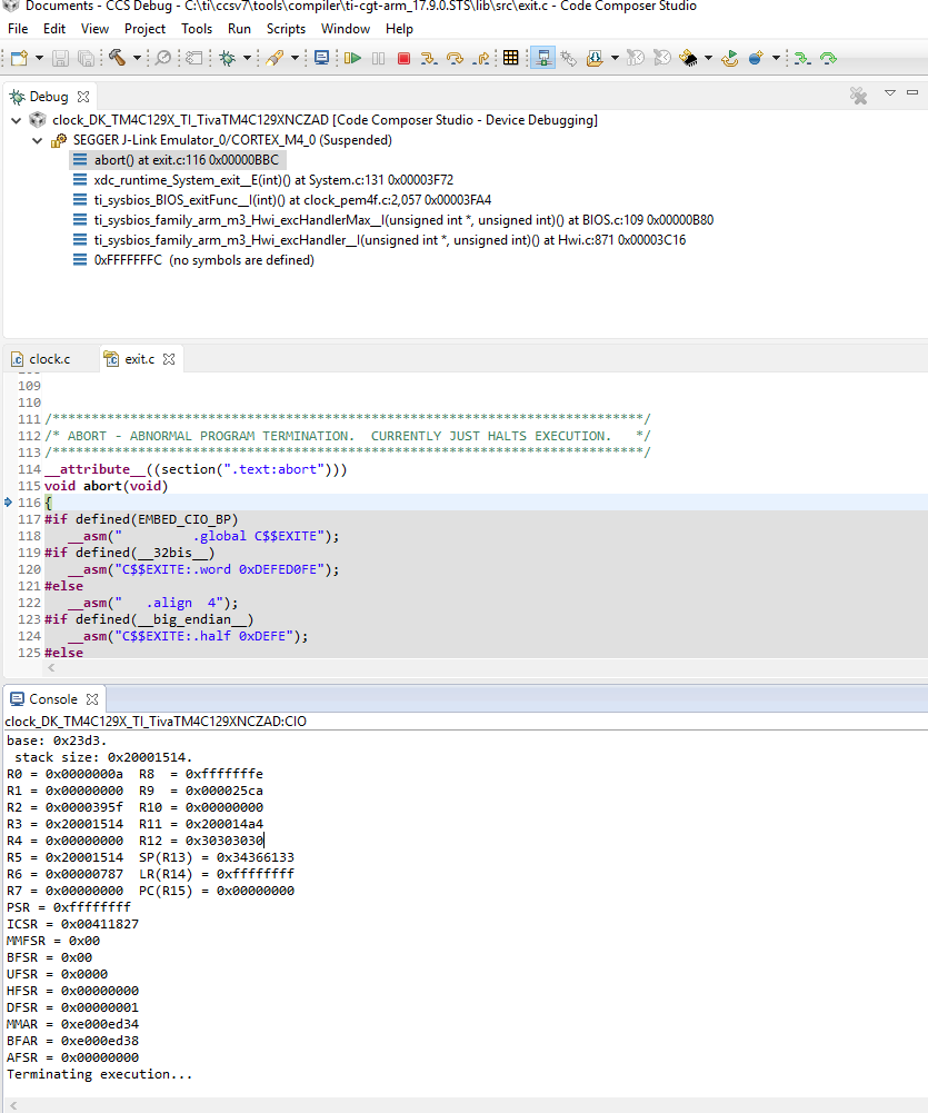

    I tried another TI-RTOS example - "Clock Example" (clock_DK_TM4C129X_TI_TivaTM4C129XNCZAD) and I got a similar result when using J-Link.

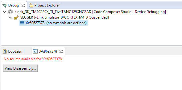

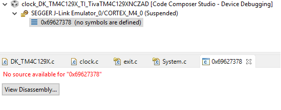

    When I first try to debug it (after switching from XDS100v2 to J-Link). The program crashes before I even get a chance to start it. After I press the "Debug" button CSS compiles the project, programs the device and stops in a crashed state. Please see the screen shot below:
    On every subsequent attempt after I press the "Debug" button CCS compiles the code, programs the device and stops on the first line in main(), but after I press the "Resume" button the program crashes immediately. Please see the screen shot below:

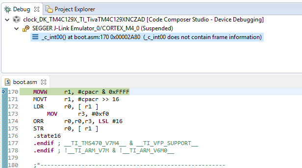

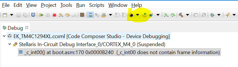

    1. What's the entry point? You need to disable the "run to main" feature in CCS. To do this once you've loaded the image, halt it and do
    - Tools->Debugger Options -> Auto Run and Launch Options
    - uncheck the "On a program load or restart" box.
    - Save ("Remember my Settings"...not sure why it's not just save)
    - CPU Reset (highlighted below)
    - Restart (highlighted below)
    You should be at _c_int00...are you there?
    2. Could the watchdog be going off? The RTOS does not do anything with it.
    Todd
  • H Todd,
    I think it all looks ok.
    1. After following your instructions and starting debug session I was at _c_int00.
    After clicking "resume" program crashed as before:
    after restarting the whole procedure program crashed in the second way(same as before):

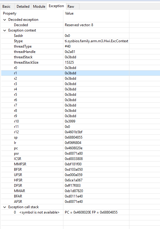

  • Hi Peter,

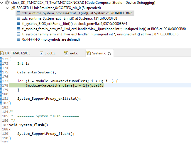

    Can you look in Tools->ROV->Hwi->Exception to see the back trace? This should help show what is causing the exception.
    Todd

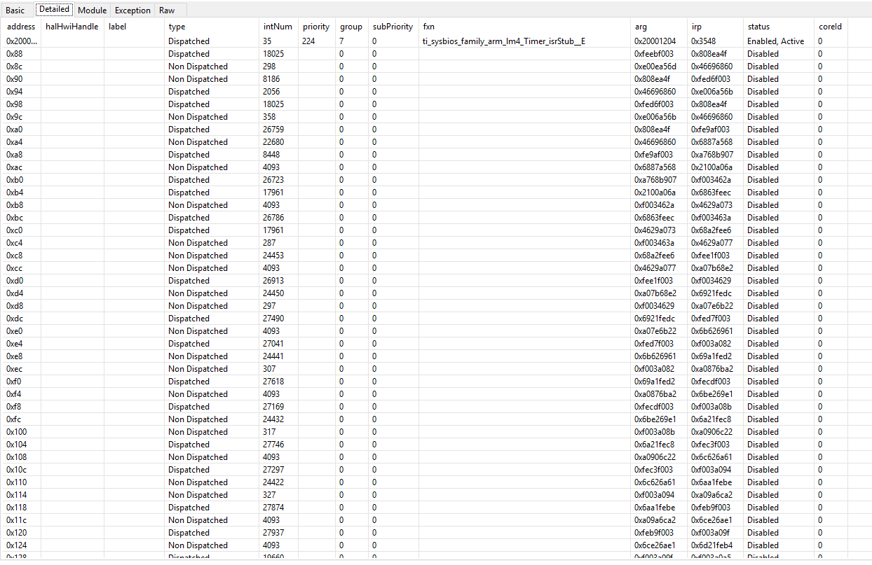

  • Hi Todd,
    Please see below:
    I also noticed that there is a lot of interrupts listed in the "Detailed" tab. Not sure if that matters but it seems strange.
    After I press the "CPU Reset" button and then "resume" there is only one int listed in the detailed view.
    Peter A.

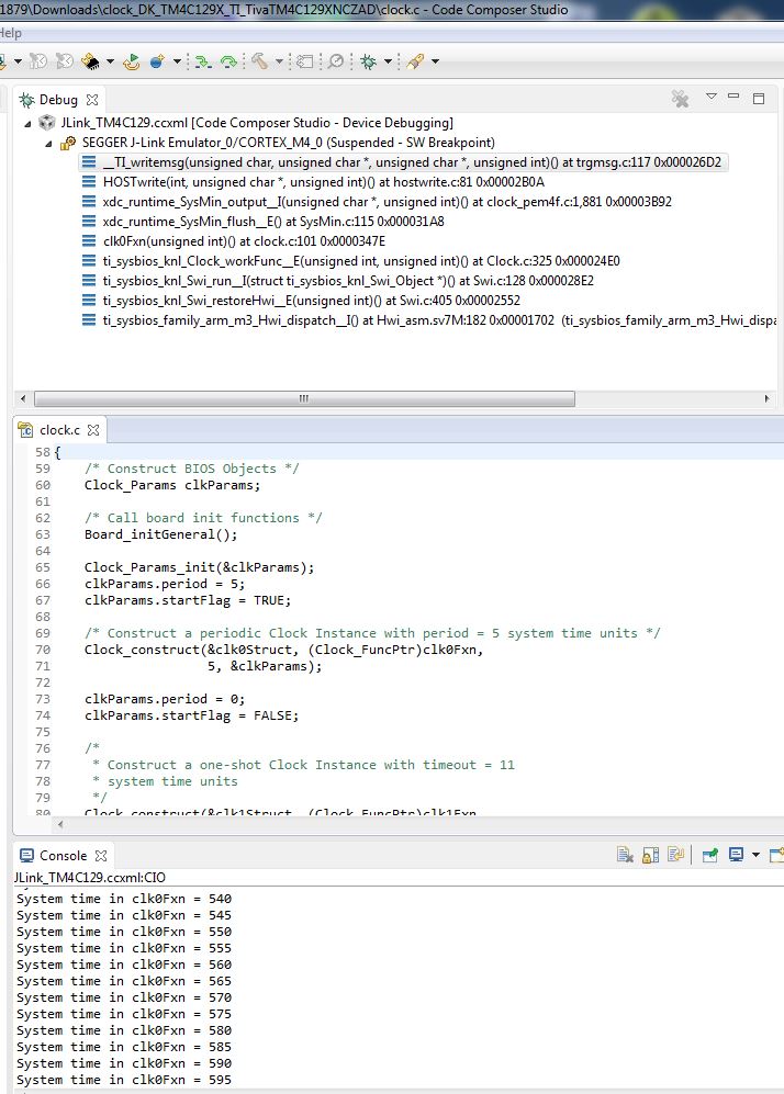

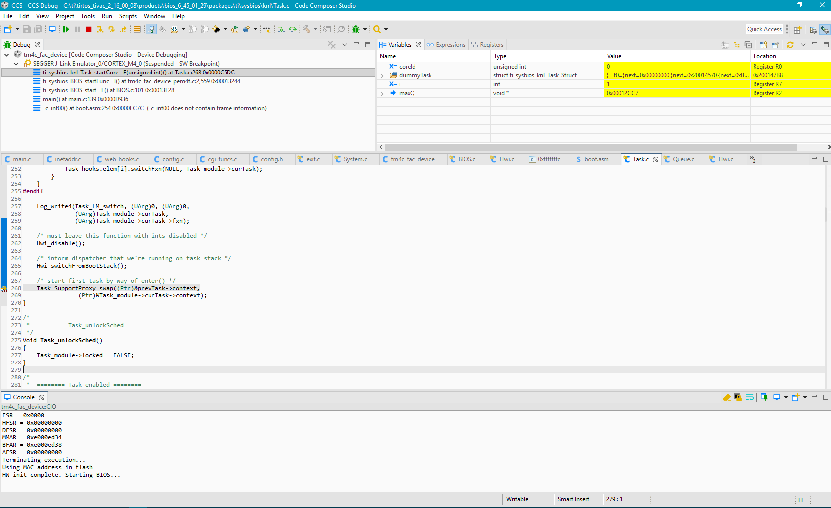

  • Did you ever figure this out? I'm having the same problem with my J-Link, while the ICDI interface on the EK-TM4C1294XL works totally fine. Really frustrating.
  • Stepping through with the J-Link, it always crashes as I try to step into this line:
    You can see the console output from the previous crash in the screenshot too.

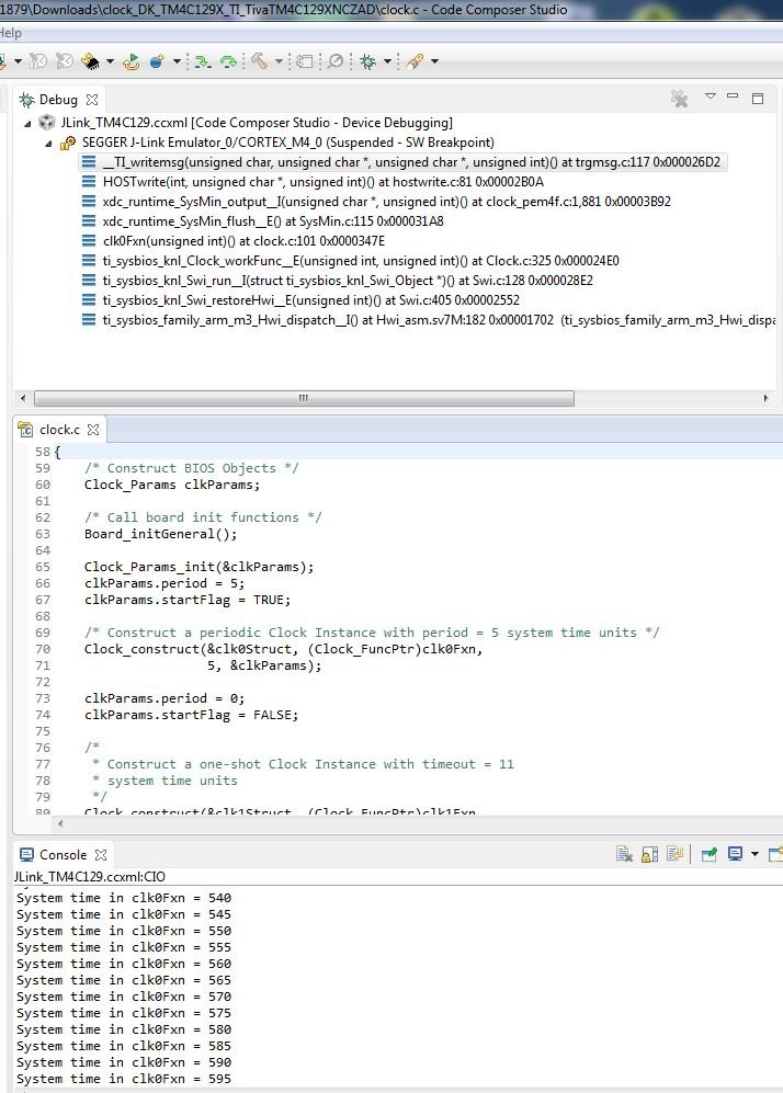

  • Peter,
    The solution suggested in the other thread seems to be working for me, maybe you'd like to give it a try.
    Nick
  • Hi Nick,
    I just tried it and it works fine. Thank you very much for the information.
