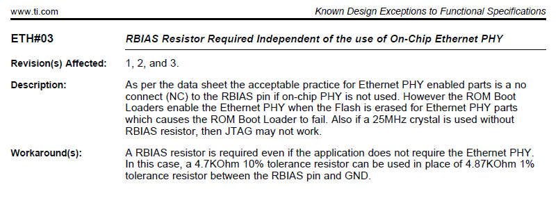

  • Most issues reported like this end up being board design or JTAG scan controller issues.  You are correct that the external crystal is not required for device programming as the device initially runs off of PIOSC.
    The lack of an RBIAS resistor causes JTAG issues sometimes. See erratum ETH#03 which I copied below:

  • great tip Bob; works Appreciate.
