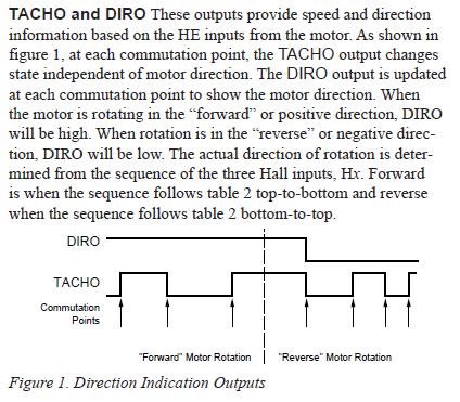

    Earlier I questioned your definition of "motor drive IC" - you noted the "A3930" which performs functional control (far) beyond a normal, "Gate Driver."    (gate driver required to adequately drive/enhance the Power FETs - which drive each of the BLDC Motor's 3 phases).     I've (now) made the time/effort to review A3930's data - I do not believe it provides the, "Accurate Positional Data" you seek.   Not close!    (nor do I know of "other" devices - with such capability - unless one employs (as I initially suggested) some form of "Motor Encoder!")
    For clarity (& confirmation) - I present the key finding from my review of A3930 spec - which signals its "inability" to meet your "Accurate Position" detection:   (follows a true copy)
    Do note that "Tacho" provides a, "Motor Speed" based signal - yet is FAR REMOVED from (any) "Accurate Position" detection/reporting!    This is so as the description (above) notes: "At each commutation point - the Tacho output changes!"    Those "commutation points" occur w/each/every Hall Signal change - and those Hall Signal changes are, "MANY motor rotational degrees apart!"   Thus - the "Tacho" signal from A3930 proves "far too coarse" to provide any "accurate" (your word/definition) positional information.     (and - even to "attempt to do so" - requires great software effort!)
    Thus - as I earlier noted - your "method of attack" is (pardon) flawed - has (little) chance for success.    (you may be able to "interpolate" between Hall impulses - yet that's (highly) non-standard - and outside the interest of (most all) here.)
    As earlier suggested - motor encoders exist for "good reason" - your desire for, "Accurate Position" being "Number One" dictating Encoder's Use.   ("convention" - at times (most times?) indeed has its place!)
    Your struggle w/Timer's change of direction seems - "no longer required" - in light of these findings...
