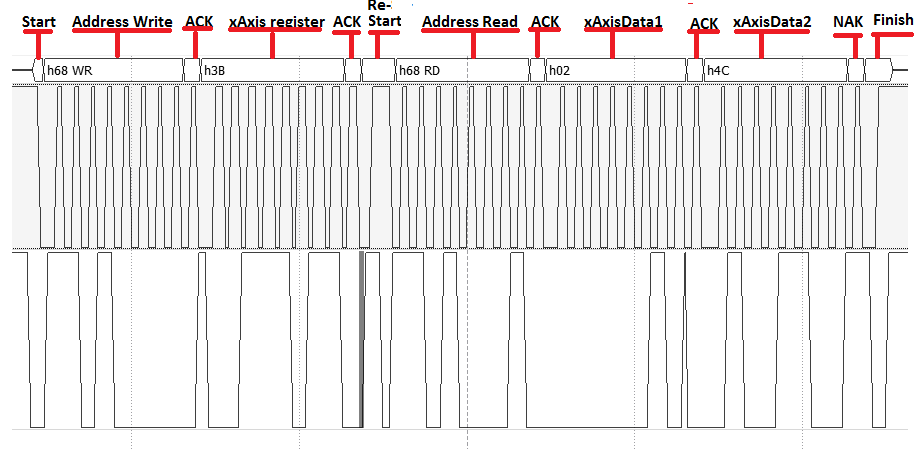

  • Ok, using a logic analizer I was able to replicate in the TM4C , the configuration sequence that the Arduino use to configure the MPU6050 (just setting to 0x00 the PWR_MGMT_1 register), the MPU6050 sent the ACKs and everything is OK with that, from here I thought that the rest would be easy, because I know  how to use the burst sending using I2C, but the problem  comes for reading data.
    So again using the logic analyzer I was able to see what is the sequence of data that pass through the I2C bus, here is an image (using arduino):
    In first place the master have to write in the I2C bus the register from the xAxis (0x3B), then configurate the master for reading (re-start), and then just read the 16 bytes of data from the xAxis register. I have made the next code in order to write (0x3B) in the I2C bus, then configurate the master for reading, but for some reason, in the second while loop the code gets stuck in the marked line:

  • Here is the code to get the data from the x Axis of the MPU6050, I share it because I do not see any complete solution on this forum for a problem that looks to be popular, maybe it is an easy problem to solve for some people (for me was hard because is my first I2C program) but it was really frustrating for me to found almost nothing about this topic on this forum, here is also a link to a I2C proyect that helps me a lot.
    https://github.com/lamarts/Tiva-TM4C-ARM-Coretex-M4---I2C-Sensor/blob/master/MCP9808_main.c

    This is not a complete solution, Y and Z axis, also gyroscope and temperature sensor are not in this code, once I complete it I will share through this post.
  • In your initial post you noted that your "X-Axis" data was (always) zero. It was suggested that you "align" that axis w/gravitational field - which should provide an, "escape from zero."
    Today you present an "X-Axis solution" - yet never comment upon the X-Axis data - now obtained. That's not (entirely) consistent - is it?
    Have you a better means to "generate accelerations" - so that ALL axis performance - may one day - be achieved?
  • Here is the code to get the raw data of the 3 axis accelerometer that is on the mpu6050 using the tm4c129,the data is the same that is obtained by using the arduino, that use the wire.h library.

    Hope this can help anyone who needs it
