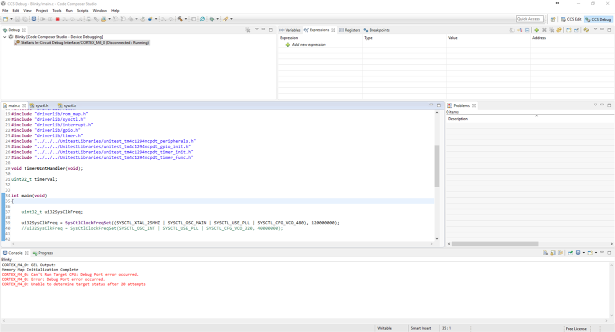

    I have updated my TivaWare to the most recent one and nope still does the same thing. I have 5 copies of the same board all have the same problem. Here is what happens:
    1. The code works fine with intrenal oscillator, so I switch the code to 25 MHz crystal,
    The code loads with no problem.
    2. When I press the resume button to see the blinking:
    I get the: "Can't run Target CPU: Debug port error occurred."
    I don't believe there is something wrong with the JTAG port otherwise it wouldn't load the the previous code. Everything works fine with internal oscillator, but when I switch to crystal it blows.
    3. Also when I do  debug port unlock procedure, something weird happens. When I reach the final step, which is to re-power the device, and load the working code I again get the same error. But if I don't disconnect  the power cable (meaning I am not completeing the power cycle) And the compile the code it gives me a warning that the device couldn't be reached, then I disconnect and connect the device anr retry compile and it works.
    I am a bit lost on whats going on and open to advices...
    The code to switch to the 25MHz crystal looks correct.
    Are you able to try running the code on a launchpad?
    If the code runs OK on a launchpad, it points at maybe a fault on the custom boards with the 25MHz crystal circuit.
  • Chester has raised a good point [LIKE]. Have you looked at the 25MHz crystal with a scope to see that it is oscillating properly?

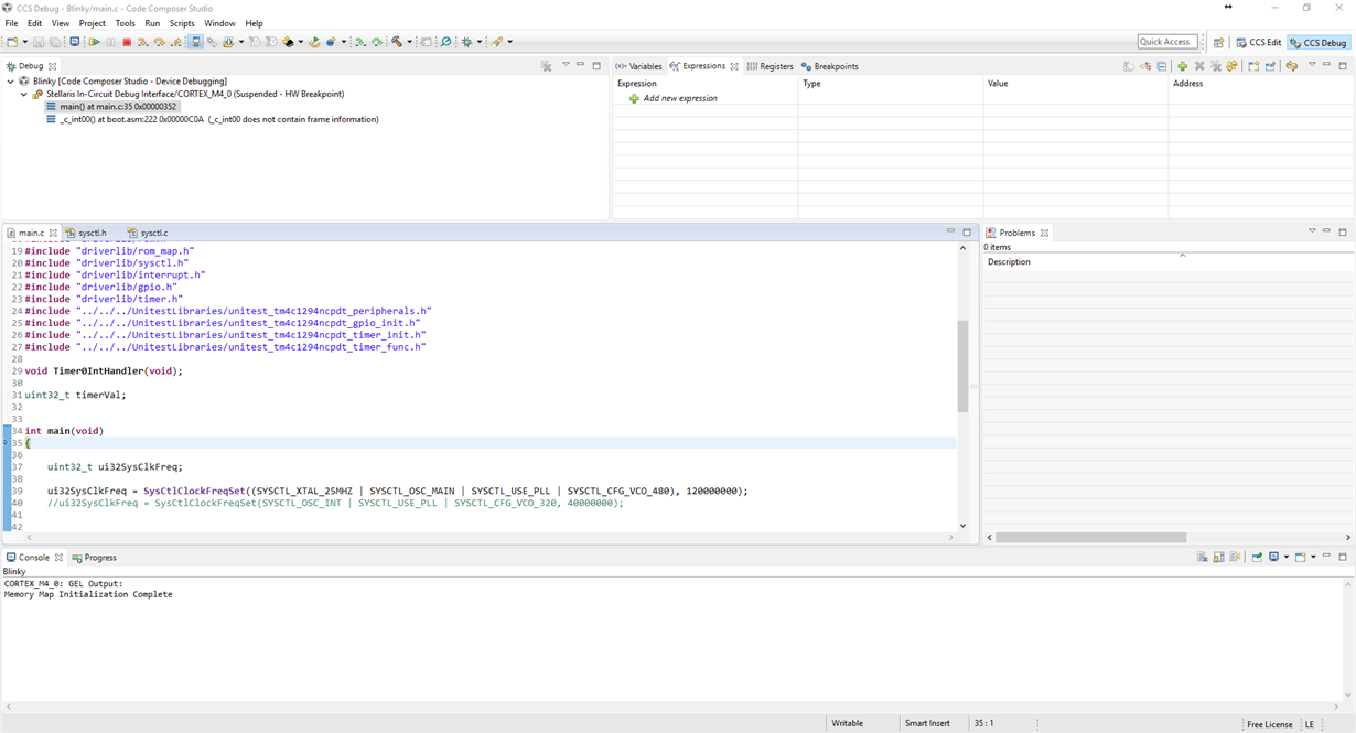

    Correct me if wrong but would not that indicate the MOSC is clocking Flash memory and AHB bus. Secondly even with ICDI setting checked to reset target, run to main after a program load (CCS5.4 & 7) often have to click on reset target and restart before clicking on resume or the DAC throws CCS an exception of connection error.
