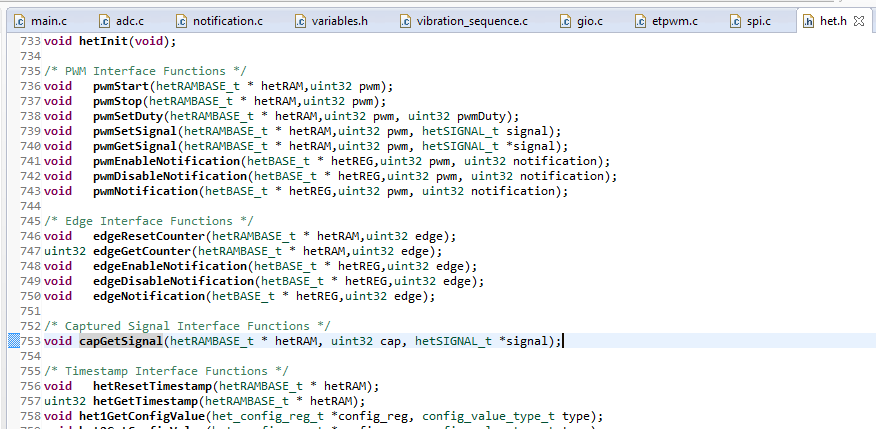

Im working with the Hercules TMS570LS1114 and I need to connect 9 quadrature encoders with the N2HET. I saw the application note http://www.ti.com/lit/an/spna228/spna228.pdf with the state machine. I also read this post: http://e2e.ti.com/support/microcontrollers/hercules/f/312/p/536444/2021979 and found it quite helpful but today I was using Halcogen and on the het.h file I saw some functions for edge detection and also counters.
I was wondering if, even when Halcogen only supports 7 captures or 7 interrupts per HET and I need 14 on HET1 and 4 in HET2, I could use C functions to do the code or if there is another code for the module to be able to do the task since I tried to replicate the post I added here and had some problems.

    I did not get that about the interrupts. I was asking about the generated code by Haclogen, since it has some functions to control the Capture, which I could use to get the encoders signals or even as External Interrupts. The problem is that there is no enough documentation about that in the code or on how to use them. Also, since Halcogen only allows for 7 captures or 7 interrupts I would need to manually configure 7 pins for the 7 encoders in one N2HET and 4 pins for 2 encoders in the other (this two encoders could be configured in Halcogen without major problems but the first 7 encoders, 14 channels, are the problem) and that what Im looking for.
