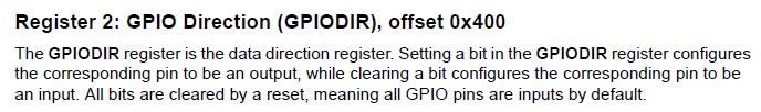

Can you please help me understand what the startup conditions of the GPIO pins are for the TM4C123? Are they tristated, floating, or are they tied high or low on startup?

    Most GPIO pins are configured as GPIOs and tri-stated by default. However, there are a few pins which may be programmed to a non-GPIO function.
  • When in such (fair) doubt - does not "RTFM" rise to, "top of the list?"
    Section 10 of the MCU Manual further details - there are individual registers which control/enable pull-up or pull-down - my quick read of "GPIOPUR" noted these as "0" at reset thus not pulled up ..   The corresponding "GPIOPDR" lists values as "0" post Reset again pull-down R's are NOT enabled.   It thus appears that "unprogrammed GPIOs" float (never good - but for brief periods) and await software to configure...
    As Charles notes - there are multiple GPIO pins which fall under, "Special Considerations" and may be "Re-Purposed" from GPIO to Alternate Functions.
