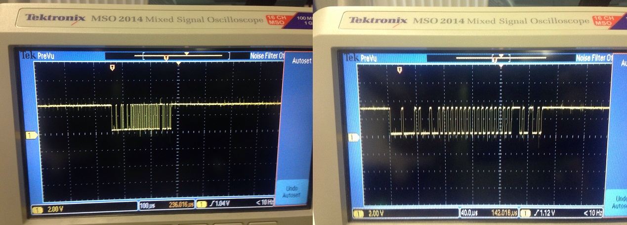

Hi All. I am very new to CAN Bus protocol and TM4C. I am given a task to transmit CAN messages from 1 TM4C129EXL to another TM4C129EXL launchpad. Since I am new to this and I need to start from somewhere, I have decided to adapt the code and the hardware from the link below : http://ohm.ninja/tiva-c-series-can-bus-with-mcp2551/  and also by refering to the sample code from C:\ti\TivaWare_C_Series-2.1.4.178\examples\peripherals\can.
I have added severel UARTprintf to the void CANIntHandler(void) to help my debugging. I have also used the oscilloscope to check CANH,CANL and TX but there are no output (hence, scope caps are not attached in this post). The JP4 and JP5 jumpers are in default configuration since CAN1 is used instead of CAN0. Please do assist.
Attached is my code for Master:

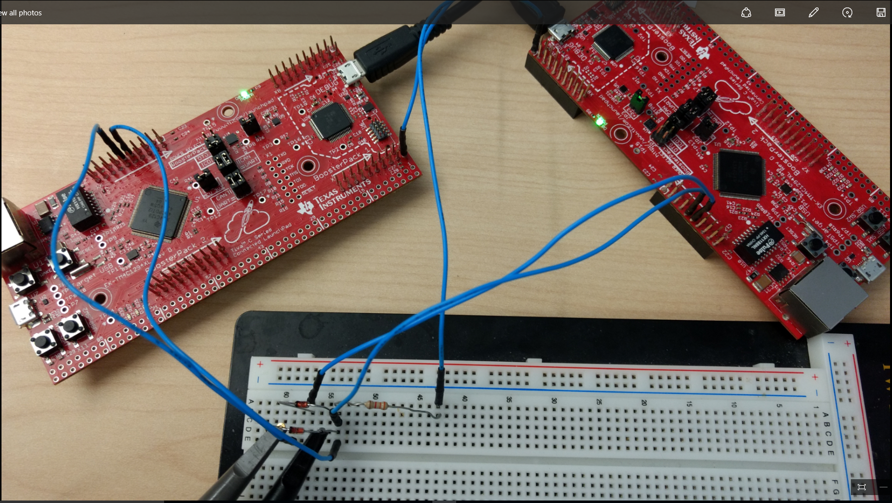

Attached is my circuit diagram:

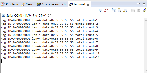

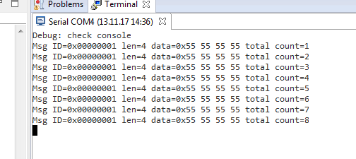

Attached is the output from the terminal:
  • Gowtham said:
    No terminal output at this moment. Due to limited resources, I am working on a method of using a RS232 cable for the UART(terminal

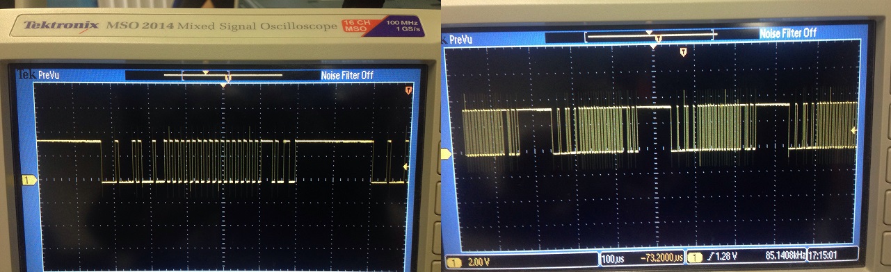

    Hi Gowtham,

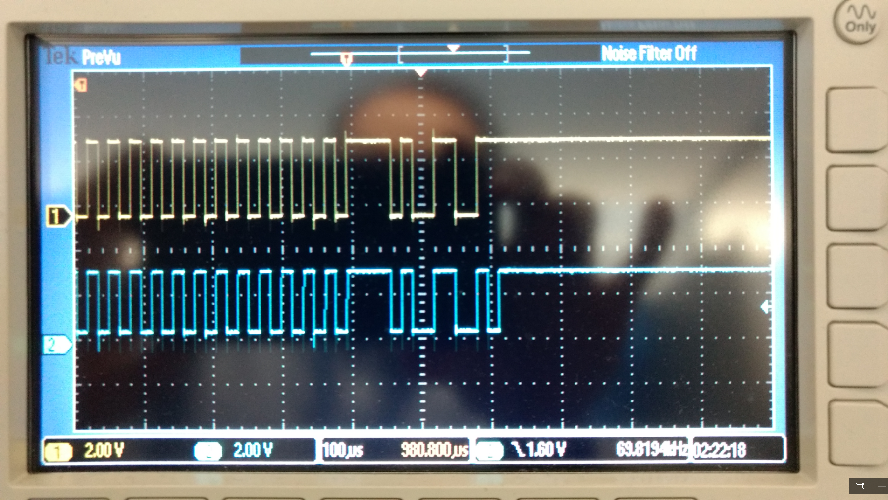

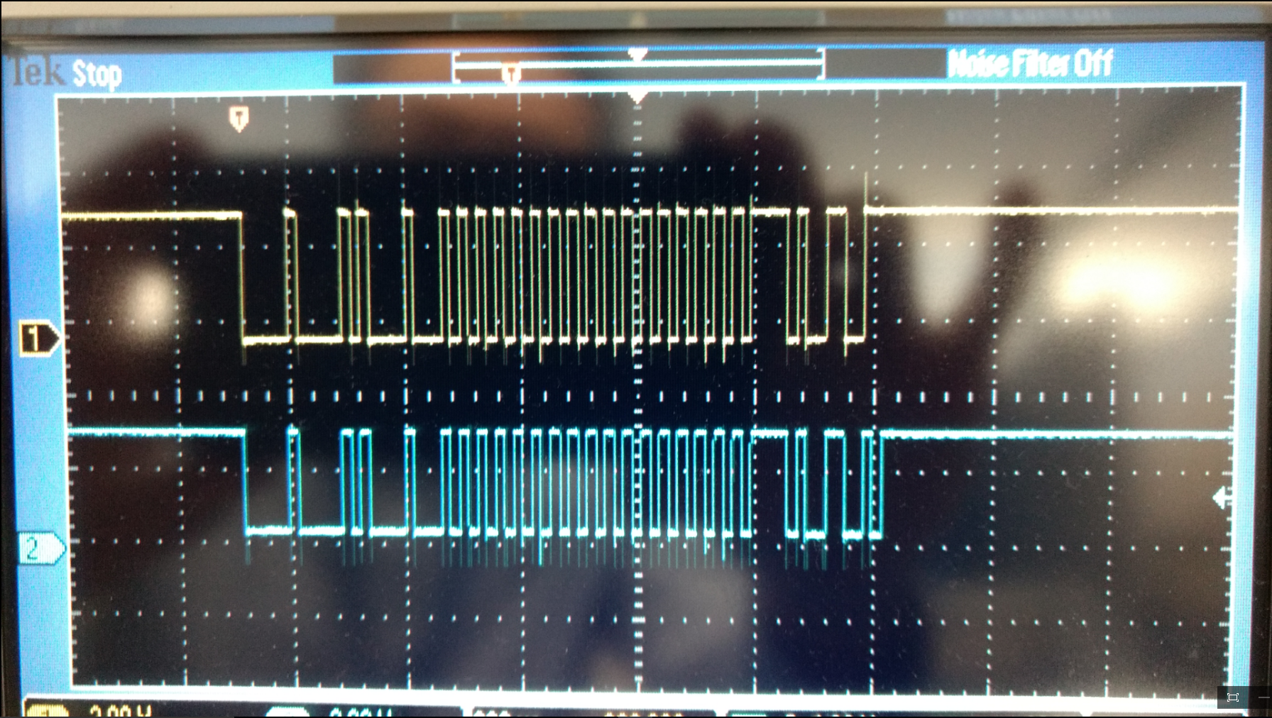

    According to schematic notes CAN0 JP4/5 (||) only need change UART0 to UART2 in software configuration and ICDI will send printf() data as before via USB virtual COM port on your PC.
    So the scope shows 3v on TXD seems better than 5v, Curious did you have PD6 configured in software for input WPD to keep U4 EN2 disabled (Target_VBUS), turned off on TP4?  I have PD6 as (output) WPD and it works yet found it odd unless configured for digital input unless inputs can be configured as open drain, which doesn't seem plausible. Wonder if they meant PD6 is output and typed input by mistake.
    Charles might have some ideas on PD6 pin direction and seem to think only an output direction can be configured Open Drain. Seem to recall issue OTG port USB device mode PD6 configured input direction. Later  made PD6 an GPIO output and ensured USB0PEN(PD6) was not being configured in device mode.
  • BTW you marked this forum thread several posts above as being resolved, was that by mistake. If mistake you can remove the answered button.

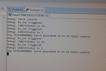

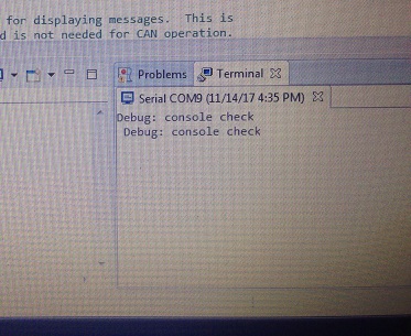

    Hi, so I did try this function for UART2 , but this seems to be not working.
    void
    InitConsole(void)
        SysCtlPeripheralEnable(SYSCTL_PERIPH_GPIOA);
        GPIOPinConfigure(GPIO_PA6_U2RX);
        GPIOPinConfigure(GPIO_PA7_U2TX);
        SysCtlPeripheralEnable(SYSCTL_PERIPH_UART2);
        UARTClockSourceSet(UART2_BASE, UART_CLOCK_PIOSC);
        GPIOPinTypeUART(GPIO_PORTA_BASE, GPIO_PIN_6 | GPIO_PIN_7);
        UARTStdioConfig(2, 115200, 16000000);
    Or should I still use  GPIOPinConfigure(GPIO_PA0_U0RX); & GPIOPinConfigure(GPIO_PA1_U0TX); ?
    But Charles did mention, I will need USB to UART converter for GPIO_PA6_U2RX & GPIO_PA7_U2TX (UART2), for which I tried using a RS232 cable. Not working either.

    Hi Charles & All,
    The transmit code seems to work fine with CAN0. Is there a way to check if my receive code is working (without connecting to transciever) ?
    P.S: I am also planning to migrate to TJA1050 transcievers due to its TTL compatiblity.

  • Hi BP101, Gowtham,
     I tried the TivaWare example with one LP board running the simple_tx example and the other running the simple_rx example. Both CAN0 modules connect using PA0 and PA1 from the X6 boosterpack header. It is working for me. Note that I didn't use the transceivers at all. I use the diodes instead.  For short distance CAN bus communication this is ok and my purpose is just to demonstrate that the examples work.
     If you look at the first picture you see the TX (yellow) and the RX (cyan). The RX pretty much follows the TX except the acknowledge bits. The ack field is a 2-bit field. As I mentioned in my earlier post I said my data is simply 0x55555555 of 4 bytes. You see bunch of 0101.... transitions followed by 15 bits of CRC and two bits of ACK and then followed by IFS.
     The second picture is a zoom-in view to show the ACK fields being replied by the receiver node.
     the third picture is how I hook them up using the boosterpack connectors.
  • Here is another picture to show what is received by the receiver node.
  • Wonderful..I will try this setup to test my code. But regarding the UART prints, did u make any changes to the code as recommended by BP101 ? Could you share your UART function if it is different from BP101's recommendation ? Are those Zener diodes ?

  • Hi Charles & All,
    UART2 seems to work fine using PD4/PD5. I have some questions regarding your setup.

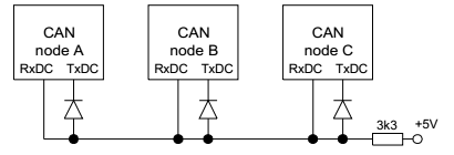

    1) Is your resistor 3.3K ohm ? I could not see the colour code very clearly.
    2) Is it connected to GND or 3.3 V line ? I think it is 3.3V but just want to be sure of this. (https://electronics.stackexchange.com/questions/30564/is-a-can-enabled-microcontroller-sufficient-to-drive-a-can-bus)
    3) And  I need to short the GND of the 2 launchpads right ?
    Thanks.
    Yes.
    Gowtham said:
    2) Is it connected to GND or 3.3 V line ? I think it is 3.3V but just want to be sure of this. (electronics.stackexchange.com/.../is-a-can-enabled-microcontroller-sufficient-to-drive-a-can-bus)
    Please see below schematic. I use 3.3V instead of 5V. Everything else is the same.
    Yes.

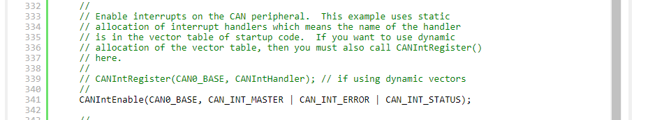

  • Attempted the setup but still no success. Hence, it could be my receive code. My receive code as below.
    Notable changes:
    1) // sCANMessage.ui32MsgLen =4
    2) // using uart2
    3) // Clk is 25000000 & bitrate is 500k are remained as default.
    I just want to know if my receive should work for your transmit code (can0_without_UART0.c). And then I can look into my hardware in detail. CAN0 external loopback is working fine for both my launchpads.

    On your line 339, you didn't register the interrupt handler dynamically. I hope you had statically registered the CANIntHandler in the startup_ccs.c, correct?
  • Finally. It is working. Thank you so much Charles & BP101. Now I can fully focus on my hardware setup  (transciever & etc) without doubting on the code.  Just one more question, it seems to me the receive is not continuos. Seems like I need to press the RESET button of the launchpad(Transmit side) everytime in order to transmit. This is not expected right ?
    Attached the scope cap & terminal output.
  • Hi Gowtham,
    Glad that you are making good progress.
    Isn't your transmitter in a while loop to keep transmitting data out?
    In your scope can you change the time scale so that you can see packets being transmitted continuously?
  • Perhaps I'm not understanding your question. In your scope for the receiver side you are showing count from 1..8 and keep continuing. What do you mean the receive is not continuous?
  • Hi Charles,
    How did you know line 339 there are no line numbers in code. Also curious as to why the 2nd ACK pulse wider than 1st pulse. Like to point out the status register compare code is not being masked by an (&) delimiter.

     I can see the line number. I'm taking a screenshot of the code posted by Godtham this morning.
    I think the image on the left is the TX pin of the transmitter and the image on the right is the RX pin of the transmitter. The RX pin will see the 2-bit ACK generated by the receiver. The TX pin will not see it because it is in recessive state.

    Ok noticed that green code (listing) is missing from AM post, you must mean the attached file code line number. We can't scroll the web page back beyond the current top post to see what lies behind the left arrow, especially in edit mode. The TI web page browser is very difficult to work inside as we only see very 1st post in edit mode. Face Book has the right idea page scroll java handling, need to have MZ come visit TI.

  • Yep verified it's a greyed out posted code listing 11-13 9:31Am, no line numbers show up.
    I see the same as BP, no line numbers or syntax highlighting, just a grey box with code.
    Robert
    Oddly when entering the thread from very 1st post line #'s show until clicking right arrow, turn greyed with no line #'s on other pages. Except the code Charles copied above post show line #'s & green highlights, IE12..
  • Hi BP101, Robert,
    It is a bit weird now that I don't see the line number either. But I was pretty sure that yesterday I saw the line number. I have no idea what happened. I tried IE, Chrome and Firefox. In Firefox even the first very post has the grey box on the code. In IE and Chrome the code from yesterday is in white box but Firefox will display in grey box.
  • Exactly. CANMessageSet is within the while(1) loop. But it seems the transmission break after the first transmission (count =1). Now when I, press the RESET button of the launchpad, the program will reinitiate and it will transmit again (count =2). Then I had to press the RESET button again and again to transmit. I dont think this is expected. Right ?
    Some observations:
    1) ISR is not triggered at the Tx side
    2) ISR is triggered twice for each successful transmission at the RX side
    I also did an external loopback test with my tx on the transmit side. There seem to be continous transmission (from the scope cap). However, the ISR is not trigerred. I dont think this is expected. Correct me if I am wrong. Attached also the code:

        UARTprintf("Debug: Rx_Int triggered\n");
        UARTprintf("Debug: CANIntStatus is %d\n",ui32Status);

        UARTprintf("Debug: check console\n");

        // Enable interrupts on the CAN peripheral.  This example uses static
        // allocation of interrupt handlers which means the name of the handler
        // is in the vector table of startup code.  If you want to use dynamic
        // allocation of the vector table, then you must also call CANIntRegister()
        // here.
        CANIntRegister(CAN0_BASE, CANIntHandler); // if using dynamic vectors
        CANIntEnable(CAN0_BASE, CAN_INT_MASTER | CAN_INT_ERROR | CAN_INT_STATUS);

                UARTprintf("Msg ID=0x%08X len=%u data=0x",
                           sCANMessage.ui32MsgID, sCANMessage.ui32MsgLen);
                for(uIdx = 0; uIdx < sCANMessage.ui32MsgLen; uIdx++)
                    UARTprintf("%02X ", pui8MsgData[uIdx]);
                UARTprintf("total count=%u\n", g_ui32MsgCount);

  • In the tx.c code you attached you have the CANIntRegister() commented out.
       // here.
       // CANIntRegister(CAN0_BASE, CANIntHandler); // if using dynamic vectors
    If you don't register the interrupt handler dynamically by uncommenting the CANIntRegister shown above then you will need to statically declare the interrupt handler in the startup_ccs.c. Please see below the CANIntRegister declaration.  You need to do one or the other (dynamically or statically)

  • Not sure why I always have a blind eye for CANIntRegister() . Really sorry about that. Thank you for the detailed explaination on how to declare CANIntRegister statically. The transmit-receive is working fine now.
    Should the CANIntHandler triggered twice for every receive ? (please refer to my previous Rx_ terminal output).
