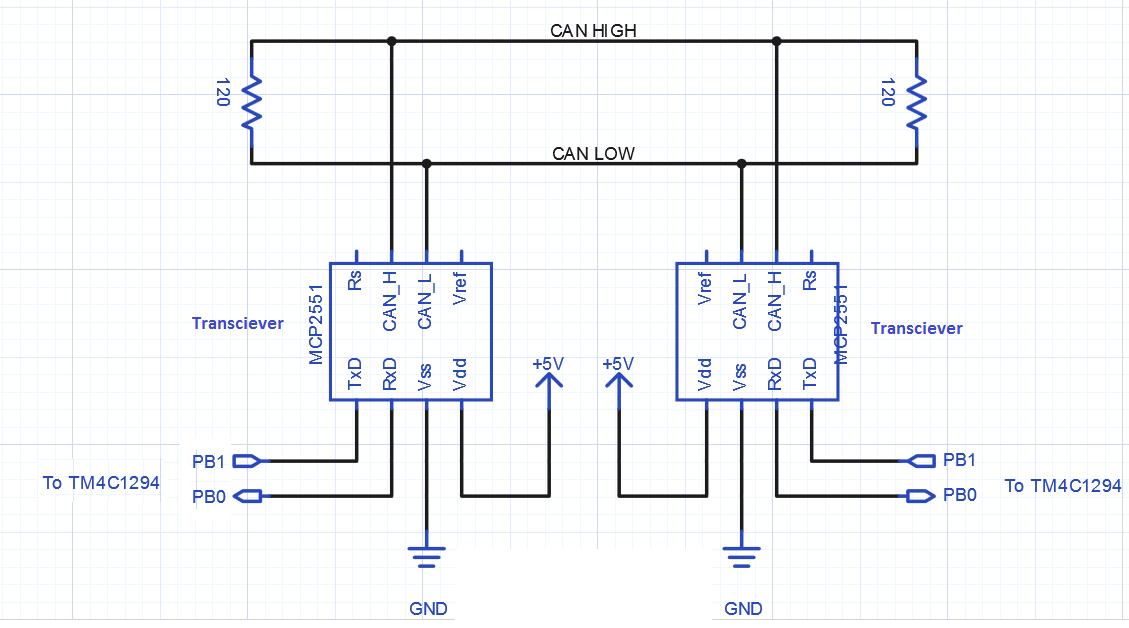

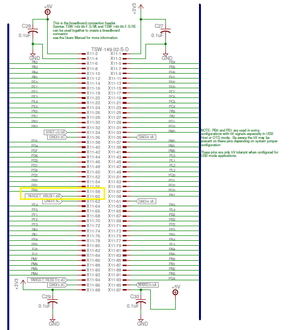

Attached is my circuit diagram:
Attached is the output from the terminal:
    I don't really spot anything wrong with your code. What type of errors are you getting when you call CANStatusGet() in the ISR? The type of errors can provide some clues.

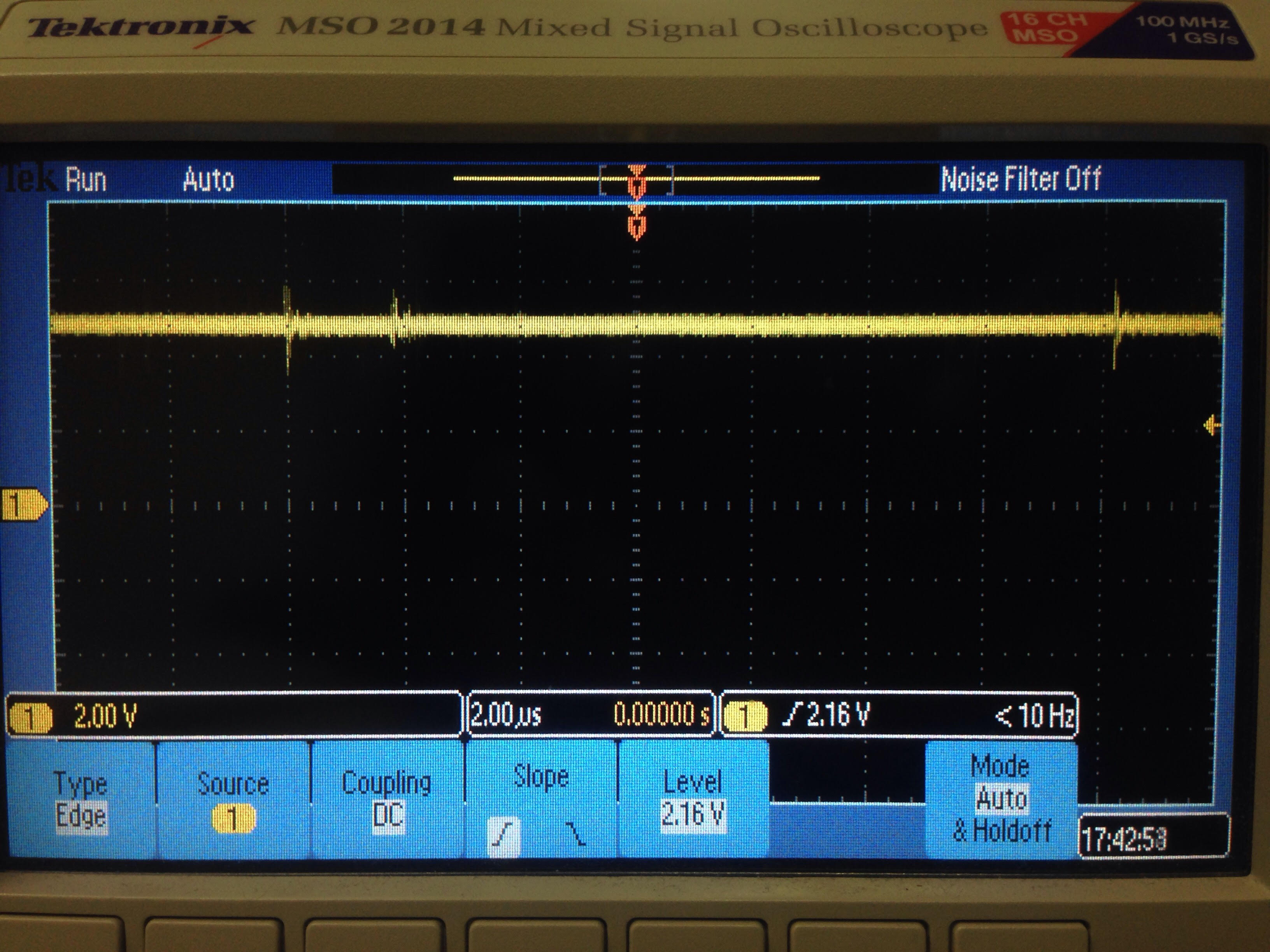

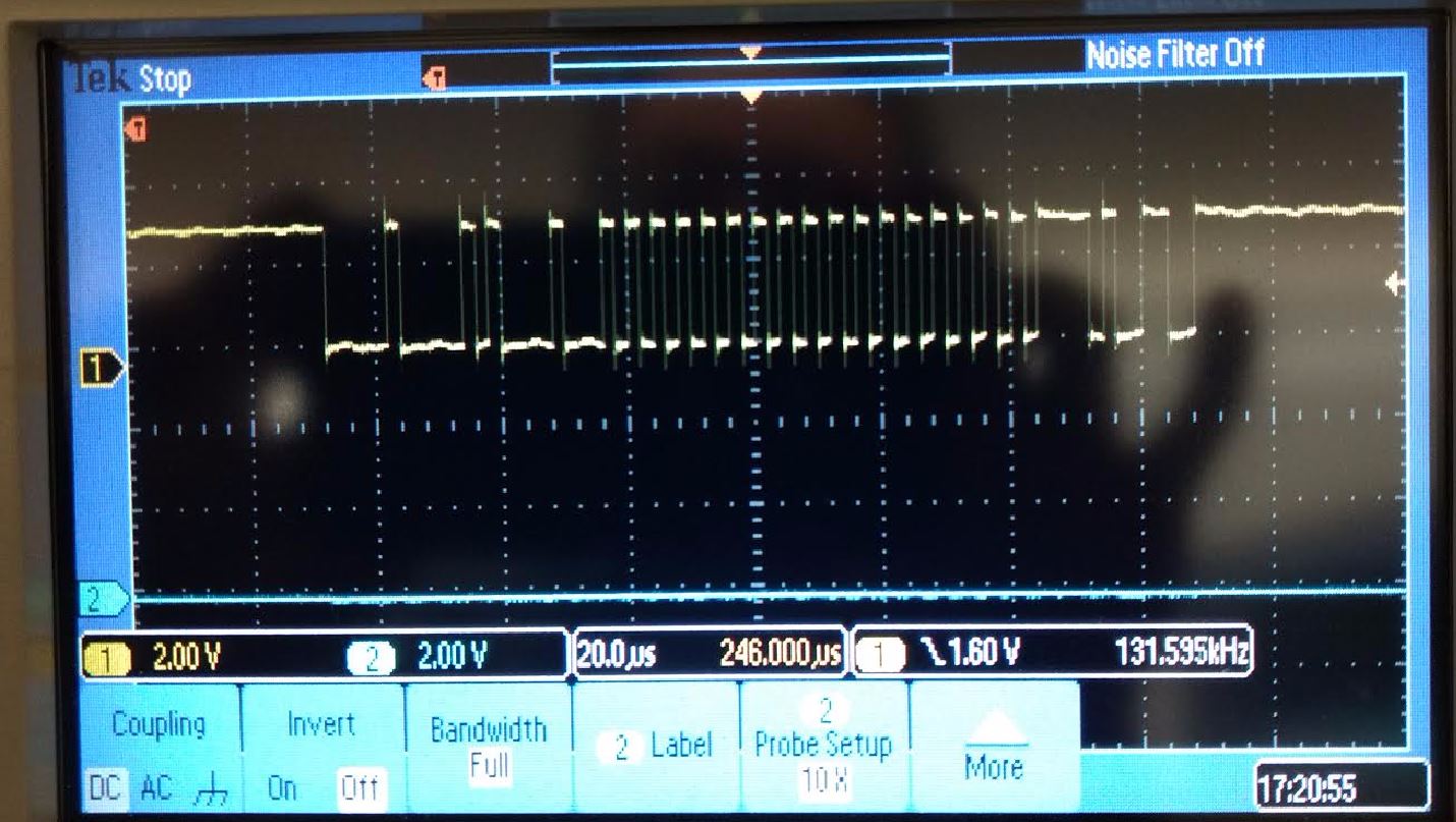

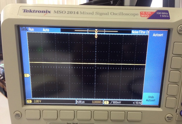

    What do you see on the CAN1_TXD pin on the scope?
    On your schematic you have the PB0 and PB1 directly connected to the transceiver. The transceiver is 5V while the MCU is 3.3V. Do you have level shifter in between?

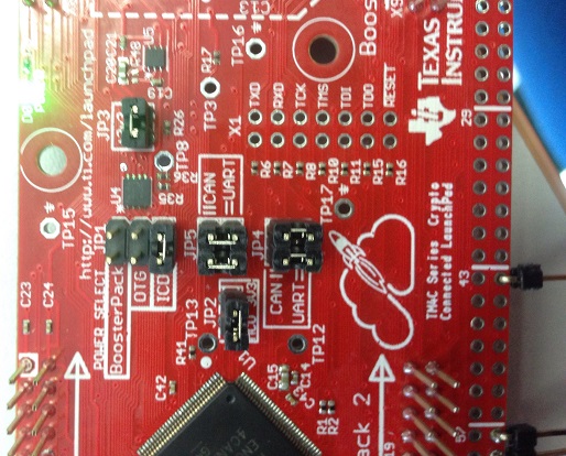

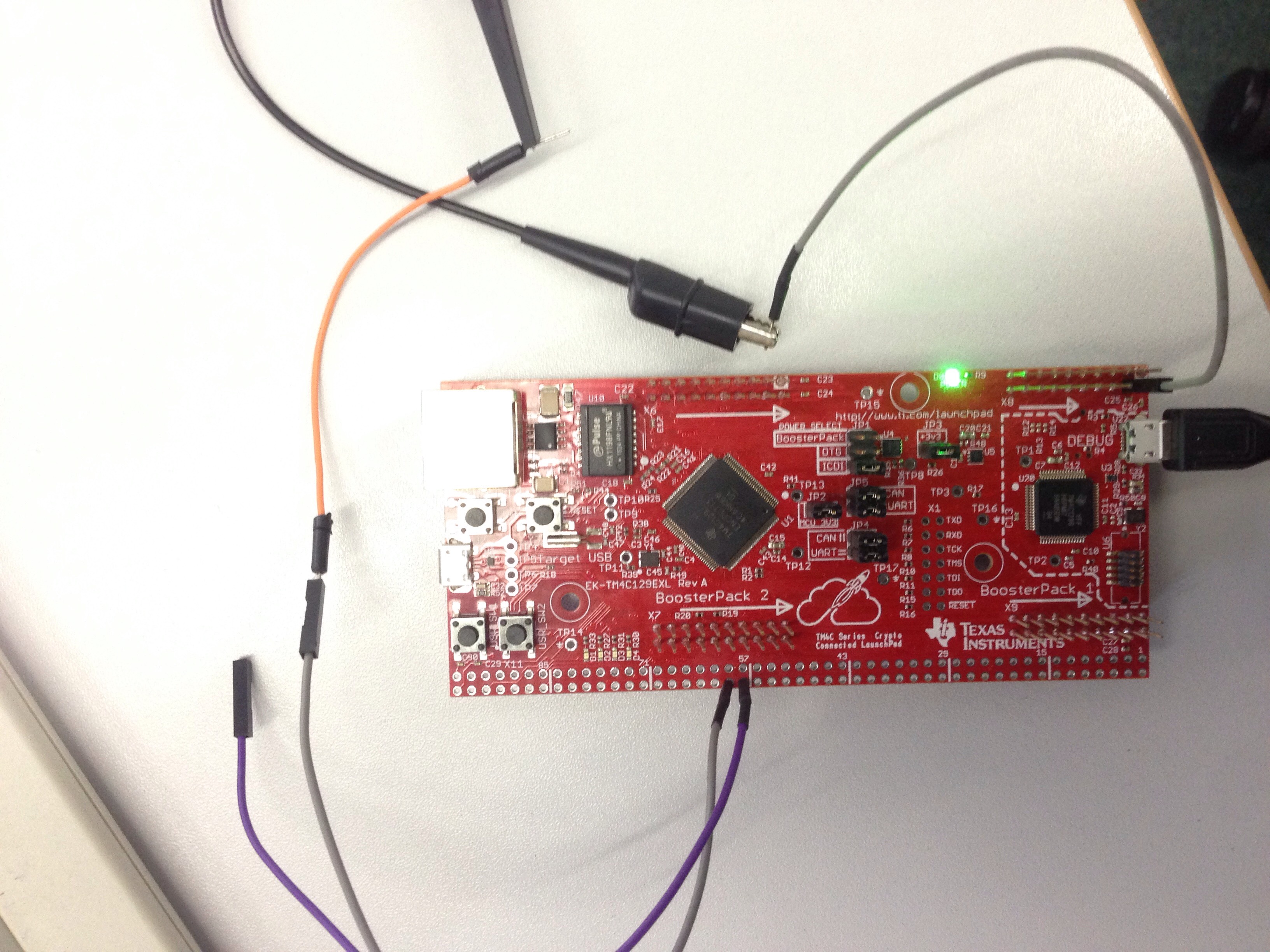

  • Hi Charles.

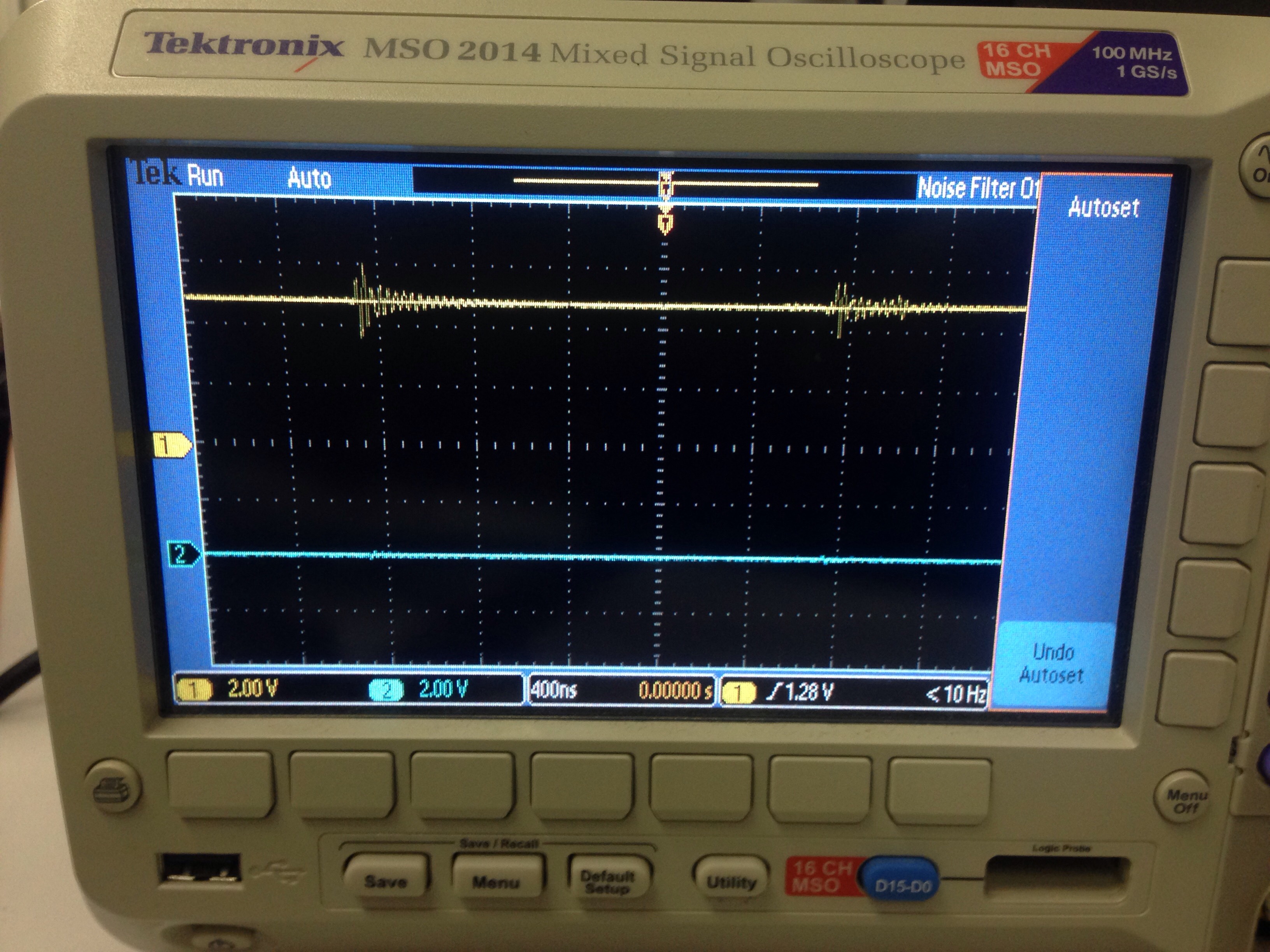

    Attached is the pics of the ISR and scope probed to CAN1_TXD (PB1) directly. Regarding the level shifter, do I actually nee one as from what I see in the link (ohm.ninja/.../), the author did not use any level-shifters for his TM4C1294 to transceiver connection. How can I confirm this ?

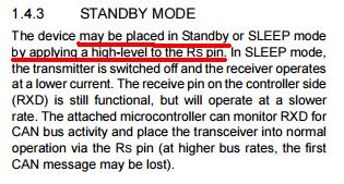

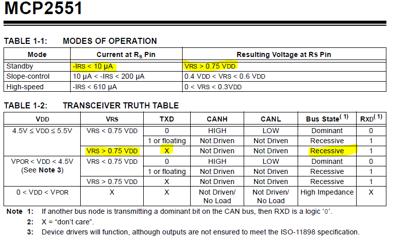

  • I think the problem may be your bus transceiver. From the Microchip datasheet, if you leave Rs open, the transceiver is in standby mode and will not transmit.
    If this solves your problem, tell my friends at Microchip they owe me one.
  • A few comments.
    As Charles says the use of a 5V IC on a 3V bus is iffy. It may work with careful attention to logic levels, especially if the IC is designed to accept 3V levels or it may fail completely.
    Second that wiring hookup is trouble prone especially for 500kBaud. Breadboard is best avoided.
    Third as cb1 has noted it would help to know what the status returns were. Not all are errors IIRC (I don't have a reference handy), and even if you are getting an error knowing which one matters.
    Fourth, you don't mention whether you have a receiver up and running on the other TM4C, that is required.
    Fifth, it is a characteristic of CAN that if the connection is faulty then the transmitter will shut down after a short period. You ned to scope immediately after starting. If you wait you may miss signs of activity.

  • Bob Crosby said:
    ... if you leave Rs open, the transceiver is in standby mode and will not transmit.
    May I note that vendor's Bob provided a great service by "digging up" such detail.    Good that.
    However - staff (seriously) combed MCP2551 data - and they could find "NO/ZERO" detailing of the (default) voltage level - impressed upon (unconnected) pin Rs!    (slope resistor)
    Instead - with all of our digging - we find (and present):
    Red highlight reveals that it is (likely) that a high-level "must be applied to pin Rs - to force it into standby mode!"
    Such is not a "sure thing" again "Nowhere" was the "unconnected voltage impressed upon pin Rs listed - w/in vendor's 24 pg. spec.     It is my belief that if pin Rs was "pulled up" - then the language (w/in 1.4.3 above) is superfluous - there would exist "no need" to "apply a high-level."
    In addition - should the Xcvr (actually) "default to standby" - it is likely that (many) would have been impaled - and poster reports (another's) success!
    It is my recommendation that user tie a 43K R between pin Rs and Gnd - such insures "active xcvr mode" w/reasonable signal transitions.
    Note separately - that the TXD connection between MCU & Xcvr - "will work" - spec accepts voltage down to 2V0 (thus TTL compatible) as "logic high."      RXD (xcvr output) may prove too high (nearly 5V) thus a 3:5 voltage divider should be considered.
    As to vendor agent's (outside) "friends" - they noted that their "mal de mer" has (almost) passed - and their (multiple) "rope burns" (from their enforced crewing) are expected (some day) to heal...   (maybe)

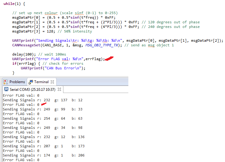

  • Hi Charles,
    When I tried my code today, I did not receive any errors (the error flag is not triggered). However, when I probed Tx (PB1) to the oscilloscope directly with reference to GND (without connecting to the transciever), I am unable to see any output on the scope. My JP4 & JP5 jumpers are in default condition (configured for UART). Are my oscilloscope settings correct (edge triggered, DC coupling) ? Attached is the screen shot of the code and the scope cap.

    Thank you and thank "staff" for also digging into the MCP2551 datasheet. (For once I am glad that it is not my datasheet in which it is hard to find important information.)
    I drew my conclusion from table 1-1 which states that if -Irs (current out of the RS pin) is less than 10uA the voltage on RS will be greater than 0.75Vdd. If there is no resistor on RS, the current out of the pin should be zero. Then from table 1-2, it shows that if Vrs > 0.75Vdd, that the can bus will be in the recessive state regardless of the state of the TXD pin. This is the issue the original poster is seeing.
    Bottom line, I am once again in total agreement with you. The original poster should try adding a pull-down resistor to the RS pin.
  • Hi Bob,
    As always - great to receive your "reasoned" response.
    While your writing IS logical - it does not address the datasheet's "highly specific" dictate to, "Apply a "HIGH LEVEL" to the Rs pin!"
    And - in addition (and as stated) would it not prove "unwise" to have such CAN device "Default to Standby" - which would (predictably) IMPEDE - most all users?
    A final "tack" - our poster reported "success" of the "ninja user" - who he (emulated) (i.e. copied) in avoiding the use of any connection to (devil) pin Rs!   (as revealed by poster's schematic)
    In conclusion - use of (suggested) ~43K pull down R - AND "dialing down the CAN Data Rate" (at least temporarily) should (soon) see our poster, "On the Air!"   (CAN-AIR to be clear)

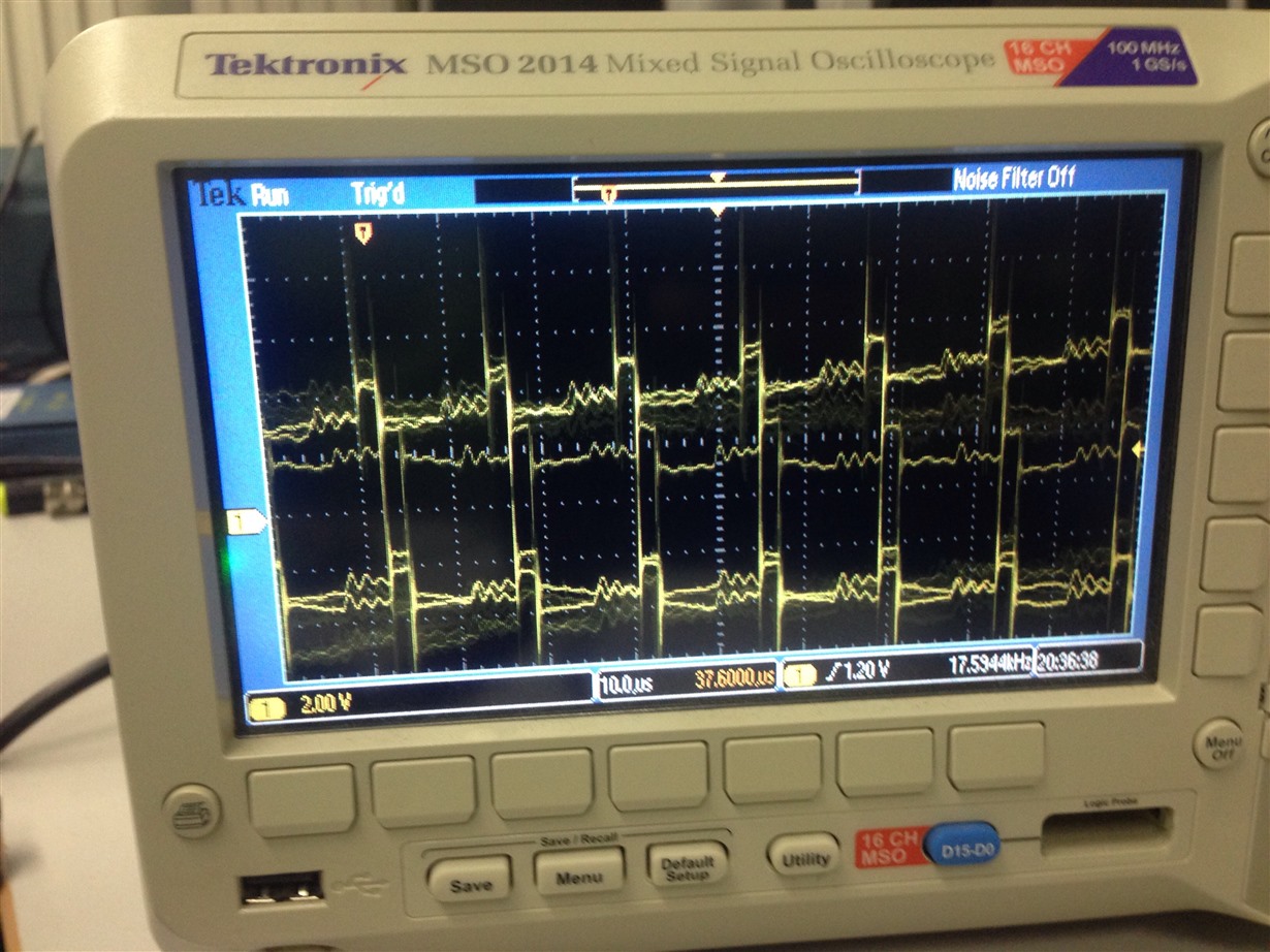

  • Hi Bob and cb1, although the error flag is not triggered anymore (the error i had previosly ), there seems to be no output from Tx pin of the launchpad. From the scope cap, the output stays high at 5V and doesnt seems to transmit any signal. (At this point I did not attempt anything with the transciever).
    It seems like you initialize the errFlag to 0 to begin with and somehow the ISR is not entered and hence you think there is no error. If ISR is entered then you would have printed out Triggered and Triggered2. Did you disconnect the MCU from the transceiver? The CAN module needs to monitor the RX pin so it can arbitrate the bus. As mentioned earlier you need to have a level shifter on the RX pin.
    It's troublesome that the output from a 3V device is at 5V.
    Robert
  • Hello Robert,
    Indeed - yet staff's "deep dive" into Xcvr spec reveals (~75K pull-up) impressed upon Xcvr's TX pin!
    This appears to suggest that poster's connection (MCU TX to CAN TX) is "non-existent and/or faulty" or the MCU has been improperly configured into CAN mode...
  • 75K pull-up might do it. Not sure how the output drive of the TM4C will react to that with its 5V tolerance.
    The OP should be seeing transitions even w/o a transceiver but only if the scope is attached before the program starts and there is not a significant post trigger hold-off.
    Robert

  • As an "even more basic, fact-finding approach" I'd suggest poster reconfigure his selected UART_TX (instead) into GPIO (push-pull) Output) then write code to toggle it at 5-10 Hz.
    Such should immediately reveal:
    • likelihood of connection integrity between UART_TX (MCU pin) and Xcvr's TX.
    • that such toggling HAS "awakened the Xcvr" and "Dominant vs. Recessive" differential output should reveal upon CAN Bus H & L.
    It has been (ONLY) assumed that connection integrity has been achieved.    And the (banned from here (KISS)) stands ready/able to detect - and deny or confirm - such outcome.    (you may note that both Robert & myself noted the 5V output - "claimed" to be upon the "interconnect between XCVR TX and MCU TX."    Instead - unless this is one of the "non-standard or USB pins" is not there reasonable expectation - that an ESD diode would clamp that 5V to a diode drop beyond (above) 3V3?    Absent such "clamping" as poster's cap revealed - there is either "mis-connect" or "damage" to that UART_TX pin - and "all here" continue the "endless, chase of our tails."    (which while fun - proves not terribly effective...)
  • Today's Story:
    1) The while loop seems to be working. However, the CANIntHandler is not triggered and count of message sent (total count) remains 0. Wierd. Attached the screen shot and code.
    2) dear cb1, could you provide me an example or reference for ' reconfigure selected UART_TX (instead) into GPIO (push-pull) Output) then write code to toggle it at 5-10 Hz.  '
    Again this is attempted without using any transciever and directly probing the tx to oscilloscope after the program is initiated.

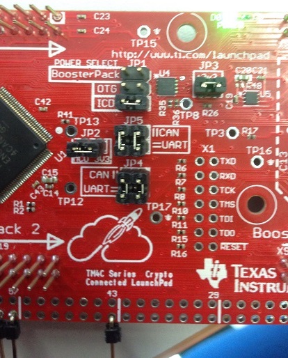

    The JP4 and JP5 jumpers are in default configuration since CAN1 is used instead of CAN0
    Hi Gowtham,
    JP4/5 are upside down in launch pad schematic relative targets MCU PD4, PD5 are available on BP2-X6 pins 9,11. Thus  PD4/5 of JP4/5 are on the X11 header pin 40 , X11-pin 38 and your picture shows CAN jumper wires on pin 58 and pin 60. UART0 of target MCU connects to ICDI UART0 via JP4/5,  UART0 jumpers can be turned sideways across JP4/5 headers to select MCU PA0, PA1 are for CAN0 out to BP2-X6 pins 9,11.
    X11 pin 60 =Target VBUS/1.6B
    X11 pin 58 = PB0
    X11 pin ? = PB1 seemingly does not exist....
    Likewise you have to do an alternate digital selection GPIO configuration where UART0=CAN0... I don't see that in your code...
  • Edit above post PA0,PA1 = CAN0 not CAN1 as shown in your code examples.
    1. Did you discover CAN1-TXD1 is not accessible on launch pad?
    2. Text source states to terminate all devices on CAN serial bus?
    Note: JP4,5 turned sideways [1-3], [2-4]; UART2 can be configured for Printf() calls via ICDI.

  • Hi Gowtham,
     I used your program. The only thing I changed was the msgData where I force the data to 0x55. You don't have the change at all. The only reason I changed was to avoid bit stuffing. All you need is to create an external loopback between X11-60 and X11-58 and probe the X11-60 on the scope and you should be able to see what I see. Earlier I was suggesting using internal loopback that is part of the CAN module's diagnostic tests.
    If you look at the scope cap I displayed it is proper until it fails the ACK. The message ID is 1. Since it is a '1' then the protocol will have to bit stuff after every 5 consecutive same states. The Identifier field is 11 bits. You then see the RTR/IDE/R0 bits equal 0 followed by the DLC which is a 4 (4 bytes of data to followed). In the data field you see 4 bytes of 0x55 followed by the CRC. The ACK field is recessive which is expected since I'm in loopback mode. The ACK normally is replied by the receiver to dominant state. I have not used transceiver here.

    CAN1_TX is accessible at X11-60
    According to the launch pad schematic EK-TM4C1294XL the X11-60 is (hard) tied to USB- VBUS and identified as such. Gowtham's launch pad looks identical EK-TM4C1294XL, not sure what 129EXL is in post title. Have to now wonder if that is even the same X11 header, if not why so different as that is not keeping consistent design principals in the very same family of launch pads.
    @Gowtham the control area network in my schematic (JP4/5) uses MCU CAN0 on PA0, PA1, seems EXL may have a different X11 header pin out I'm not aware of.

  • Hi All,  sorry for the late reply as it was a long holiday here in my country and hence, I was away from the oscilloscope.  Anyways I am able to reproduce what Charles have observed. My findings are as below:
    Case 1: When the program is executed WITHOUT external loopback, Tx goes high to 3V.
    Case2:  When the program is executed WITH external loopback, I am able to see CAN transmission.
    Is this behaviour expected ? Attached the relevent screen shots.
    However this seems to only works with one of my launchpad. For the other 129EXL launchpad, the CAN1_Tx seems to be high at 5V always. And ISR seems to be only triggered  when it is in external loopback configuration for this particular launchpad. Is this behaviour may be due to the TARGET_VBUS that BP101 has pointed out ? How can I confirm this, or debug this issue ? (attached also the terminal output for CANStatusGet). Also to be noted is that by probing to CAN1_Tx alone (without GND), I am seeing some square like noisy waves. Could this be CAN signal? (attached also this scope cap).
    P.S1:CAN0 seems to be not working with both my launchpads (Let me DOUBLE & TRIPLE check before confirming it here).
    P.S2: Good to know the ninja code is working fine and I hope camper will forgive me for still using the ninja code since the well tested vendor code is also producing the same outcome in this case.
      Glad that you are making some progress.
    Yes, I think this is expected. Without the loopback the RX input just stays high. The CAN controller will immediately detects this is a bit-0 error.
      What is the third scope shot with the noise? Is this from the good board that you were showing in the second shot or the bad board which is stuck 5V? In your second shot the signal was quite clean. I'm confused. Which board is it? Is this with the transceiver connected or not? In you scope can set the trigger mode to Single?
  • Hi Charles,
    Thank you so much for your help so far. I am glad too.
    Charles Tsai said:
    Are these two boards the same 129EXL board? Please also check all jumpers if they have the same settings. I assume for the one with the TX stuck at 5V you are also in external loopback, right? Can you show a scope shot where it stays on 5V? Can you also probe the state of PD6? If you force it low, will you see a difference on the TX? When the PD6 is high, it enables the switch to supply 5V power onto TARGET_VBUS.
    Yes. they are the same. The jumpers are in default setting. Yes I tested them both in external loopback configuration without the transcievers ( directly connected to oscilloscope). Initially Tx is high at 5V, but the very moment I touch PD6 with the oscilloscope's probe, Tx becomes low at 0V. Again it becomes high at 5V once the probe is removed from PD6. (PD6 remains low).
    The board with the blue jumper and jumper wires is not faulty:
    When Tx is at high at 5V (channel 1 is tx, channel 2 is PD6), PD6 is not connected to probe here :
    Tx goes low when pd6 is connected :
    None of this occurs with my other launchpad. The other launchpad works fine regardless if the probe is connected to PD6 or not connected. (PD6 remains low). Wierd.
    Socpe cap of the working launchpad :

  • You jumper setting is correct in order to bring out CAN0 on PA0 and PA1. Did you connect the PA0 and PA1 as a loopback? Did you run the TivaWare Example for CAN0? I ran it and was able to see the same waveform as before using CAN1.
