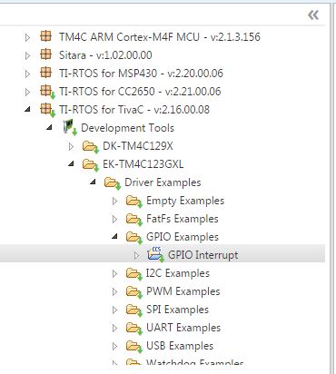

I have some questions about how to run a function after triggering a GPIO interrupt. I have gone through the GPIO interrupt example and I had some issues modifying it to work with what I want to do.
