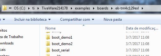

    The set of examples are:
    - boot_serial (the small project that does nothing but getting the target ready to receive firmware via UART0)
    - boot_demo1 (a simple demonstration program that blinks a led, but also diverts execution into the bootloader area when a switch is pressed)
    - boot_demo2 (similar)
    They are all available in the tivaware examples folder, particularly for the /boards/ek-tm4c129exl set of examples.

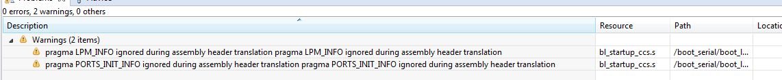

    The weird warning were:
    Neither of these 2 macros were found anywhere on the E2E forums this morning.
    Bruno

  • Just got a reply regarding the mysterious warnings:
    "You should not get those warnings.  This is a bug in the assembler.  I can reproduce the problem.  I filed CODEGEN-3843 in the SDOWP system to have this investigated. You can avoid the warnings by disabling ULP advisor.  In CCS, right-click the name of the project and choose Show Build Settings.  Then use the screen shot below."
    (Project properties -> Build -> ARM Compiler -> ULP Advisor -> uncheck all)
