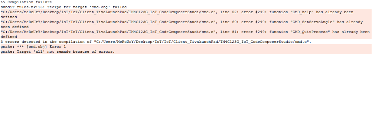

CCS/TM4C123GH6PM: Error #249 function "CMD_help" has already been defined.
Part Number: TM4C123GH6PM
Hi
I want to transmit data from TM4C123GH6PM to mobile phone using ZIGBEE Wi-Fi module. But compiling code in CCS, I am getting 3 errors (all are similar) function has already been defined.
cmd.c code

Here i am attaching the screenshot of console window.
Any help will be highly appreciated.
  • Well, somewhere you have already defined these. You may need to have the compiler output the preprocess code to see where.
    This line
    Himanshu Goswami said:
    #include "main.h"
    Is decidedly odd. Not necessarily wrong but odd. In a code review I'd probably insist on a rewrite.
