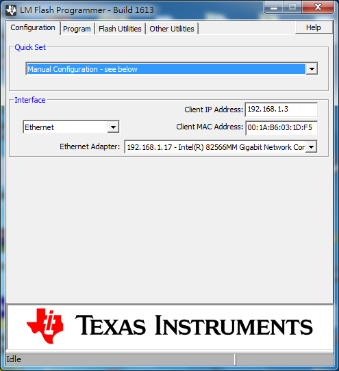

  • Hi Ralph,
       I modified the "enet_io" as static IP address: 192.168.1.3 and added the "swupdate.c" ....  for firmware update  (it's work), and set the application address 0x4000,
    set the "boot_emac_flash" to address 0x0000.
    I do the following
    Step 1.
    step 2.
    I traced the code when I pressed the "Program" button, the code actually receive some packet form PC and enter to SoftwareUpdateBegin(g_ui32SysClock);
    It seems the boot_emac_flash out of work in static ip address ?
    Please give me some advice.
    Thanks & Best Regards
    Leo Liao

  • Hi Charles,
    My product in the Ethernet IP option allows the user to choose to use static IP Address or DHCP to obtain IP Address, That is, I have to support both Ethernet Firmware Update in both modes. My question is how to implement firmware update by Ethernet in static IP mode.
    Best Regards
    Leo Liao
  • Hi Leo,
    Where did you specify the client static IP address? It looks like you need to add/specify the static address as in
    psBOOTP->ui32CIAddr = <your static address>; // in the SendBOOTPRequest() function in bl_emac.c.
    By searching the forum I have not come across with anyone trying to use the BOOTP with a static address. Even though this is supposed to work, you may be the first one to try it. Let's us know your result.
