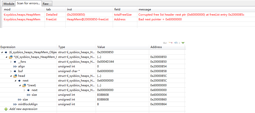

I have a board with SDRAM at 0x60000000 and size is 8M and a memheap is dynamically created on the whole RAM. Originally HeapTrack is not enabled in .cfg. Today I enabled it trying to debug, and found that ROV detected the heap is corrupted. Please see the snampshot below for details.
The code to create heap is:
int NonCriticalMemInit(void)
  HeapMem_Params prms;
  Error_Block eb;
  Error_init(&eb);
  HeapMem_Params_init(&prms);
  prms.size = GetSdRamTotalSize();
  prms.buf = (Ptr)GetSdRamStartAddr();
  heapMemNonCritical0 = HeapMem_create(&prms, &eb);
  return NULL != heapMemNonCritical0;
If I place a breakpoint at the last line of the above function, I could see the error in ROV. So does it mean HeapTrack can't work with SDRAM, or is there anything wrong when creating the heap?

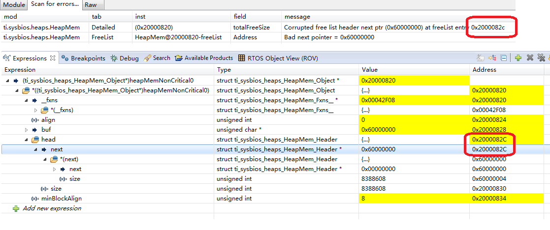

  • Please see the update snapshot. The value of "heapMemNonCritical0" is 0x20000820 in this new snapshot (and was 0x2000850 in the old one. I don't know why the value changes today.
    Yes, Heaptrack is enabled by "BIOS.heapTrackEnabled = true;" in .cfg.
    There are two instances of heap, one for default and the other for the SDRAM.
    The ROV detects this error immediately after the heap is created, without any alloc and free.
  • Can you view 0x60000000 in a CCS memory browser? What are the first two 32-bit words at that address (I'm assuming it will be zero and 8388608) ? I'm thinking that ROV does not know that memory exists and therefore cannot parse it. Do you have that memory in your linker file?
    Todd
  • Yes, you are right. They are 0 and 0x800000. SDRAM is not in linker file.
    If I add SDRAM into linker file, there is still error.

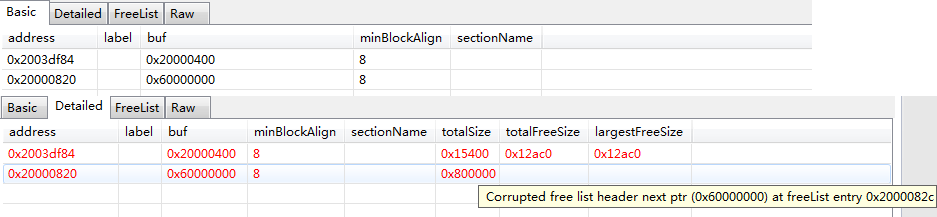

    After the SDRAM heap is created can you get snapshots of both ROV->HeapMem ->Detailed and ROV->HeapMem ->Basic and attach them.
    Todd
  • 1. SDRAM could be used. I have been using it for years and things seem fine.
    2. When heaptrack is not enabled, there is still such an error. But it looks fine to use API to get heap status, such as "HeapMem_getStats"
