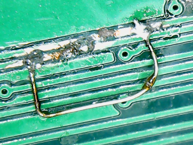

Aside from bit-banging the SPI bus and from redoing the PCB, are there any other fixes? Can I just move one pin function to the other and be done with it?

    Feel your pain - and agree w/vendor about the "unpleasantness of your position."      You must realize that when the SPI module is declared & employed - you "lose the bi-directional capability" - which those pins enjoy when configured as "normal" GPIO.    (i.e. in SPI mode - pins "are what they are" - which is "SPI-based,unidirectional.")
    Bit-banging may "Save your existing board" - yet the loss of the automated & extensive SPI signal handling - may come at high cost.    (as always - much depends upon the "fine details" of your (unique) application.)
    As to "other fixes" - while crude - firm/I have "rescued" a few hundred "whoops boards" - especially when "2 adjacent pcb traces" had been "switched."    If the traces "parallel track each other" and both appear upon the same (outer) board layer - is it not possible that a pair of careful "Trace Slices" and "insertion of properly sized/placed 0Ω smt resistors" - enable the "swap of such signals?"    Much depends upon the board's density - and its operating environment.    Such "signal swap" is NOT Recommended when "temperature variances are large" or board "shock/vibration" are expected.
    If you are lucky - and the board allows such modification - the end client may never note your hiccup ... nor your inspired fix...
  • Thanks for these answers. I've bit-banged an SPI bus before because I was dealing with an ASIC that had some whoopsies in its design too. On this board I will be talking to 6 chips via SPI and it will be in my best interest in making the board modification and continuing to use the hardware SPI.
    I can access the traces pretty easy on this board and will be making the swap with a little spaghetti followed later by another spin of the board, it will not be a problem.

  • yep, it's already done, all part of the job. Everything is now working.
  • "Oh my" ... Be still my heart!      May I note that use of (say) 30 gauge, teflon insulated wire-wrap wire (may) prove more robust?
    I'm fearful that the photo shows an uninsulated wire - which overlaps a via (which may "challenge" the solder mask's insulation at/around via's edges.)
    The suggestion of a "surgical trace slice" appears to have (given way) to (pardon) "trace amputation."    (it almost appears as if the traces were, "burned into compliance" - rather than "surgically sliced.")
  • hahaha, yep :-D the wire is ever so slightly off the surface, it works perfectly just don't touch it hehe. the picture doesn't do quite justice because it's from a crappy usb microscope. don't worry, this will all be gone in the production version.
