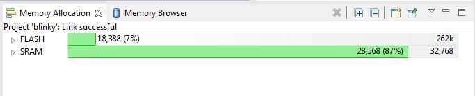

Hi All,
I am trying to run a particular code which needs more than 32,768 bytes.
Is there some way I can use the blank memory (93% of FLASH 262kbytes) as shown in the image below?
Is there a way to partition the memory as per user's need? If yes, which file should I update?
Thanks in advance for your help
    Your post reveals - but does not explain - that the 32KB memory limit describes MCU's SRAM.     The blank memory is FLASH - which cannot serve the same role as SRAM.
    You speak to, "partitioning" - which is possible - yet, "Fails to extend SRAM beyond the MCU's listed (32KB) limit."
    Instead - would not "focusing your attention" more upon which variables "truly/really" demand, "Placement w/in SRAM" - prove a better path?    To assist such focus - might you re-examine your criteria for, "Placing and/or Declaring/Defining objects - so that they (likely) become SRAM resident?"    (for example, if a function's parameter block (variable) is unlikely to change, you may "hard code it" - and escape resulting SRAM usage.)
    You may also consider MCU's EEProm - yet penalties accrue - and errata notes are many.   (and foreboding)    External EEProms prove faster, easier & more robust.    (thus superior!)    This vendor produces a rather unique, external RAM device (fram) - your search enables its consideration.
    MCU's Flash is a (less likely) alternative - may allow (some) variable storage - yet w/ very significant speed, code size & complexity penalties.
    Other MCUs - which vastly exceed 32KB SRAM - may also "Ping your radar."

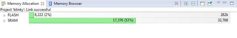

  • I have looked into the TM4C123GH6PM manual and a relevant post here about using FLASH memory to store data and read, which had a few pointers to motivate me not to spend time in it. (Since I'm on clock for this project... anyway!)
    Mentioning those points here :
    1) it will slow down the process
    2) limited FLASH erase cycles.
    I have somehow managed to bring down the SRAM usage to 44% using the same arrays for different data storage at different time. (NOT tested yet... will update the result here once done!)
    So I am not posting a new thread for Flash memory read/write
    For readers who would like to know more in this context can google it I found only 1 such post regarding this.
    Thank you :)

    Earlier I had used different arrays for each succeeding stages (smoothening -> multiplier -> filtering) which consumed trice the space. now I am updating a dummy array in each stage at a cost of few more variables (not arrays). helped me reduce the requirement.

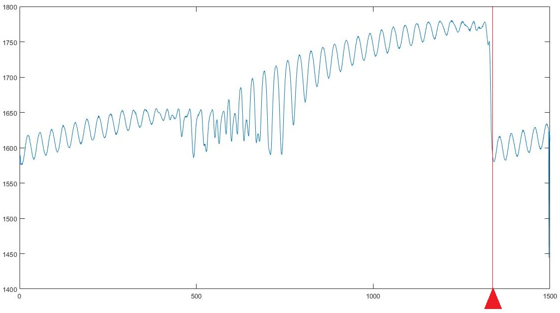

  • Hey all
    I know that below given query isn't related solely to this POST TITLE. But still I am posting it here because in earlier post I have provided the code snippet (almost full) and now starting a new thread for the below query felt unnecessary to me, as it is not much technical based.
    So,
    The query : - I want to start reading the ADC values at the falling edge as shown in the image below. Relating to the code given in earlier post, can anyone suggest  any improvement to do that? Only the ADC data acquisition part, and not the smoothening and later stuffs
    The signal is periodic so should look like a ramp-like signal starting from the lowest point and at the end it wouldn't matter if the full ramp is covered (or, may be slightly more/less than 1 period of ramp-like signal)
