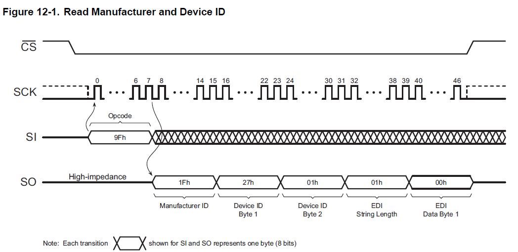

Hi
I am trying to talk to a SPI Flash Memory AT45DQ321 using the TM4C123 Launchpad.. I couldn't get the ID. Could someone please give me feedback on my code below. I'm using SSI2 on port B.
Thanks.
AJ

  • By the way, I keep on reading zeros for all the bytes
  • Hi AJ,
    I took the liberty of updating your post. I changed the subject line and I used the "Insert Code, Attach Files and more..." button </> to paste your C code. Changing the subject makes it easier for someone else to understand what the post is about. Using the </> button to paste the code makes it much more readable. The more people in the community that can easily read your post, the more help you are likely to get.
    Did you look at the SSI2 signals with a scope? I built a project using your code and I see SSICLK, SSITX and PB5 used as CS coming out OK. I would double check the hardware connections to the AT45DQ321.
  • Hi Bob,
    Thanks for the response. I appreciate it. I actually figured out what was going on. But the real problem was R9 and R10 on the launchpad. Turns out there is a jumper connected to PB7 and PB6 to port D pins for MSP compatibility. I took those resistors out and I was able to get bytes in. The only thing that bugs me is that the first ssiget right after sending the op code returns 0x00. I get the first actual ID byte 1F after that after sending the first dummy byte. I was under the impression that id get 1F right after sending op code. Any thoughts to why this is the case?
    Thanks once again
    AJ
  • AJ_ee said:
    I get the first actual ID byte 1F after sending the first dummy byte.   I was under the impression that id get 1F right after sending op code.
    As you, "Put" to Output the "Op Code Byte" (0X9F) - the Slave's output is "high impedance."    Yet this "non-data" does arrive at the MCU's SPI Port Input.    And then - at your first "Get" - it is this "garbage data" (0X00) - which your MCU store's w/in its FIFO & presents via "Get."    Your next "Put" (dummy data) then properly acquires your Slave's "Manuf. ID (0X1F)" - placing it too w/in the FIFO.     Thus it appears that you may either "Accept this single byte offset - or discover the means to "clear the SPI FIFO" prior to your first "Get."

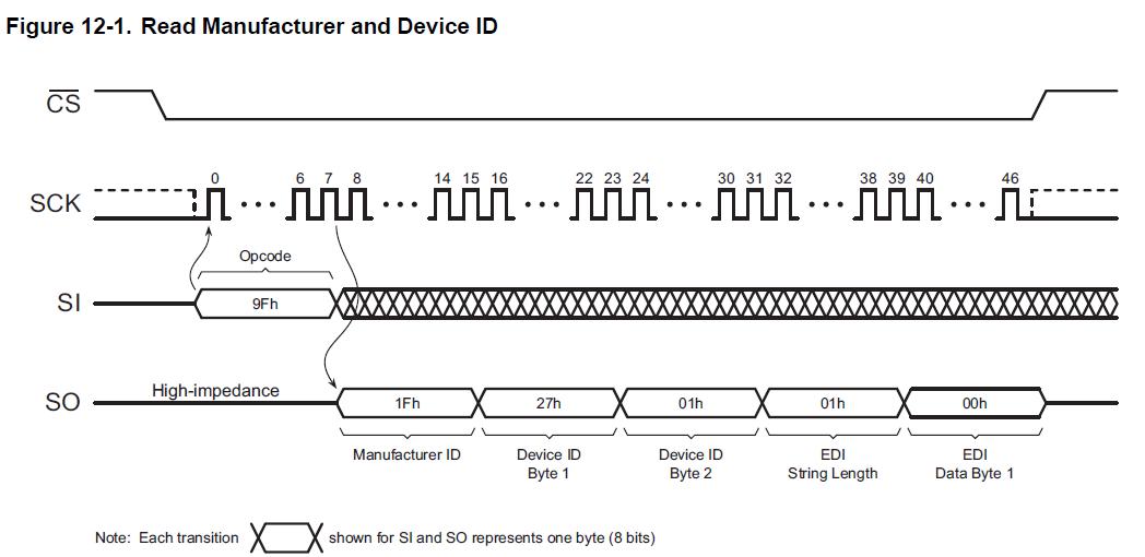

    Here's a key extract from poster's (very desirable) device (again it contains over 1KB of fast static RAM - which may be "auto-transferred" to EEProm - without slowing the "Write to RAM!"
    My point in introducing this device's timing diagram is to show that, "Should both "PUTs" and "GETs" output 8 SPI Clocks - we are (needlessly interweaving) "Garbage bytes" - w/in otherwise pristine SPI Received Data.   That cannot be good - and may be avoided if an "SPI GET" is able - on its own (minus use of the earlier PUT) - to generate the 8 SPI Clocks - as required by the diagram, above.
