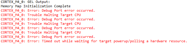

    Another issue I'm facing with my custom board is that  while waiting to get IP after DHCP enabled messages appear in console, it shows following message in console after 15-20 seconds when I run the code.
    I could not understand why such debug port error occurs and I also want know about  this error CORTEX_M4_0: Error: Timed out while waiting for target powerup/polling a hardware resource.
    I think before my custom board would send out a discovery broadcast it gets above error.
