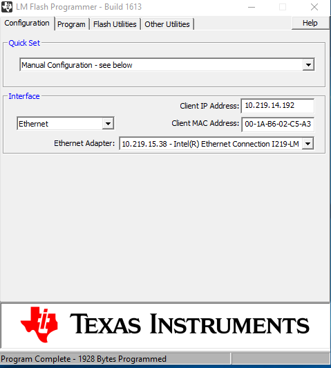

    On your development LaunchPad can you do the below?
     1. In the Configuration tab, go to the Quick Set and select TM4C1294XL LaunchPad
     2. In the Flash Utilities tab, click the Erase button to erase the flash.
     3. Go back to Configuration tab and under the Quick Set select Manual Configuration. Under the interface select Ethernet. Provide the IP address and MAC address. See below example. You will have your own MAC and IP addresses.
      4. Under Program tab, select the .bin file that you want to download to the MCU using the ROM bootloader. I just tried to download a blinky example. You can use the wireshark to monitor the traffics.
      5. Click the Program button.
  • Ok, the issues i found are:
    I have one bad board oo 12 that does not issue BOOTP. (Don't you know it was the board I worked with from the beggining). That's why we build more than 1.
    We had an older build of lmflash (1470) that does not support TIVA. After upgrading to build 1613 lmflash works properly now on our boards and the launch pad..
    Oh ya.. thx for the responses. You have no idea how helpful it is to have someone knowledgeable to bounce ideas off of.
