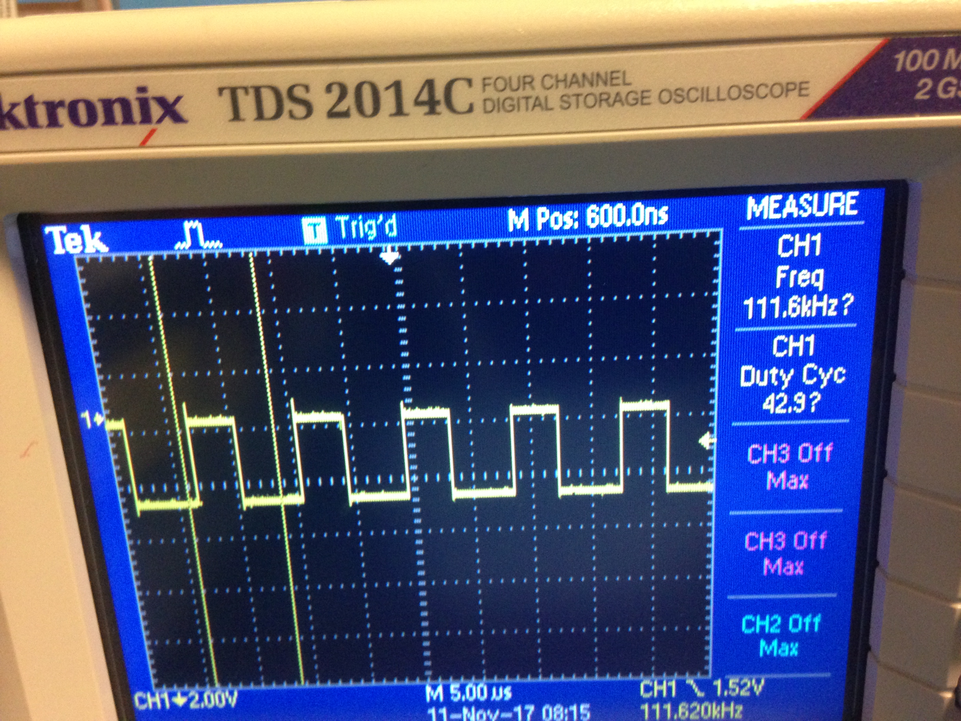

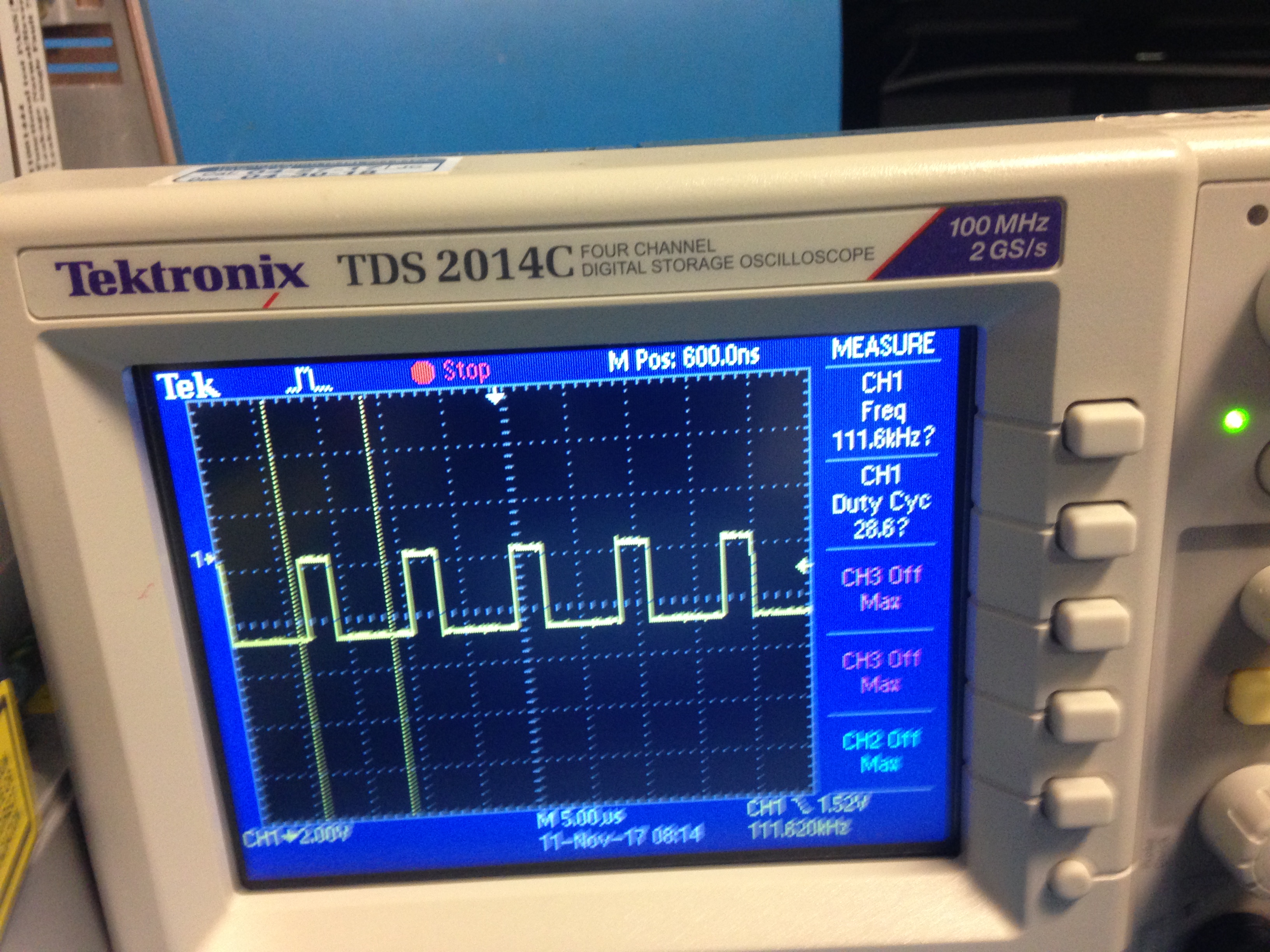

  We are using your RM48L952zwt platform with the HalCoGen 4.03.00 generated drivers and based on a sample function we got from TI a few years ago. Our hardware teeam dicovered that the waveform does not match the transmitted settings. i.e., screen shot pwm duty cycle = 37 and freq = 100, the waveform generated has a duty cycle of 28.6
or if pwm duty cycle set to 38 - 40 and freq to 100, the waveform has a duty cycle of 42.9:

  • Hello Tammy,
    Please clear hr_lr bit to use HR delay. This will improve the accuracy of the duty cycle.
    For example, VCLK=100MHz,
                          hr=1 --> HRP = 10ns
                          lr=32 --> LRP= lr*HRP = 320ns
                          Frequency = 100Khz, p=10us --> CNT_Max=31.25-1=30  --> real period = 31*320=9920ns --> frequency=100.8Khz
                          If duty cycle is 37%, the ECMP data field is: 31*(0.63)*128=2500=b1001_1100_0100  --> HR delay will be b10001=17 HR clock cycle = 17/32 LRP
    If the hr_lr is SET, don't use HR delay
                         the duty will be about 19/31= 61.3%  (or 38.7%)  where 19=b10011
    If the hr_lr is cleared, use the HR delay:
                         the duty will be about (19+17/32)/31= 63%  (or 37%)
    Where are your settings in your HET code?
