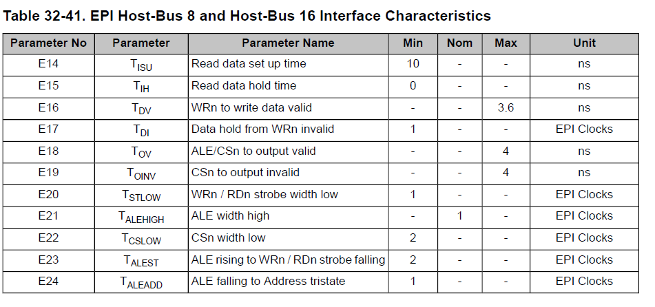

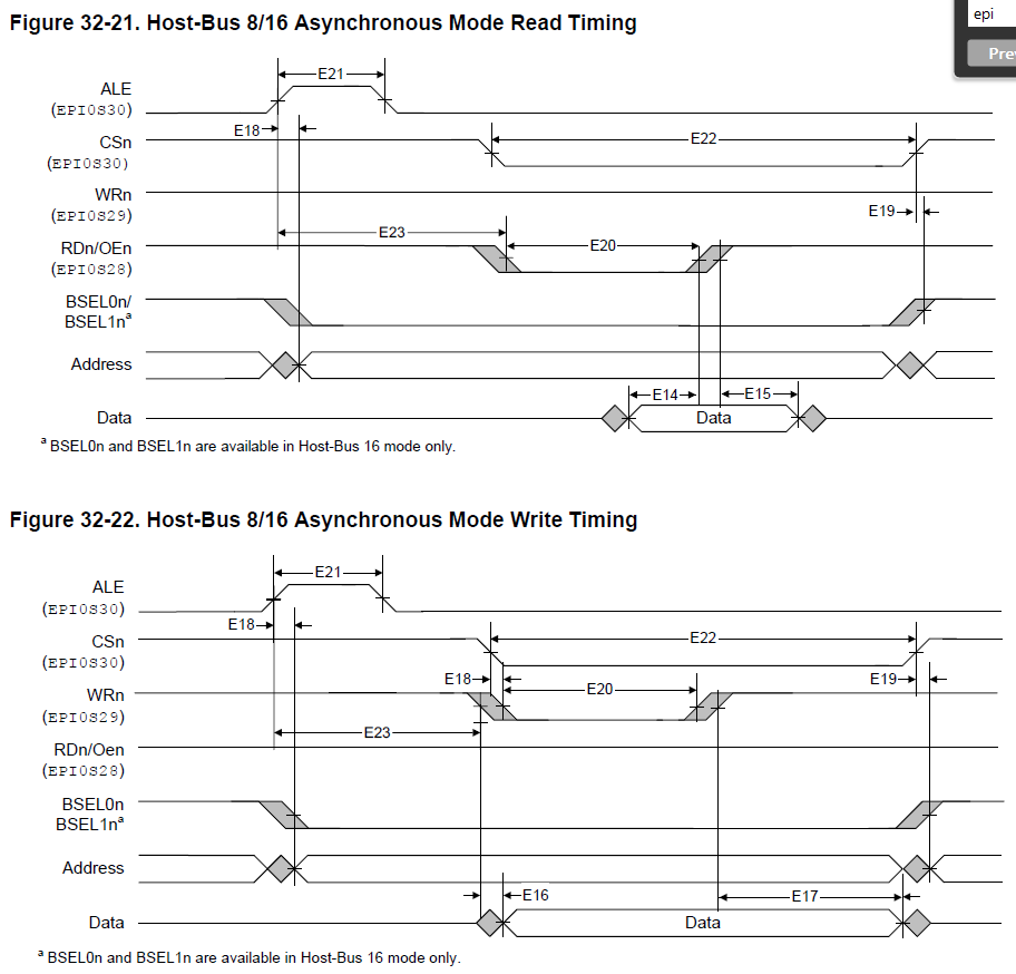

  • Hi Aaron,
    There may be some timing problem. You need to check if the  EPI is properly configured to interface with the MRAM. Please make sure all timings are met for the EPI interface. For example, are you meeting the setup time requirement on E14 parameter? You can find the EPI host-bus 16 interface characteristics in the datasheet electrical characteristics section. Below is an excerpt.
    Please also use the scope to capture the interface waveform and see if any abnormality on the signals. Timing problems may be due to long traces on the pcb board. Check if you have proper transmission line termination or otherwise some unwanted ringing/reflection may be evident.
