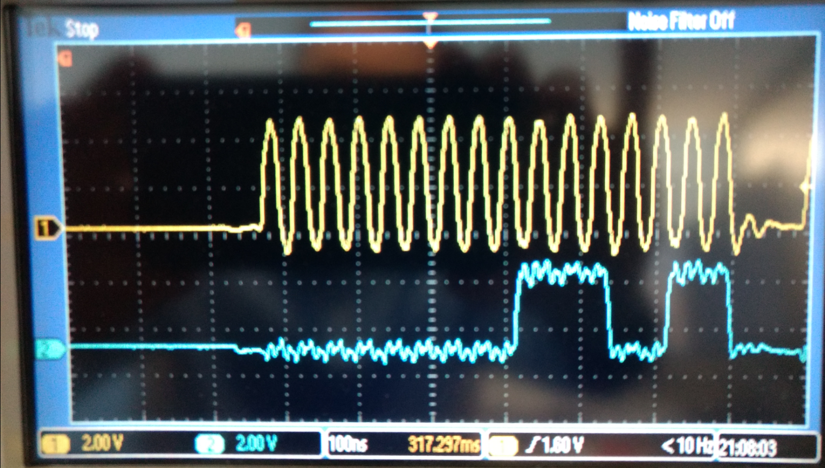

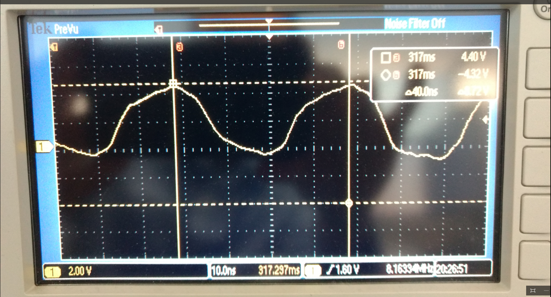

  • Hello Robert,
    Thank you for the reply.
    Here is my scope picture, where am probing the SPI clock pin (PD0) as am using the SSI3 module.
    I also checked the corresponding registers for clock setting. As per the datasheet;
    SSI_Clk = SysClk / (CPSDVSR * (1+SCR)), where my CPSDVSR is currently 2 and SCR is zero! So giving an SSI_Clk that is SysClk/2 = 25 MHz.

  • Hi Charles,
    I tried also the statement you suggested;
    SSIConfigSetExpClk(SSI3_BASE, 50000000, SSI_FRF_MOTO_MODE_0, SSI_MODE_MASTER, 25000000, 16);
    I still get maximum 10 MHz!
    I tried this on different SSI modules (SSI0/2/3) and I also tried on different board.
    Karim

    I ran this example and the scope shows the SPICLK is 25Mhz. My timescale is 100ns per division and you see about 2.5 clocks in each division.
    Below is the zoom in view with the measurement of the clock and it shows 40ns.
  • Charles,
    At such speed - the waveform may better reveal if the (assumed) scope's (~3") ground probe (lead) is removed - and a (minimal length) "grounded wire-loop" instead - directly attaches (encircles) the probe's metallic body.
  • Hi cb1,
    You are exactly right. I forgot to connect the probe ground on the TX pin (the bottom signal). :-)
  • It is, nonetheless, a good illustration of why these signals should not be treated lightly once you approach these speeds Charles. SPI requires that the data be stable during the clock rise and fall.
    Robert
  • Hi Robert,
     I agree. Here is scope shot after proper grounding.  I have the TX/RX tied together and the receiver is receiving the data correctly.
