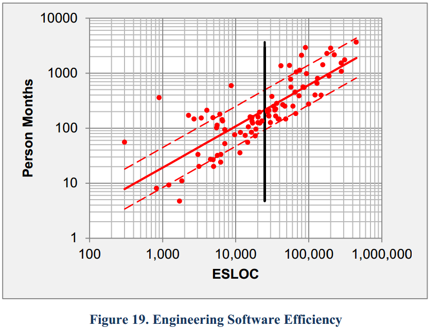

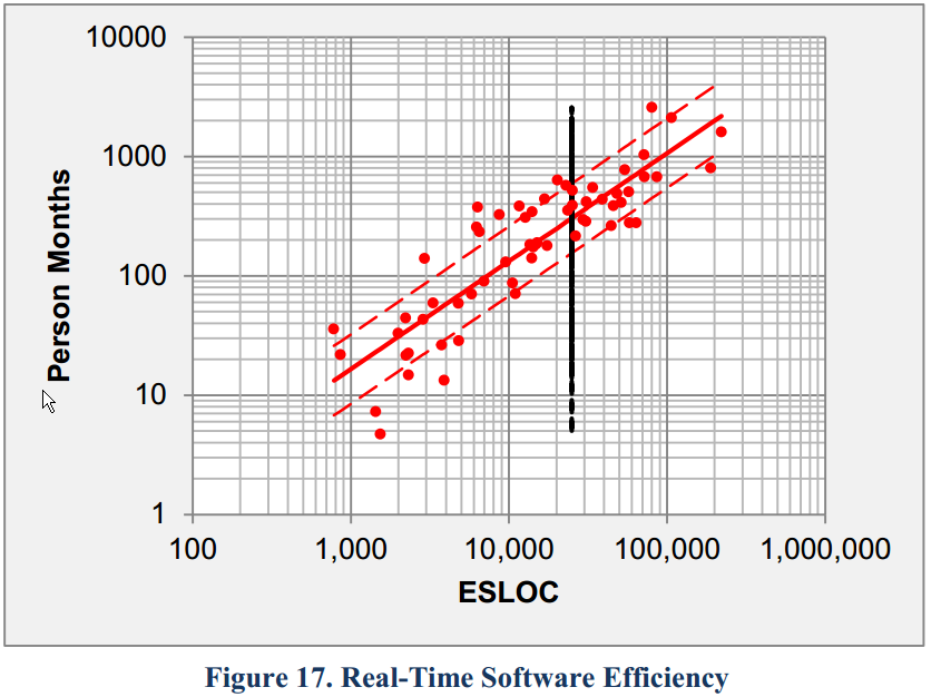

    An additional note on productivity (and why debugged libraries are worth using). The oft quoted rate for code is 8 to 16 SLOC (Source Lines Of Code) per day1. Some people will do less, some more. Student project can be more 'productive' since they are not producing a product but just rough prototypes. Since you are producing a large project on a short time frame you might want to consider this in your estimation of the effort you want to put into DRM init (I would be surprised if you are approaching the low end of that estimate currently).
    Now lest you think that estimate is too pessimistic SEI (Software Engineering Institute of Carnegie Mellon University) has studied a large number of projects and published the report2. Their results are interesting.
    •  real-time software  1.5 months per KESLOC
    •  engineering software  1.3 months per KESLOC
    •  mission support software  1.3 months per KESLOC
    •  automated information system  1.1 months per KESLOC
    KESLOC (Thousand Equivalent Source Lines Of Code), months is person-months. I suspect your project would fall under what they labeled as engineering software. Now this does vary with project size and with the organization. They have some graphs to show that.
    Lower person months per KESLOC is better.
    Note that these are log/log plots and also note that the disparity between the best and worst performers.
    So even given that the source of this data (pretty much by necessity) is government contract how well do you think you can compare? SEI is quite open about their sources and methods and do comment about why they chose the data set they did and the effect it may have on the conclusions.
    Robert
