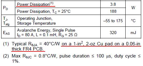

  • Note too that "any" such: "Junction to Ambient spec" is dependent upon (additional, external considerations) - and thus a, "universal spec or measure" is (unlikely.)
    For example - here is an extract from this vendor's newer Power FET.     (a device in which such "RφJA" is of great interest/importance)    (highlight mine)
    It should be noted that the, "Supporting pcb's size, copper thickness/weight etc.", impose (serious) impact upon such specification...
    (note that "φ" was the closest symbol obtainable @ my present location)

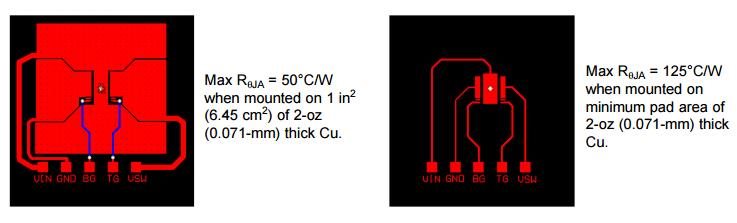

  • Here now - this vendor provides a graphic which nicely reveals the impact of the surrounding pcb size/geometry - upon the relationship, "Junction to Ambient."      Device shown is (again) a Power FET...
    Note that the, "Lower the value, "°C/W" the better for the semi-conductor...    (the larger pcb conductive "lands" (left drawing) are better able to draw heat from the device as compared to "minimal pcb pads."   (on the right)
    It should (now) be beyond "clear" that "external factors DOMINATE" and that poster's quest for an exacting MCU spec is, "outside his best interest."
