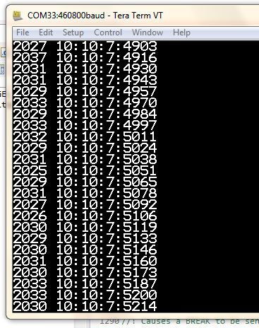

  • hey thanks for your answers,
       but i am unable to understand what you are saying to give more information about my problem here i am attaching the code and output which i am getting,
      if u observe the output , the difference between the sub seconds counter value is not the same for each sample (time interval) how to make it uniform , is there any possibility by changing code  .

  • Rupendra,
    Thank you for posting the image. I believe the initial explanation was good already, and I had understood what your problem is. For what is worth, the period differences are not too significant.
    Read again what I posted initially, and there is no "running away from it": you WILL NEED to understand what is written there, even if you have to read a few times and search more information about timers and embedded programming in other sites to help you.
    You need to control the timing of your code. Do you understand the timer hardware which is part of your MCU? Are you using timers? Are you using interrupts on the ADC? Do you have an oscilloscope to help you practicing this? You can simply generate timed pulses and measure them on the scope for a clearer understanding.
    One other thing that you need to answer (to yourself) is "when are you recording those time counter values"? Is it when you prepare the text output message? When the sample is finished? Sometime in between?
    There are lots of possible solutions - and for now, we don't even know if there is a problem, because the numbers are close enough and you have not stated what sort of precision is REQUIRED on your project. Getting a bit into the joking side, you can simply use sprintf(outputString,"2033 10:10:7:%04d",adcValue); and you will ALWAYS have a regular interval, won't you? Just an unpolite way of saying that a solution can only be crafted when there is a clear objective.
