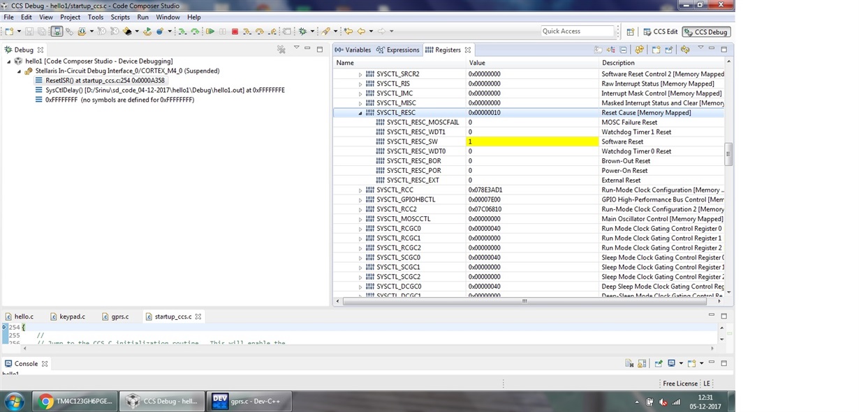

Good afternoon every one,
              I developed my code for one of my embedded application by using TM4C123GH6PGE Microcontroller. My code is working fine but after executing the code, with in few seconds its getting reset interrupt by the compiler (code composer studio V6) and it stops the debugging and again its starts from first instruction.
When reset interrupt occurs the it automatically going to startup_ccs.c   and showing me like this statements below.
void
ResetISR(void)
// Jump to the CCS C initialization routine. This will enable the
// floating-point unit as well, so that does not need to be done here.
__asm(" .global _c_int00\n"
" b.w _c_int00");
I request you to please tell me why this problem is occurring in my code and please suggest me how to solve this problem with out disturb my flow of code sequence.
Thanks in advance.

  • Hello Srinu,
    Usually that occurs when you have enabled an interrupt but don't have the ISR routed correctly inside of the startup_ccs.c file. Please share details about what interrupts you have enabled and what ISR's you are using for your project.

  • Hello Srinu,
    Do you also have extern function definitions for all your ISRs within startup_ccs.c? Such as:
    extern void PWM0IntHandler(void);
    extern void MainWaveformTick(void);
    extern void MainMillisecondTick(void);
    extern void SysTickIntHandler(void);
    extern void ADC0IntHandler(void);
    extern void Timer0IntHandler(void);
    extern void Timer1IntHandler(void);
    Additionally I didn't see any interrupt handle for:
    IntPrioritySet( INT_HIBERNATE_TM4C123, 0xC0);
    Lastly, it looks like you have two UART interrupts:
    UART0IntHandler
    UART2IntHandler
    Are those being used or not? Couldn't tell clearly. If not, they should be returned to IntDefaultHandler.

  • No interrupt handler for the MCU's "Watchdog" is listed.     As poster's (model) code was/is (almost) certainly intended for motor drive - and the "original such code" included a "Watchdog Interrupt" - the "absence" of such "Watchdog Interrupt" demands investigation.
    It would seem "reasonable" that, "Failure to provide a "Watchdog ISR" - when the, "Use of such watchdog is "highly" expected (i.e. for a motor App) would account for the regular (i.e. periodic Reset) of poster's MCU - due to normal/customary,  "Watchdog Reaction to insufficient attention!"     (in this case - NO attention!)
    The "original code" (from which both "Vegas & myself" certainly believe - "poster's code" sprang) definitely enabled the Watchdog - and included a proper Watchdog ISR!

  • Hai sir,
    In debugging process I got the software reset cause. I attached the snap shot. I request you to please find it and suggest me how to resolve the issue.
    Srinu.
  • Perhaps you should remove the flash boot loader until your reset issue has been resolved. Odds are it has somehow gone bonkers and issued a SW reset command.
  • Following the direction of poster BP and then vendor's Ralph - you've (now) identified the (likely) "source" of your recurring Reset.
    I would think it "advisable" for you to run your "test program" (which resulted in this finding) at minimum 3 or more (additional) times - each time checking - to confirm that "this" really is the "sole" cause of Reset.
    Should this prove the "sole" cause - would not your review of the MCU manual, and then the forum search box - in each case seeking "Software Reset Description/Info" - strengthen "your" knowledge - and capability?
    Your discovery of - and then correction - of such (unwanted) Reset's cause - would prove of interest to many here - thus would be an "ideal means" for you to "complete this thread."
  • Hello sir,
                I am getting the software reset randomly means if i load and debug the code and check by using debugger window (TM4C123G development board) its working fine up to two minutes one time and software reset occurs, again if i run the code then its run upto one minute, three minutes like this randomly software reset occurring.
         I request you to please suggest me how to remove the flash boot loader or any best method to resolve this issue. Please send me the screen shot how to stop the flash boot loader.
    I am using TM4C123G development board for my practice.
    Srinu.
