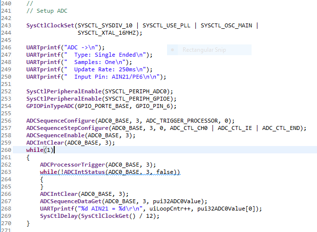

This concerns programming the ADC.
First the basics:
CCS version: 7.3.0.00019
PC OS: Win10
TI Code base: TivaWare_C_Series-2.1.4.178
Data sheet: Tiva™ TM4C123GH6PGE Microcontroller-15033.2672 Copyright © 2007-2013 (it came in a USB drive in the box)
I am trying to setup ADC0 to read voltages. Specifically simple circuit where a potentiometer is connected between the 3.3v and ground, and its output is input to PE6 (AIN21).  file for a   pic.
The reference code is based on: C:\ti\TivaWare_C_Series-2.1.4.178\examples\peripherals\adc\single_ended.c
Here it is:
The code as shown above results in displaying mostly 0's and occasional 1's from #268.
