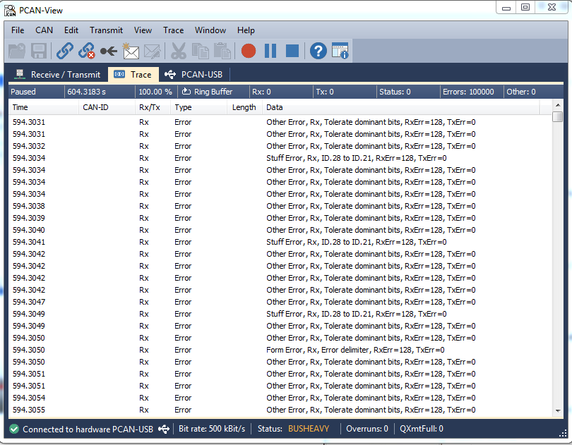

Hi, I am developing a CAN based communication system whereby I will need to transmit CAN messeges to multiple nodes. As a start, I have attempted my setup using 2 Nodes (2 TM4C129EXL launchpads) and this seems to work as expected although I have a some minor issues in filtering the message ID which is not related to this issue (refer to : e2e.ti.com/.../641798).
However when I attempted to communicate with PCAN-USB Adapter (Transmit from launchpad and receive from PCAN-USB adapter), there seems to be some error messages. The transmit will stop after a single transmit. I am using PCAN-View to trace the received messages.
I am still trying to figure out what is causing this errors. Attached the schematics, terminal output and error messages.
Simple Schematics:
Hardware setup:
PCAN-USB setup:
Error message:
Terminal output at transmit side:

        g_bErrFlag = 0;
    // Otherwise, something unexpected caused the interrupt.  This should
    // never happen.
    else
        // Spurious interrupt handling can go here.
// Configure the CAN and enter a loop to transmit periodic CAN messages.
int
main(void)
#if defined(TARGET_IS_TM4C129_RA0) ||                                         \
    defined(TARGET_IS_TM4C129_RA1) ||                                         \
    defined(TARGET_IS_TM4C129_RA2)
    uint32_t ui32SysClock;
#endif
    // Set the clocking to run directly from the external crystal/oscillator.
    // TODO: The SYSCTL_XTAL_ value must be changed to match the value of the
    // crystal on your board.
    ui32SysClock = SysCtlClockFreqSet((SYSCTL_XTAL_25MHZ |
                                       SYSCTL_OSC_MAIN |
                                       SYSCTL_USE_OSC)
                                       ,25000000);
#else
    SysCtlClockSet(SYSCTL_SYSDIV_1 | SYSCTL_USE_OSC | SYSCTL_OSC_MAIN |
                   SYSCTL_XTAL_16MHZ);
#endif
    // Set up the serial console to use for displaying messages.  This is
    // just for this example program and is not needed for CAN operation.
    InitConsole();
	UARTprintf("Debug: check console\n");
    // For this example CAN0 is used with RX and TX pins on port B4 and B5.
    // The actual port and pins used may be different on your part, consult
    // the data sheet for more information.
    // GPIO port B needs to be enabled so these pins can be used.
    // TODO: change this to whichever GPIO port you are using
    SysCtlPeripheralEnable(SYSCTL_PERIPH_GPIOA);
    // Configure the GPIO pin muxing to select CAN0 functions for these pins.
    // This step selects which alternate function is available for these pins.
    // This is necessary if your part supports GPIO pin function muxing.
    // Consult the data sheet to see which functions are allocated per pin.
    // TODO: change this to select the port/pin you are using
    GPIOPinConfigure(GPIO_PA0_CAN0RX);
    GPIOPinConfigure(GPIO_PA1_CAN0TX);
    // Enable the alternate function on the GPIO pins.  The above step selects
    // which alternate function is available.  This step actually enables the
    // alternate function instead of GPIO for these pins.
    // TODO: change this to match the port/pin you are using
    GPIOPinTypeCAN(GPIO_PORTA_BASE, GPIO_PIN_0 | GPIO_PIN_1);
    // The GPIO port and pins have been set up for CAN.  The CAN peripheral
    // must be enabled.
    SysCtlPeripheralEnable(SYSCTL_PERIPH_CAN0);
    // Initialize the CAN controller
    CANInit(CAN0_BASE);
    // Set up the bit rate for the CAN bus.  This function sets up the CAN
    // bus timing for a nominal configuration.  You can achieve more control
    // over the CAN bus timing by using the function CANBitTimingSet() instead
    // of this one, if needed.
    // In this example, the CAN bus is set to 500 kHz.  In the function below,
    // the call to SysCtlClockGet() or ui32SysClock is used to determine the
    // clock rate that is used for clocking the CAN peripheral.  This can be
    // replaced with a  fixed value if you know the value of the system clock,
    // saving the extra function call.  For some parts, the CAN peripheral is
    // clocked by a fixed 8 MHz regardless of the system clock in which case
    // the call to SysCtlClockGet() or ui32SysClock should be replaced with
    // 8000000.  Consult the data sheet for more information about CAN
    // peripheral clocking.
    CANBitRateSet(CAN0_BASE, ui32SysClock, 500000);
#else
    CANBitRateSet(CAN0_BASE, SysCtlClockGet(), 500000);
#endif
    // Enable interrupts on the CAN peripheral.  This example uses static
    // allocation of interrupt handlers which means the name of the handler
    // is in the vector table of startup code.  If you want to use dynamic
    // allocation of the vector table, then you must also call CANIntRegister()
    // here.
    CANIntRegister(CAN0_BASE, CANIntHandler); // if using dynamic vectors
    CANIntEnable(CAN0_BASE, CAN_INT_MASTER | CAN_INT_ERROR | CAN_INT_STATUS);
    // Enable the CAN interrupt on the processor (NVIC).
    IntEnable(INT_CAN0);
    // Enable the CAN for operation.
    CANEnable(CAN0_BASE);
    // Initialize the message object that will be used for sending CAN
    // messages.  The message will be 4 bytes that will contain an incrementing
    // value.  Initially it will be set to 0.
    // Initialize message object 1 to be able to send CAN message 1.  This
    // message object is not shared so it only needs to be initialized one
    // time, and can be used for repeatedly sending the same message ID.
    g_sCANMsgObject1.ui32MsgID = 0x1001;
    g_sCANMsgObject1.ui32MsgIDMask = 0;
    g_sCANMsgObject1.ui32Flags = MSG_OBJ_TX_INT_ENABLE;
    g_sCANMsgObject1.ui32MsgLen = sizeof(g_pui8Msg1);
    g_sCANMsgObject1.pui8MsgData = g_pui8Msg1;
    // Initialize message object 2 to be able to send CAN message 2.  This
    g_sCANMsgObject2.ui32MsgID = 0x2001;
    g_sCANMsgObject2.ui32MsgIDMask = 0;
    g_sCANMsgObject2.ui32Flags = MSG_OBJ_TX_INT_ENABLE;
    g_sCANMsgObject2.ui32MsgLen = sizeof(g_pui8Msg2);
    g_sCANMsgObject2.pui8MsgData = g_pui8Msg2;
    // using obj 4
    g_sCANMsgObject4.ui32MsgID = 0x4001;
    g_sCANMsgObject4.ui32MsgIDMask = 0;
    g_sCANMsgObject4.ui32Flags = MSG_OBJ_TX_INT_ENABLE;
    g_sCANMsgObject4.ui32MsgLen = sizeof(g_pui8Msg_t);
    g_sCANMsgObject4.pui8MsgData = g_pui8Msg_t;
    // Enter loop to send messages.  Four messages will be sent once per
    // second.  The contents of each message will be changed each time.
    for(;;)
        // Send message 1 using CAN controller message object 1.  This is
        // the only message sent using this message object.  The
        // CANMessageSet() function will cause the message to be sent right
        // away.
        PrintCANMessageInfo(&g_sCANMsgObject1, 1);
        CANMessageSet(CAN0_BASE, 1, &g_sCANMsgObject1, MSG_OBJ_TYPE_TX);
        // Send message 2 using CAN controller message object 2.  This is
        // away.
        PrintCANMessageInfo(&g_sCANMsgObject2, 2);
        CANMessageSet(CAN0_BASE, 2, &g_sCANMsgObject2, MSG_OBJ_TYPE_TX);
        // Load message object 3 with message 3.  This is needs to be done each
        // time because message object 3 is being shared for two different
        // messages.
        g_sCANMsgObject3.ui32MsgID = 0x3001;
        g_sCANMsgObject3.ui32MsgIDMask = 0;
        g_sCANMsgObject3.ui32Flags = MSG_OBJ_TX_INT_ENABLE;
        g_sCANMsgObject3.ui32MsgLen = sizeof(g_pui8Msg3);
        g_sCANMsgObject3.pui8MsgData = g_pui8Msg3;
        // Clear the flag that indicates that message 3 has been sent.  This
        // flag will be set in the interrupt handler when a message has been
        // sent using message object 3.
        g_bMsgObj3Sent = 0;
        // Now send message 3 using CAN controller message object 3.  This is
        // the first message sent using this message object.  The
        // away.
        PrintCANMessageInfo(&g_sCANMsgObject3, 3);
        CANMessageSet(CAN0_BASE, 3, &g_sCANMsgObject3, MSG_OBJ_TYPE_TX);
        // Wait for the indication from the interrupt handler that message
        // object 3 is done, because we are re-using it for another message.
        while(!g_bMsgObj3Sent)
            SimpleDelay();
        // Load message object 3 with message 4.  This is needed because
        // message object 3 is being shared for two different messages.
        g_sCANMsgObject3.ui32MsgID = 0x3002;
        g_sCANMsgObject3.ui32MsgLen = sizeof(g_pui8Msg4);
        g_sCANMsgObject3.pui8MsgData = g_pui8Msg4;
        // Now send message 4 using CAN controller message object 3.  This is
        // the second message sent using this message object.  The
        // away.
        PrintCANMessageInfo(&g_sCANMsgObject4, 4);
        CANMessageSet(CAN0_BASE, 4, &g_sCANMsgObject4, MSG_OBJ_TYPE_TX);
        // Wait 1 second before continuing
        SimpleDelay();
        // Check the error flag to see if errors occurred
        if(g_bErrFlag)
            UARTprintf(" error - cable connected?\n");
        else
            // If no errors then print the count of message sent
            UARTprintf(" total count = %u\n",
                       g_ui32Msg1Count + g_ui32Msg2Count + g_ui32Msg3Count + g_ui32Msg4Count );
        // Change the value in the message data for each of the messages.
        (*(uint32_t *)g_pui8Msg1)++;
        (*(uint32_t *)g_pui8Msg2)++;
        (*(uint32_t *)g_pui8Msg3)++;
        (*(uint32_t *)&g_pui8Msg4[0])++;
        (*(uint32_t *)&g_pui8Msg4[4])--;
        (*(uint32_t *)g_pui8Msg_t)++;
    // Return no errors
    return(0);
