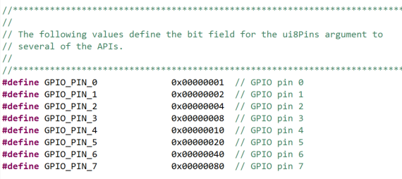

Hi Champs,
I want to generate GPIO interrupt and I use GPIOIntRegisterPin() to register interrupt service routine. However, I found out when I called GPIOIntRegisterPin(GPIO_PORTQ_BASE, GPIO_PIN_0, DI0_IntHandler);. It will pass wrong value to IntRegister(). Please see below code. ui32Int = 0x100,  ui32Pin=GPIO_PIN_0=0x0001. It will write DI0_IntHandler address to 0x101 which isn't correct address. In datasheet, PQ0 interrupt vector should be put at 0x100. That's why when I trigger PQ1 interrupt and it ran PQ0 ISR.... Because 0x101 should be PQ1 ISR address.
Could anyone check this part ? I can attached my main.c file in post. thanks!

void
GPIOIntRegisterPin(uint32_t ui32Port, uint32_t ui32Pin,
                   void (*pfnIntHandler)(void))
    uint32_t ui32Int;
    // Check the arguments.
    ASSERT((ui32Port == GPIO_PORTP_BASE) || (ui32Port == GPIO_PORTQ_BASE));
    ASSERT((ui32Pin > 0) && (ui32Pin < 8));
    ASSERT(pfnIntHandler != 0);
    // Get the interrupt number associated with the specified GPIO.
    ui32Int = _GPIOIntNumberGet(ui32Port);
    // Register the interrupt handler.
    IntRegister((ui32Int + ui32Pin), pfnIntHandler);
    // Enable the GPIO pin interrupt.
    IntEnable(ui32Int + ui32Pin);
