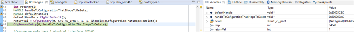

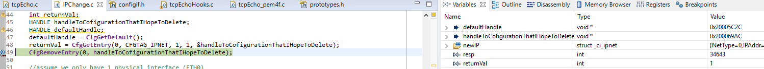

  • Hi Steven,
    Here's a screen shot that includes a successful return value to prove the code "works":
    However, I still don't understand what is happening here. Why is 0 an acceptable handle to pass to CfgGetEntry() as the first argument?
    Edit: The default and the handle used during initialization are the same. Passing 0 is that same as passing the valid config handle that did the initialization.
