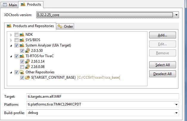

RTOS 2.16.1.14 Has several issues:
1. Boolean switch fails state change detection inside a running task when executed from GUI composer v1.0 button. Must set Boolean value prior to entering the task for it to assert inside task.
2. Task_sleep(2000) function inside an task being exited produces no Sleep (indication) in RTOS Analyzer details or Live events but show 0000 for time listing. Task_exit() or (return) directives produce same results.
3. Reverting MCU core with 1Meg flash to 512k flash MCU fails to place Tivaware device driver library interrupt (.vector) in the correct position and fails to compile application with M3 HWI module support.
4. RTOS Analyzer graphs (load/execution) CC7 debug import no live data yet switching to details view shows values being posted.
  • #1 work around fixed by adding a (while) versus (if) directive with 2000ms sleep period. Waiting for the Boolean switch to be activated from the GUI. The odd part is the task was Queued each time after sleep period but the Boolean switch was apparently not being LATCHED.
    #2 Task name used be shown so how anyone know what task is from all the (dynamic) allocated HWI task handlers. The 2000ms time out period showing the logging but there are 2 static tasks with same logger prints syntax.
     RTOS Analyzer Format: 664000063025,,CORTEX_M4_0,"LM_sleep: tsk: 0x200147a8, func: 0x58f9, timeout: 2000",Task_LM_sleep,Unknown,200147a8,,11287,LoggerIdle,ti.sysbios.knl.Task,ti.sysbios.knl.Task,,,79680007563,0x200147A8,0x58F9,0x7D0,0x0,,,,,
    Static Task Function logger:
    /* Sleep for 2000ms */
     Task_sleep(sleepDur);
     Log_print2 (Diags_USER1, "Task %d awake, count = %d", 0, count);
     count++;
    #3 program will not fit into available memory.  run placement with alignment fails for section ".vtable" size 0x26c , overlaps with ".vecs", size 0x360 (page 0) tm4c1294kcpdt.cmd /rtsc_bldc_qs_iot line 38 C/C++ Problem.
    *RTOS Project (TM4C129x.cmd) file incorrectly assigns  (.vtable as Hex value), change (.vtable : > SRAM) make (.intvecs: > FLASH) That issue is a killer time eater migrating existing APPS to RTOS.

    The only problem left is the RTOS Analyzer graphs are not producing any lines in the recent update CCS7 on Thursday and it replaced many IDE files etc... The only graph kind of working is Execution but only produces a single line for Kernel idle task. The CPU load graph was previously producing several different dynamic HWI loaded tasks as seem to recall some time ago.
    Update to CCS7.0 versions:
     IDE - Debug Server Integration Feature 6.0.1.201705101800,    RTSC/XDCtools (Target Runtime Support) 3.32.2.25,   XDCtools Core Update Feature 3.32.2.25, Code Composer Studio IDE Main Feature 7.2.0.201705101800, System Analyzer (UIA Target),  (IDE Client) 2.0.5.50, <<< DVT - Graph Visualization 4.1.0.201705251038 >>>
