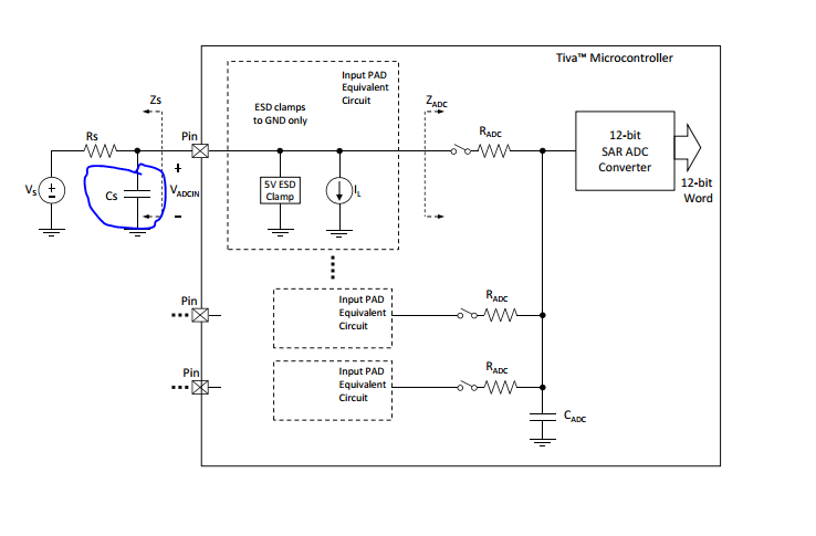

 I has a issue of harwave.
How much value is Cs capacitor in there?
  • Whatever is appropriate for your signal. It should be large enough that charging or discharging the internal sample capacitor does not affect it's level significantly. At the same time it can act as a Nyquist filter.

  • Does not that detail appear w/in the MCU manual's "ADC spec listing" - far to the rear of the manual? (it is a small value cap - to be sure)
    More importantly (as you cannot alter that cap) is your development of proper "Analog Front End" circuitry - which satisfactorily "charges & discharges" that cap. The impedance of your circuit must well match that of the ADC - and sufficient current to "properly" charge/discharge that cap - must be provided.

  • cb1, you do realize Cs is outside of the micro? The sample cap is Cadc to the right.
