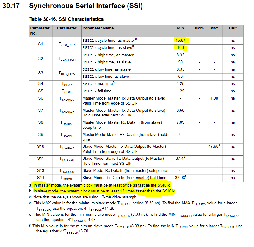

  • Hello Richard,
    The answer to both questions depends on which device is the master and which is the slave.  If the TM4C129 is the master, the maximum SCLK speed it 60MHz. (Of course the physical interface must support this speed. Having to run  signals from the DK-TM4C129X to another board may make this impossible. High speed SPI is best for communication between chips on the same PCB.) In master mode the speed is set by a call the the TivaWare function shown below. In the example the speed is set to 10MHz
        SSIConfigSetExpClk(SSI0_BASE, ui32SysClock, SSI_FRF_MOTO_MODE_0,
                           SSI_MODE_MASTER, 10000000, 8);
    If the TM4C is in slave mode, the speed is set by the master. However, the speed cannot be faster than 1/12th of the TM4C192 system clock. That limits the speed to 10MHz.

  • The SSI clock rate limitations are in the "Electrical Specification" section of the data sheet:
