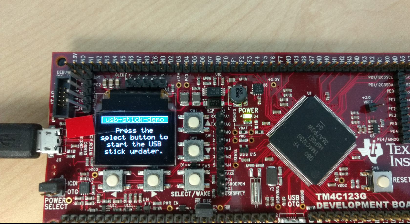

  • Hi Jame,
     After your step 5, did you first run the usb_stick_update program?
     Below are the steps I used and it is working for me.
    Step1: Rename the built usb_stick_demo.bin file to the name FIRMWAREBIN.bin.
    Step2: Copy USB stick memory FIRMWAREBIN.bin file under root.
    step3: Build the usb_stick_update  and load it to the flash
    step4: Run the usb_stick_update program. Note the display screen should be blank at this time.
    step5: insert the USB memory
    step6. Reset the device.  In CCS go to Run->Reset->System Reset
    step7: Run the program again.
    After you run step7 you should see the display with the text below.
     You can press the SELECT/WAKE button and the usb_stick_demo program will call the updater to reload the program.

    This application(usb_stick_update) explain force a new firmware update from the memory stick.
    It is also described in the source code (usb_stick_update) and is called the Press select button.
    if(ROM_GPIOPinRead(GPIO_PORTM_BASE, GPIO_PIN_4) == 0)
    UpdaterMain();
    (note)
    Thank you for your efforts to explain the captured image.
    " Press the select button to start the USB stick updater "
    However, it is the same as only writing the "usb_stick_demo " program to DK-EVB.
    regards.

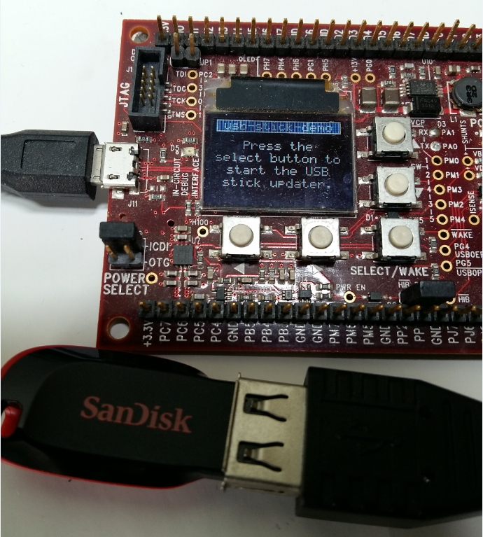

  • Hi Jame,
    After step 5, the FIRMWARE.BIN is loaded from the usb memory stick to the flash starting at 0x4800. By this time the flash will have both the usb_stick_update (starting at 0x0) as well as the usb_stick_demo (starting at 0x4800). I asked you to do step 6 to reset the device so that the usb_stick_update will rerun again but upon detecting that there is already an application program image it will jump and run the FIRMWARE.BIN. This is why you will see the display that ask you to press the select button. If you press the SELECT button the FIRMWARE.BIN which is now running is supposed to transfer the control back to the usb_stick_update so that usb_stick_update will again reload the FIRMWARE.BIN.
  •  Hi Charles.
    charls replay >I asked you to do step 6 to reset the device so that the usb_stick_update will rerun again
    A1>  I am not use a CCS Tools. However, I understood that the meaning of the system reset setting
    Q1>  Is that correct ?
    Q2> Did not you proceed to step7?
    In step 7, "usb_stick_update" is written again via ICD.   The display screen does not change.
    charls replay > but upon detecting that there is already an application program image it will jump and run the FIRMWARE.BIN.
    Q3> Is the file name FIRMWARE.bin -> FIRMWAREBIN.bin error ?
    charls replay >  This is why you will see the display that ask you to press the select button.
     A3> After performing step 7, I understood that I could see the button on the display
          n that state, if you press SELECT button, it means that usb_stick_update is rewritten.

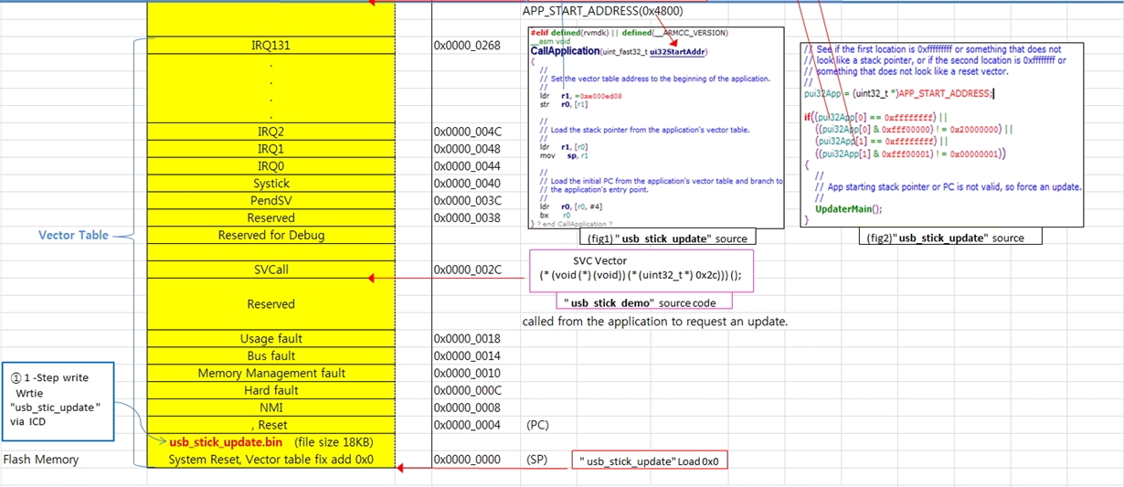

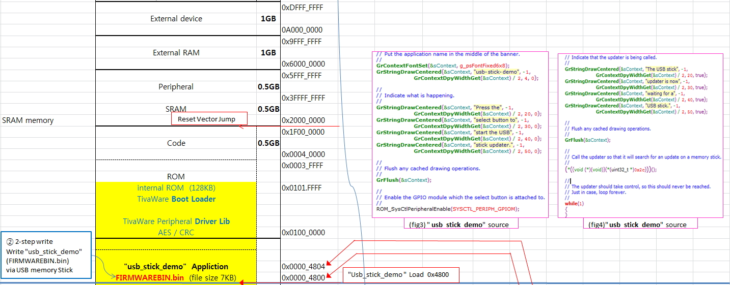

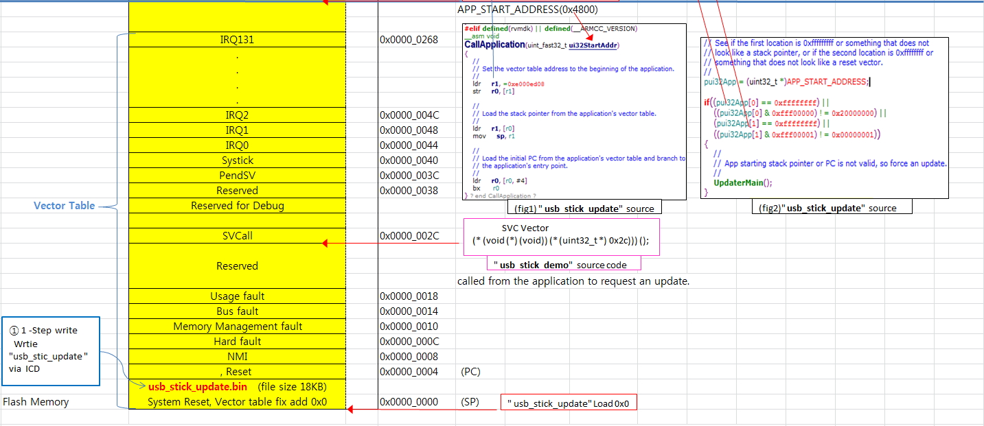

    Q5> I have organized it into a memory map.
            Is it right for me to understand?
    [Attach capture image]
    1-step write " usb_stick_updata" via ICD
    2-step write " usb_stick_demo(FIRMWAREBIN.bin) via USB stick memory
    regards.

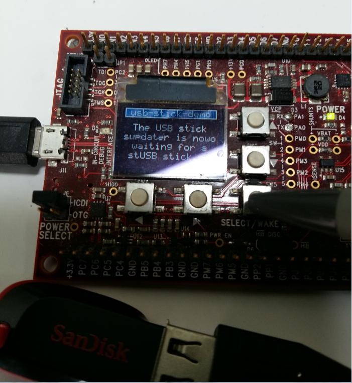

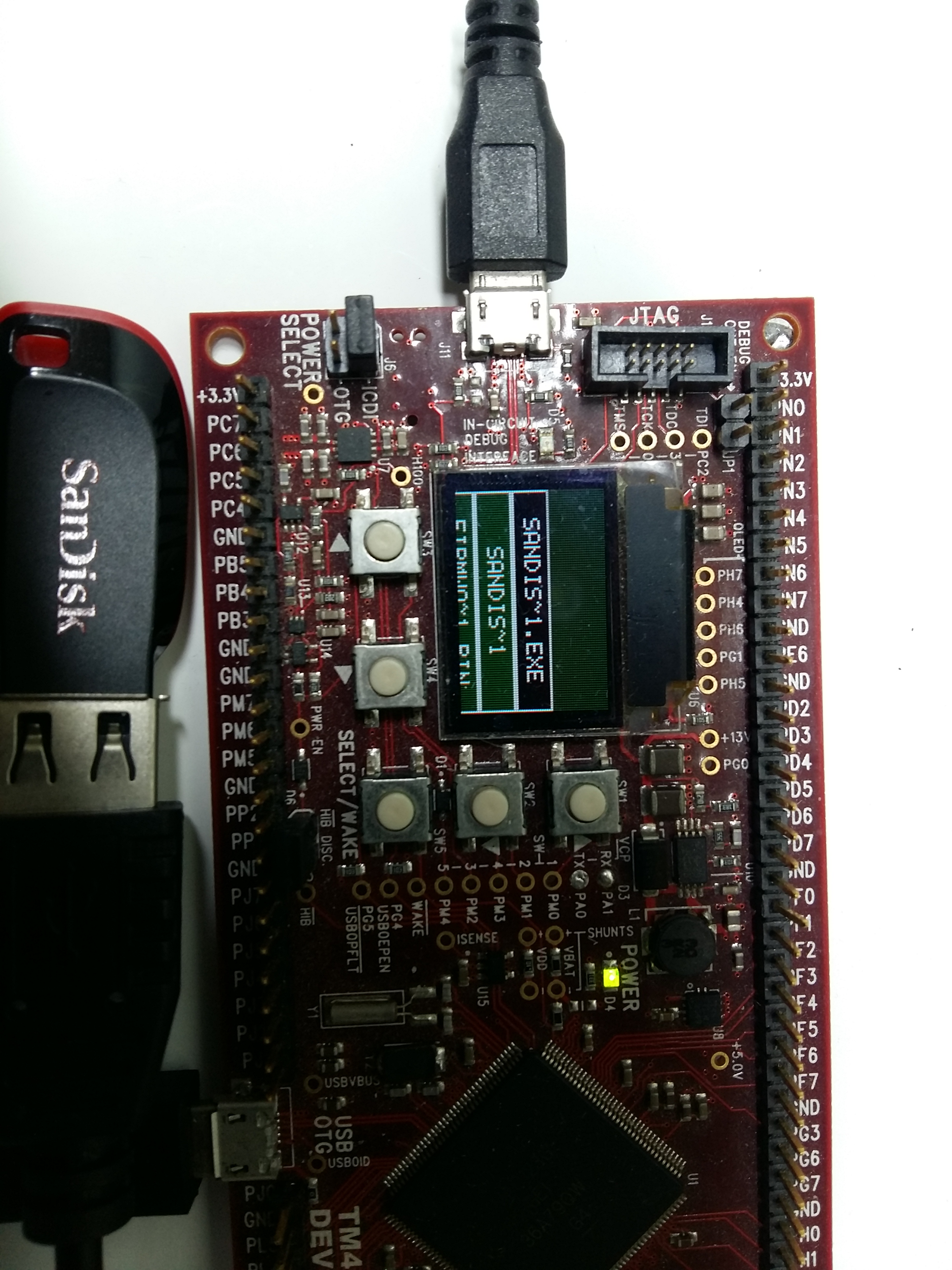

  •  Hi Charles.

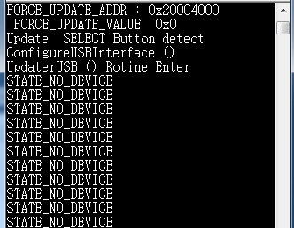

    Usb_stick_Update This is a review that does not work.
    Do USB memory sticks only use TEXAS INSTRUMENTS USB?
    Currently USB memory stick is inserted into SanDisk Vendor.
    Because of the following log message.
    What's the problem?
    - My thoughts are so fast that I wonder if it's an initialization problem.
    How should we solve the problem ?
    regards.
    In the " usb_host_msc"  example, the USB stick works well.
  • Hi Jame,
     Responding to your reply on Dec 5, 2017 8:04PM.
     First of all, it is FIRMWARE.BIN, not FIRMWAREBIN.BIN. If you use FIRMWAREBIN.BIN then it will not work.
     Did you come to the point where the the display says "Press the select button to start the USB stick updater"? If your answer is yes, then the demo program has already been loaded to 0x4800. So this is considered working if you have come to this point.
     Look a the code below. The demo code will now wait for you to press the SELECT button. The code contains some debounce logic but once you press it will eventually transfer the control to the usb_demo_updater using the SVC call statement (*((void (*)(void))(*(uint32_t *)0x2c)))(); Before transferring the control to the usb_stick_updater it is supposed to print "The USB stick updater is now waiting for a USB stick". But you may not see this on the screen because everything happened too fast. As soon as the usb_stick_updater starts to run it will copy the new FIRMWARE.BIN again and afterward will reset the device. When the device is reset you will not be able to see the message on the display.
      BTW, your vector table is correct.

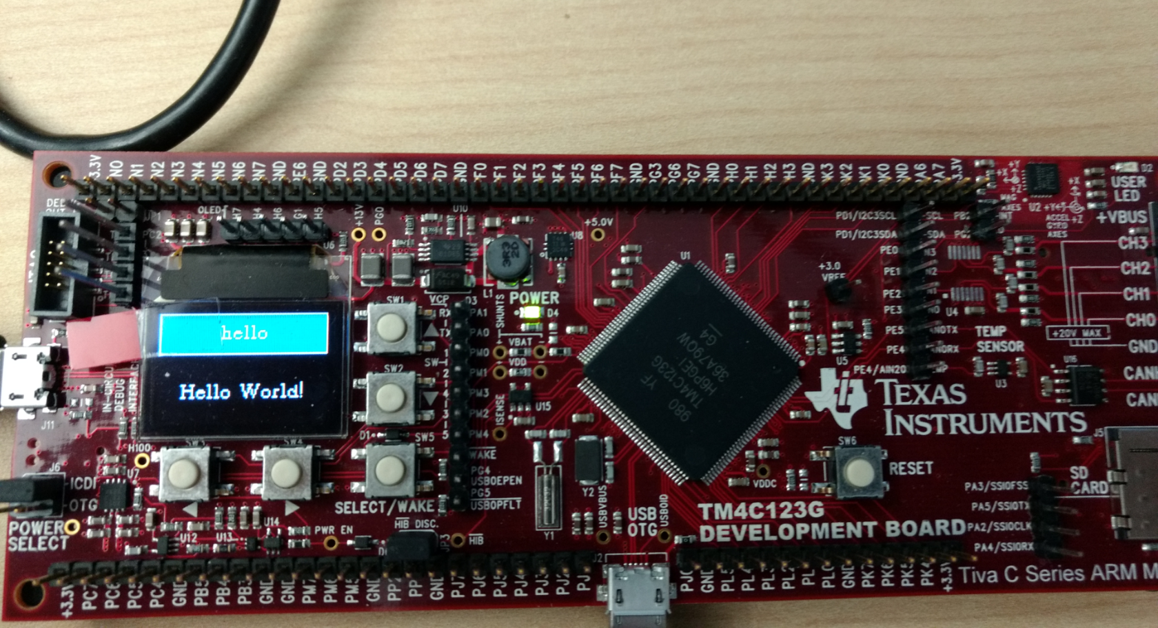

  • Hi Charles.
    I was confused  about name of the file must be 11 characters total, 8 for the base name and 3 for the extension.
    #define USB_UPDATE_FILENAME "FIRMWAREBIN"
    ui32FileSize = SimpleFsOpen(USB_UPDATE_FILENAME);
    The file name works correctly with FIRMWARE. Thank you.

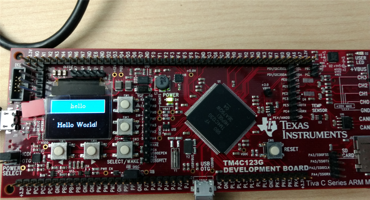

    Q2> I want to apply it to the current application.
            I tried to change usb_stick_demo to Hello example.
            I have added the following in the source code
             " (*((void (*)(void))(*(uint32_t *)0x2c)))(); "  // SVCall
            But it does not work. (Hello.bin  ->  FIRMWARE.bin)
           How should I apply it?

  • Jame shin said:
    Q1> What does BTW mean?
    BTW is a abbreviation for "By the way".
    As I explained in the last post that everything happened very fast that as soon as the SVC is called with  (*((void (*)(void))(*(uint32_t *)0x2c)))() the updater will reset the device and start to download the new FIRMWARE.BIN. When the reset happens you will not be able to see the "Hell World" on the screen.
    I modified your code just slightly with a delay before calling SVC and I see the Hello World on the display.
        GrStringDrawCentered(&sContext, "Hello World!", -1,
                             GrContextDpyWidthGet(&sContext) / 2,
                             ((GrContextDpyHeightGet(&sContext) - 24) / 2) + 24,
                             0);
        int i=0;
        for (i=0;i<10000000;i++);
  • Hi Charles.
    I have a Hello World on display with the addition of a delayed for statement in the code
    So again from the beginning "usb_stick_update" has been reviewed.
    There are three if conditional statements.
    1. App starting stack pointer or PC is not valid, so force an update.
    2. Check to see if the application has requested an update
    3. Check if the button is pressed, if so then force an update.

    Stellaris ICD Settings -> Falsh -> (v) program , (v) verify, () Reset and Run
    Q1> 0xFFFF.FFFF because all of the flash memory contents have been erased.
            So,  enter SP + PC Point Check Routin
            Call the UpdaterMain () function.
             However, it is not displayed. Why?
    Q2> Apply 1 condition to #ifedf #endif and apply condition 3 to normal operation. Why?
             step1 : Rename usb_stick_demo.bin -> FIRMWARE.bin
             step2 : "usb_stick_update" write
             step3 : step3-1 "RESET + SELECT" button continue press in the device(DK-EVB)
                        step3-2. RESET not press
                        step3-3. SELECT not press
    It will display correctly as an attached image.

  • Jame shin said:
    (note) All fresh memory is erased at every initial step.
    In the case of me, in rvmdk(Keil) Options for Target -> Debug ->
    I don't think I understand your question. The usb_stick_updater will check if the SP/PC is valid for the "application" program. If the SP/PC is not valid then the updater will force an update. It seems to me that you said you erased the flash when you said "All fresh memory is erased at every initial step.". If you erase the flash then you have also erased the usb_stick_updater program. Please clarify what are you trying do when you erase the flash. If you erase the flash then you need to reload the usb_stick_updater first.
  • Hi Charles.
    I will describe it concisely and clearly.
     - Eraser fresh is the reason for initializing.
    Above, in case of Q1)
    1. I first erase the fresh. Then write usb_stick_update to DK-EVB.
    2.  The SP/PC is not valid then the updater will force an update.
    3. So, we will call the UpdaterMain () function.
         Result, it is not displayed.
    Above, in case of Q2)
    1. Insert the #if 0 ~ #endif in source code,   build it.
    #if 0
         if((pui32App[0] == 0xffffffff) ||
         ((pui32App[0] & 0xfff00000) != 0x20000000) ||
         (pui32App[1] == 0xffffffff) ||
         ((pui32App[1] & 0xfff00001) != 0x00000001))
         // App starting stack pointer or PC is not valid, so force an update.
         UpdaterMain();
    #endif
    2. I first erase the fresh. Then write usb_stick_update to DK-EVB.
    3. Press the "RESET + SELECT" button simultaneously to release the RESET button.
    4. So, we will call the UpdaterMain () function.
        Result, The message will be displayed.
    Q1 and Q2 are the same, why is there a difference?
    regards.

    What is not displayed? Can you be more specific? What text do you anticipate to display? If you are asking about the LCD display with the text "Press the select button to start the USB stick updater" then that is part of the usb_stick_demo application, not the usb_stick_update program. The usb_stick_update does not print anything onto the LCD display. As soon as the usb_stick_update is run and you have plugged in the usb flash drive with the FIRMWARE.BIN on the root directory it will start the download operation. After the download, if you reset the device. If you run again it will show the "Press the select button to start the USB stick updater" on the display. I thought you already got this working.
    Jame shin said:
    #if 0
         UpdaterMain();
    #endif
    Here you are forcing the update based on the SP/PC checking. You are forcing the an update by pressing the SELECT. By doing so the usb_stick_demo will call the UpdateMain() and do the update again. So what are you trying to prove?  I'm at a loss as to what you are trying to say.
    Please revert back to the original usb_stick_update and usb_stick_demo and try again. Just tell me a yes or no answer for the below scenario.
      1. Load the original usb_stick_update
      2. Plug in the usb_stick_demo with the FIRMWARE.BIN which is renamed from usb_stick_demo.bin
      3. Run the usb_stick_update
      4. When it is successful, it will reset the device. In CCS, I see the PC (program counter) stop at the ResetISR. I have no idea about Keil. You need to consult the Keil support how to halt the CPU at reset vector when the device is reset. If your Keil is configured this way, it may just run the program from the reset vector again. However, if this is the case, it will jump to the usb_stick_demo application where you should see "Press the select button to start the USB stick updater" on the display.
      5. Run the device again. This time the usb_stck_update will know that there is already a valid application starting at 0x4800 and just jump to the application.
      6. When the application is run this is when you see the "Press the select button to start the USB stick updater" on the LCD display.

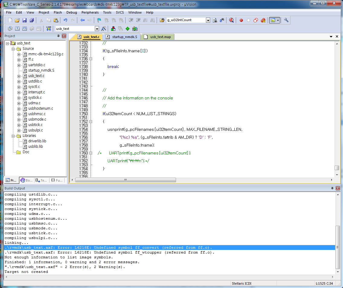

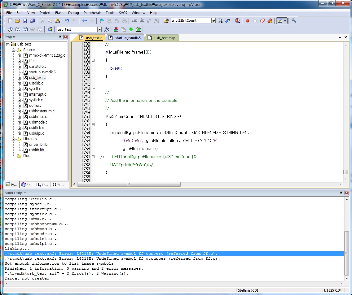

  • Hi Charles
    Two link errors occur.
    1. ff_convert
    2. ff_wtoupper
    I can not find the drive file to resolve this.
    Please tell me how to solve the problem. ?
