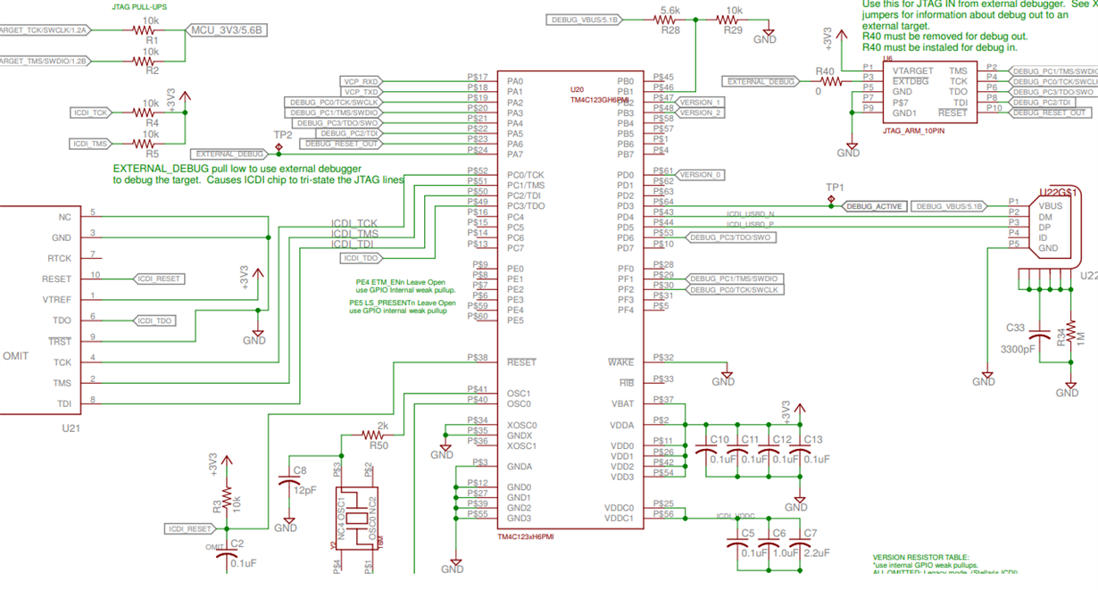

The EK-TM4C1294 launch pad uses a TM4C123 as a debug interface. We are currently developing an electronic test bed for our product and wish to program our target device using another TM4C1294. Is the code for the debug interface for the EK-TM4C1294 launch pad availible? Does anyone know of any existing code or libraries allowing the programming of cortex M processors from cortex M simply using GPIO?

  • As can be seen in the circuit below the ICDI on the EK-TM4C1294 uses port A pins to program the host processor. The performance is more than adequate. We wish to produce an autonomous piece of test equipment capable of programming the DUT. The posting was to inquire if the code used in this ICDI was available.

  • Yes, the Port A pins are multiplexed for JTAG/SWD functions. However, the debug probe firmware that is inside the TM4C123 is a TI proprietary IP and it source code is not available to the public. I have seen people trying to bit-bang the JTAG interface to the target device. But I don't think this is what you want to invest your effort. As suggested by cb1 and Robert, you will be better served with a jtag connector on your board that you can connect with the debug probe of your choice (be it Jlink or XDS110 and others) to debug/program your target device.
