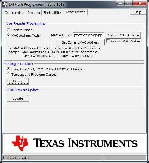

I tried to erase the flash with the LM Flash Programmer but I get the error   "**ERROR**: Unable to initialize target -0!"
Then I unlocked the MCU using the LM Flash Programmer Debug Port Unlock Utility. The process was finished successfully.
I still get the error with the LM Flash programmer when I want to erase the Flash or with the CCS when I want to load my program.

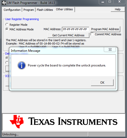

    How did you know that the unlock was successful? Are you saying that after the unlock the firmware is still in the flash? If this is the case then the unlock did not succeed. Please try again. If the unlock is successful then the flash should be completely erased. In the LM flash programmer under the Other Utilities you can click on the Get Current MAC Address. What does it return? If unlock is successful it will also erase your LaunchPad MAC address. It should show FF-FF-FF-FF-FF-FF.
    Try below steps.
    1. Unpower the board and press reset
    2. Power the board but do not release the reset
    3. Run the unlock sequence according to the LM programmer "dialog box"
    4. Power Cycle the board
    5. Do a Flash Erase Check or load a simple program to confirm the debugger can access the MCU again

  • Hi Charles,
    the LM Flash Programmer just gave the message the unlock has been successful, but the flash still has the firmware and the MAC Address is also there (I also get the error when I try to read the MAC with the LM Flash Programmer, but the firmware I flashed it reads it out). I tried several times this unlock process (just as you described), but always with the same result.

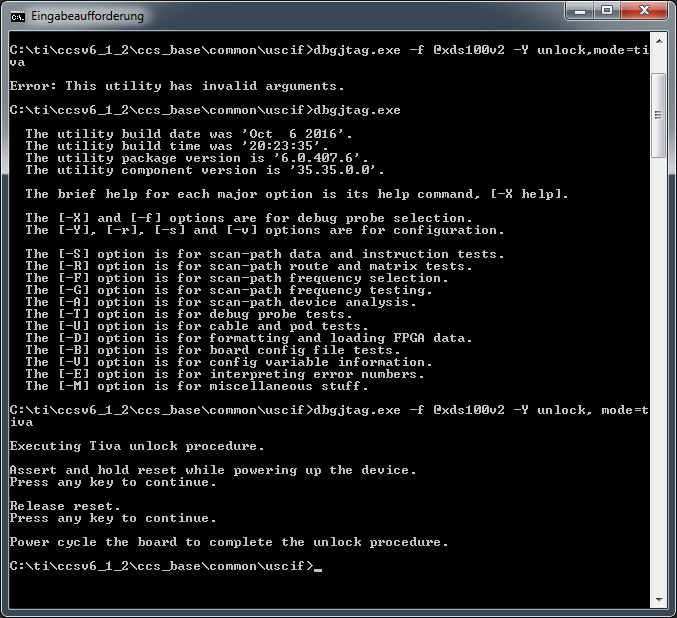

    5. If you have XDS debug probe (XDS100v2, XDS200) you can use the utility dbgjtag.exe to unlock the device. Please follow the app note I reference.

    1. I dont release the reset button when power it on, and follow the instruction comming from the LM Flash Programmer. Here a screenshot after releasing reset:
    2. I power cycle the board and the process is successfully finished

    4. I have a XDS100v2 and already tried with CSS and Uniflash to erase the flash or to download a new firmware. I get with both also an error. Here an screenshot of the error showed by Uniflash:
    5. I used the dbgjtag.exe to unlock the board:
    I still cannot unlock the board...

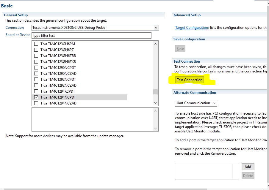

     2. Since you have XDS100, you can run a scan test in CCS. See below.

    2. I run the scan test with the following output:

    so, the scan is not successfully.
    On the meantime the new board arrived. On it everything is working fine: I can unlock it and reprogramm it and also all the tests I run in the no-functional board are running on the new one.
    Is it possible that some of the JTAG pins from the maincontroller got corrupted or are broken?? If that is the case, do you might know why and how? I wouldnt like it to happen again in the new board or any of our products going to the market with this microcontroller.

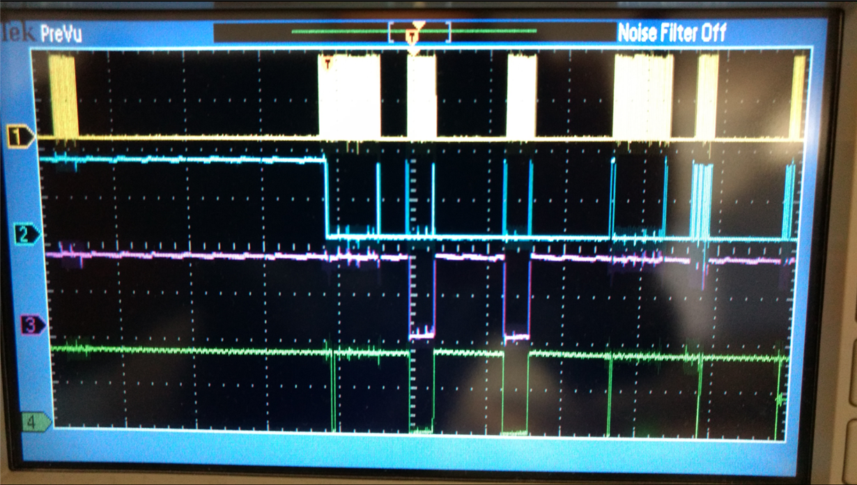

     Can you take scope capture of the JTAG interface. Below is what I capture (TCK, TMS, TDI, TDO) when running the connection test. What do you see on the TDO?

    Regarding TDO signal, for me is always low in the non-working board (I got the clock on TCK and TDI is also sending data, but TDO is not even at high level). On the new board is everything working fine: the signals are like you posted...
    Could be possible, like posted, that the TDO pin due to ESD is not functional anymore?
