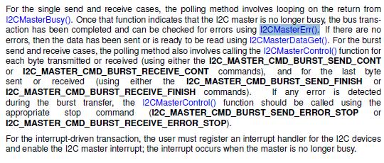

  • Hi Benjamin,
    Your code should check for acknowledgement and error flags in your master I2C. If the addressed slave is unplugged then it will not acknowledge the command from the master during the address and data cycles.
    Note that even with the I2C slave still on the bus it is possible that the master does not detect acknowledgement from the slave for various reasons as noted by cb1. For example, the SDA high or low voltage level does not reach the slave's input thresholds or the slave interpreted a noise spike as an SCL cycle. Make sure you have adequate series resistors in this case if the I2C bus can be accessed from an external connector. cb1 may have other recommendations.

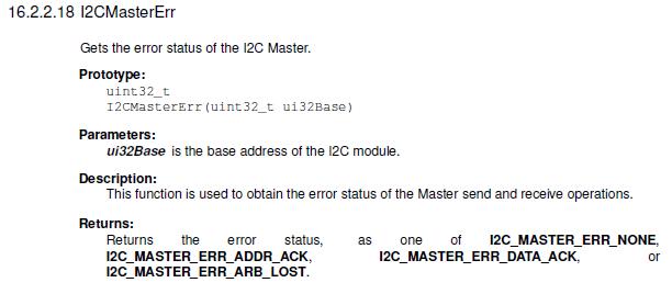

    Should you (really) desire to gain improved & more robust performance - should you not "Check for Errors?"      There is "no/zero" error checking - revealed anywhere - w/in your code!      Such was "hinted at" earlier - received only an (argumentative/thankless) response - in return.
    As suggested earlier - the newest API includes, "I2C error testing/checking."     A "reasonable" summary follows:
    And here is presented relevant detail - which expands - yet may not (fully) meet "all user" expectations:
