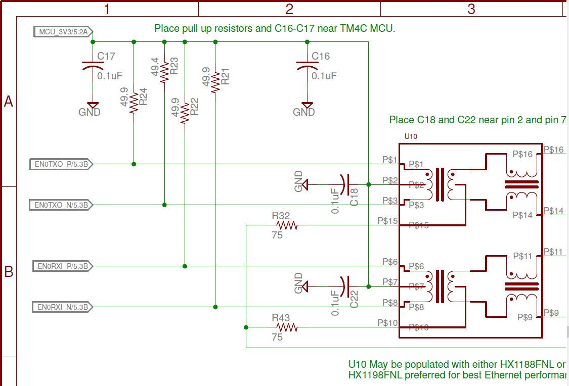

I have designed a custom board based on TM4C1294NCPDT. The board uses a integrated magnetics Ethernet connector interfaced with the MCU pins 53,54,56,57. Appropriate matching and filter circuit is connected per the MCU design guidelines. However, when I execute the tcpEcho sample code on my board, it does not get the dynamic IP address from my local DHCP server. However, the same code executes as required on the TM4C1294XL Launchpad.
I have double checked my schematic (attached herewith), the PCB layout and final manufactured PCB and have found no apparent issues.
I have used Wireshark to monitor DHCP request and acknowledge packets but see no activity on the LAN.
The rest of MCU functionality is working as required including debug messages on UART0.
I would appreciate if anybody could suggest solution or pointers to the issue

    Did you have 25MHz MOSC with less than +/- 50ppm tolerance? Please refer to the system design guideline on the pcb layout recommendation for Ethernet. www.ti.com/.../spma056.pdf
    I have used 25MHz MOSC with < +/-50ppm tolerance. I have referred to datasheet of TM4C1294NCPDT, Technical Brief and System Design Guidelines among other relevant documents from TI for the design. The LAN connector with magnetics is TRJ19111DNL from TRXCOM. The matching and filter components are within 1% tolerance and are placed within distance as specified in the design guideline documents.
    ETH0LED0 turns on (and turns off) when LAN cable is inserted (and removed) from the RJ45 socket. The ETH0LED1 blinks suggesting apparent packet movement. I have used Wireshark to monitor TCP/IP packets but no packets seem to leave the LAN connector.

    I had used LM3S8962 for my earlier Ethernet board and that had worked. The design guidelines for LM3S8962 Ethernet suggested that the ETH0RXIP and ETH0RXIM pins be grounded through 49.9 ohms resistors and a 0.01uF capacitor. Do you think this change needs to be done on my current TM4C1294NCPDT design?
    Thanks and regards,
    Hemant
  • Hi Hemant,
     The LM3 Ethernet is a complete different module compared to the TM4C129. As I noted earlier please reference the system guideline app note /TM4C129 datasheet/ TM4C1294XL LaunchPad schematic for TM4C129, definitely not the LM3.
     With that being said, I do also see 49.9 ohm resistor on the below LaunchPad schematic. However, it is 0.1uF on C16, not 0.01uF as you noted. Please also refer to the other post where Bob mentioned to check the chassis ground on your board.

    The launchpad gives the same error if it can't find a DHCP server. Use XGCONF to set a static IP and try pinging it. This will also fail if the hardware is botched.
    Hardware seem fine at a glance. The caps Charles referenced are just for decoupling.The built in magnetic RJ45 has a DC isolating cap so the ground connection Bob referenced is OK too, but I'm not sure how any large DC voltage potential would dissipate without a resistor in parallel. Maybe Trxcom knows something I don't.
    You should set a timer that verifies system clock is running at 120MHz as a way of checking the 25MHz osc.
