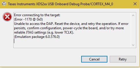

TM4C1237H6PGE: Error connecting to the target: (Error -1170 @ 0x0) Unable to access the DAP.
Part Number: TM4C1237H6PGE
Other Parts Discussed in Thread: SEGGER, UNIFLASH
Hi
I am in desperate need of assistance with launching the debugger on CCSv7 using an XDS200. I have made a custom board using the TM4C1237H6PGE. When I do the integrity test it is successful but when i launch the debugger i get the following error "Error connecting to the target: (Error -1170 @ 0x0) Unable to access the DAP.". I have built another board before using the TM4C1294 which worked on the first try. I have tried a different programmer checked connections thoroughly and tried a different PC with none solving the problem. Below I have added the Integrity test, the error that appears and my schematic.
Thanks for your assistance.

    Can you compare your current board (with TM4C1237 device) with the other working board (with TM4C1294) and see what is the difference?
    I will suggest you check the following.
    1. Check if TM4C device is under reset. Please check the Reset Pin and the VDDC pin. The former should be at 3.3V and the latter at 1.2V if VDD and VDDA are proper 3.3V
    2. Power up the board and check the TDO pin using a scope. Does it show a 15-20 Hz wave?
    As you can do proper scan on the scan chain, it leads me to believe you didn't have swapped JTAG pins. We can isolate this as a cause.
    Please also refer to to this app note section 3 on the JTAG interface. www.ti.com/.../spma075.pdf
  • And - if I may - might you add a pull-up R to TDI (pin 8 - your P2).     We note the use of 1K for pull-ups - that's bit too low in value, IMO.    (suggest 3K3-4K7 instead.)
    Connection into your P2 should be as short as possible.
    These guides have "recovered" multiple of our clients' boards - suffering as you report.    (and - while "blasphemy" here - your use of Segger's "J-Link" (a proven, superior JTAG/SWD Probe) often, "restores order!")
  • Thanks for the reply!
    I have not had any success i am still getting Error 1170!
    I have done all the recommendations that you have mentioned above.
    I have replaced all the pull up resistors with higher resistance.
    The TDO line has been tied to VCC with a pull up resistor.
    The VDDA and VDD are at a steady 3.3V with 0 to 40mV ripple.
    The VDDC line has a ripple of 1V and an avg of 1.5V.
    Comparing the 2 custom boards they are identical.
    I have even made 2 boards incase 1 was a defect and tried a bench power supply to eliminate the onboard powersupply

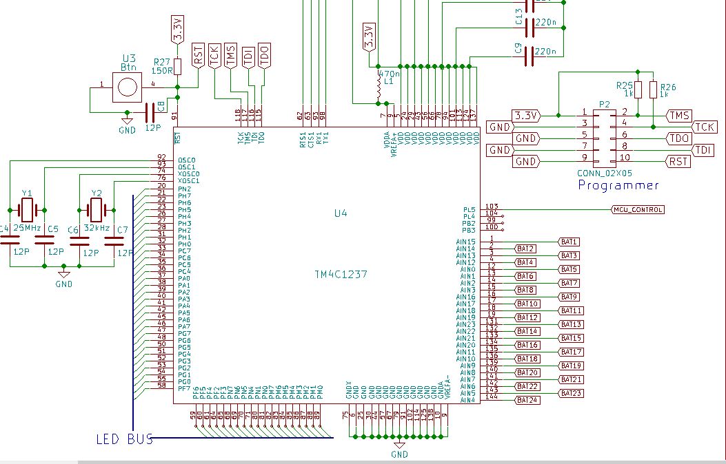

  • Pranav,
    Your VDDC line is definitely wrong. It suggests something wrong on your soldering, or even in your power circuit...
    The VDDA is also tricky, as you have an inductor and a trace going up to "unkown"... If VDDA is not ready when you power your MCU with VDDC, it will lock. In some designs, we actually use the VDDA signal as the enabler to the VDDC power switcher! Try to visualize the ramp up on both lines.
    Is there software in your MCU? Can you confirm it is running? If a temporary situation locked your device, you might need to unlock it using LMFlash.
    Bruno

  • Even after several viewing attempts - I cannot find,  "VDDC" on your schematic.      The capacitive treatment of that pin is critical - the MCU manual's specification MUST be followed.
    Is it not noteworthy that your,  "JTAG Probe"  reports  BOTH  Success and then FAILURE?     How can that be?
    Kindly scope the (past) WORKING board - ideally obrtaining a,  "Scope Cap" of VDDC.       Then - repeat that process on (both) of your (new) FAILING boards - and present both Scope Caps (of VDDC) - clearly identified/linked to each board.    (Good board  AND  Bad board "VDDC Scope Caps" (BOTH) - placed closely - one atop the other - same scope set-up/scales etc!)
    Your schematic - possibly due to "drawing ease" - reveals JUST 2 Caps upon VDD.     MANY such (lower value) caps ARE required - placed (at least) at  "every other"  VDD pin - and in close proximity to the MCU.    Have you - instead - employed just two caps - as your schematic suggests?
    The ripple voltage you report (1V - iirc)  FAR exceeds that upon ANY of our working boards.     (suggesting:  mismarked, under-valued, or failed Capacitor connections to MCU's VDDC pin!)
    STILL though - the "disputed & conflicting findings" of your tool ...  SCREAMS  "Tool as Amateur" - does it not?      Why is this fact avoided?     (such has been reported here - repeatedly - always DUCKED!)   "Avoidance does not qualify as a Solution!"
  • The schematic uploaded is the initial schematic, I have added the caps for the VDDC on to the board and I am now getting a stable 1.2V with a 150mV ripple.
    I also don't understand the success failure.
    The previous boards I spoke about have the TM4c1294 MCU.
    There are VDD caps close to all the VDD pins of the MCU when I took the screen shot they have been cut out.
    I have put the scope on all the JTAG pins of the board with the TM4C1294 (working board) and compared it to the board with the Tm4C1237 (not working) and have noticed that the TDO and TDI pins on the board that is not working don't show data transmission.

  • I have got it working.
    Removed all the caps from VDDC (leaving it unconnected).
    I needed to unlock the MCUs using Lmflasher and a lauchpad.
    All the MCUs that I received from TI seems locked is there a reason or is this a fault?
    Now I can flash using the XDS.
    Thanks for your replies.
