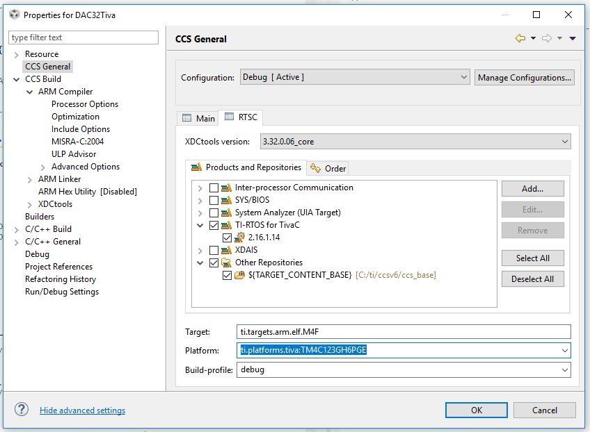

I'm starting development of a new project using the TM4C123GH6PGE and I want to use TIRTOS. So did Project/New CCS Project.
Now I come to try a compile and I get a Platform no longer supported message. A screen shot of my CCSv6 is attached.
Can anyone point me at what's wrong here please?
Richard

  • Hello Richard,
    The most common places settings are missed are in these locations:
    Project Properties -> Build -> ARM Compiler -> Advanced Options -> Predefined Symbols (Note: Predefined Symbols may be in the ARM Compiler list and not under Advanced Options, just look for it)
    Project Properties -> Build -> ARM Linker -> File Search Path
    I would check to see any difference with those sections.
    Honestly, the easiest way to solve this issue though is to take an existing TI-RTOS project and just empty out all the unneeded application files and add your own in their place. That way all the project settings will be retained.

    Just for completness I did eventually find the setting that was wrong!
    In CCS General RTSC tab at the bottom there is an entry called Platform. For some reason mine was set to ti.platforms.stellaris:TM4C123GH6PGE and it should have been ti.platforms.tiva:TM4C123GH6PGE! Screen shot attached in case it can help anyone else.
