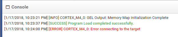

I have 50 boards with the TM4C1294NCPDT uP, running at 24MHz. On 10 boards the JTAG will not work, with same setup, if I plug the JTAG into a "good" board, same setup, same hardware, same session, it programs just fine. We did not put in the RBIAS resistor on any of the boards, again 40 will connect and program through the JTAG.
I am about to fab a production qty and have to get this resolved.

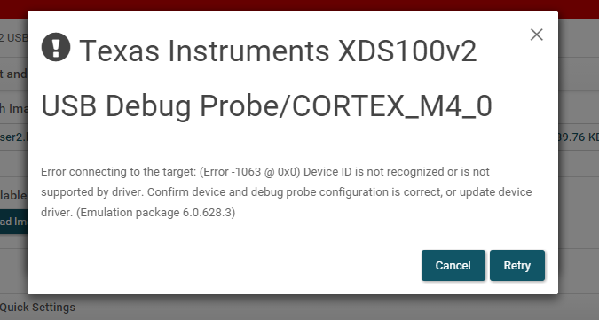

Output from Uniflash:
  • TM4C1294NCPDT: JTAG Error, error connecting to the target
  • Without the RBIAS resistor on the board, you will have problems connecting with JTAG. The boards that you were able to connect to, may have issues connecting in the future. The boards you have not been able to connect to are not damaged. Add an RBIAS resistor and you should be able to connect and program the flash on those boards. I strongly suggest adding the RBIAS resistor to all of your boards. A 4.7KOhm 10% tolerance resistor can be used in place of 4.87K Ohm 1% tolerance resistor if the Ethernet is not used.

    LMFlash just crashes with a "0" code, Uniflash puts up the notice above.

  • Well, I'm back with the results of my little R&R experiment.
    First, removing the OSC from the MCU and trying to program with just the JTAG did not work.
    From my engineer:
    Cannot program via JTAG - received error message “Error Connecting to Target” when programming via Code Composer.

  • Ran the JTAG integrity test on an MCU with no OSC or Crys. Weird.
    The test was a success?

    I can reset the MCU and that is successful.
    Right after a reset either the 100v2 or LP will program (it says so) successfully, even comes back with the correct checksum but the MCU does not reset.
    Then, with out touching a thing, run a verify and either programmer comes back with a failure.
    The below console crop shows the correct response then the failure:
    BTW, I have also had a couple of I2C ports go out on the same MCUs that began working with the crystal.
    And I don't think it is a full moon...
    And it won't until you click on the CPU icon in CCS debug tool bar or down arrow Reset CPU. If target jumped to Resume you have to click on the C_Int100 line then the toolbar will be available to select buttons. The red message is typical if the debug JTAG configuration is not checked to reset the CPU on program load or connection.

  • OK, the successful completion of the JTAG scan chain tests leads me to believe that it is not a marginality of the scan chain on the custom boards.
    Bob - recently (several times today, even) there have been reports of such,  "Successful completion of the JTAG scan test" - followed (almost immediately) by the dreaded,  "Failure to Connect!"
    Can both conditions prove true?     Might this (purported)  "successful completion"  prove  "overly optimistic - or simply wrong?"
    Should this,  (now known - tool reporting conflict)  not be an,  "Issue worth of (some) concern?"
